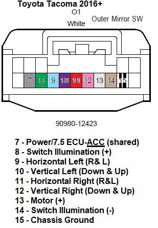

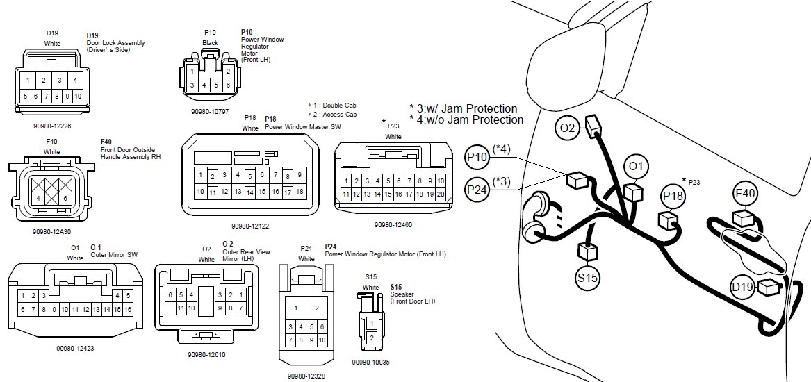

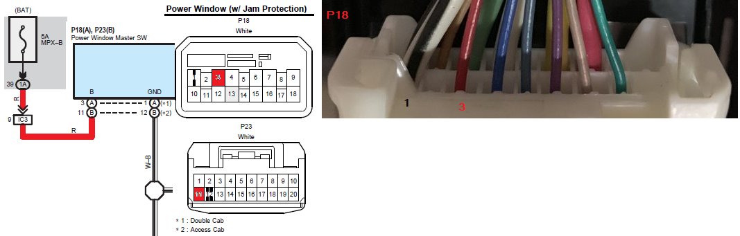

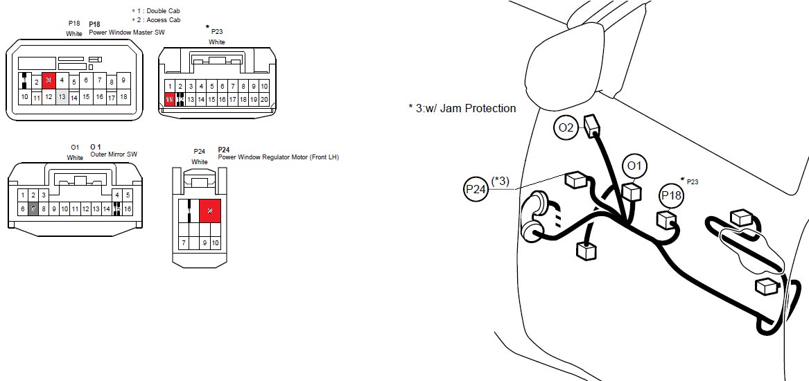

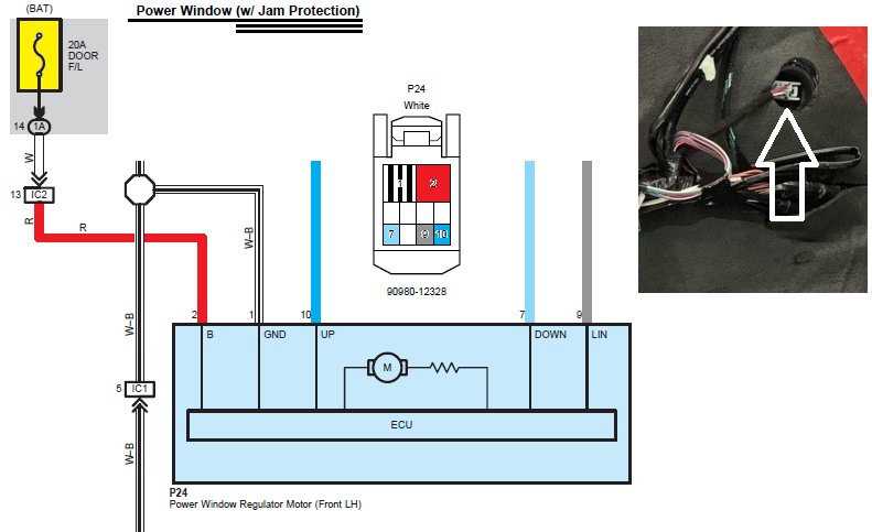

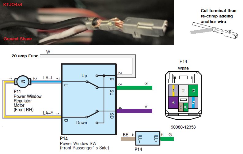

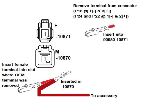

    For those adding puddle lamps, switch back turn signals, cameras, etc. needing power source near the install, here are a few choices without running wires to the cab fuse box or all the way to the engine fuse box.
    Connectors at the driver's door:
    Connectors with fused juice to parallel to.
    Details:
    Not much to vamp out but always hot.
    Only on vehicles with Power Window Jam Protection.

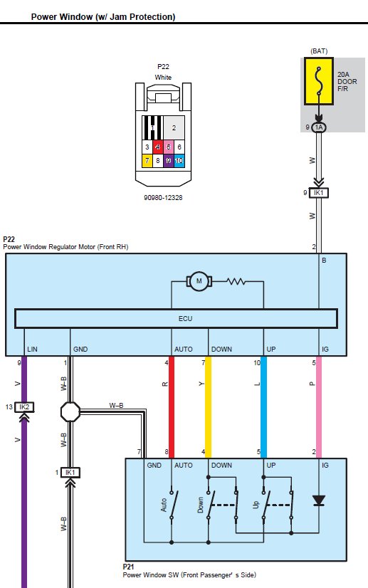

    Passenger's
    No Power Window Jam Protection...
    3M T taps, etc. or something like this...
    :rolleyes:@KTJO 4x4 could supply the crimped Y wires...:D
