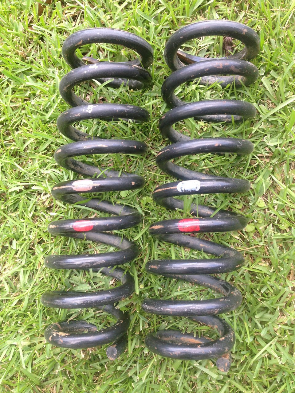

    does anyone know how to tell the difference in the drivers side coil spring compared to the passenger side coil? They have paint on them, but I can't remember which one was on what side.....

    Factoring coils are a different spring rate "driver vs passenger" if I am not mistaken to account for the "lean" caused by fuel tank, battery, etc... on the drivers side.

    Is it me or are those 2 colors the same ??...

    The left is a cream/darker color and the right looks more white
    Edit: the left may be faded "pink"

    I “think” red and white is drivers and red and pink is passengers

    I just measured my stock coils (they're off the strut) & 1 measured 13.5" the other is just under 14.5"
    Now the 64k question, is one longer than the other because it's "designed" to compensate for the Dr.side weight (batt. gas tank, etc: Or is it just a "worn out" DR. side that's lost some coil depth (the distance between coils)

    When I did coils on my '01, there was a right and left, as noted above. Same with the rear leafs: the higher arch went on the drivers side. That may work with your coil springs also, with the taller one on the driver's side.
    I followed those rules on my '03, and she sits perfectly level.

    The coil with the white/red might be a tad longer. I'm going to have to put a tape on it.
