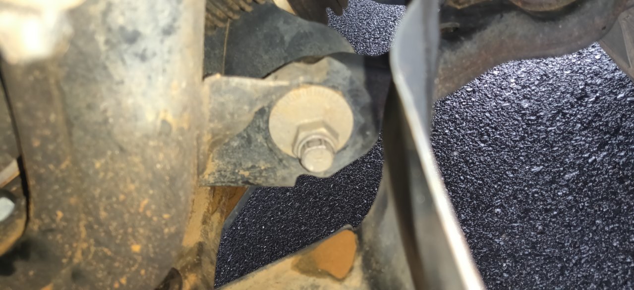

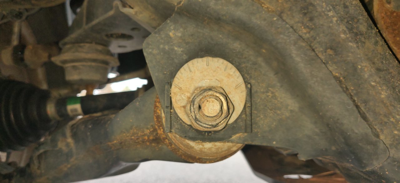

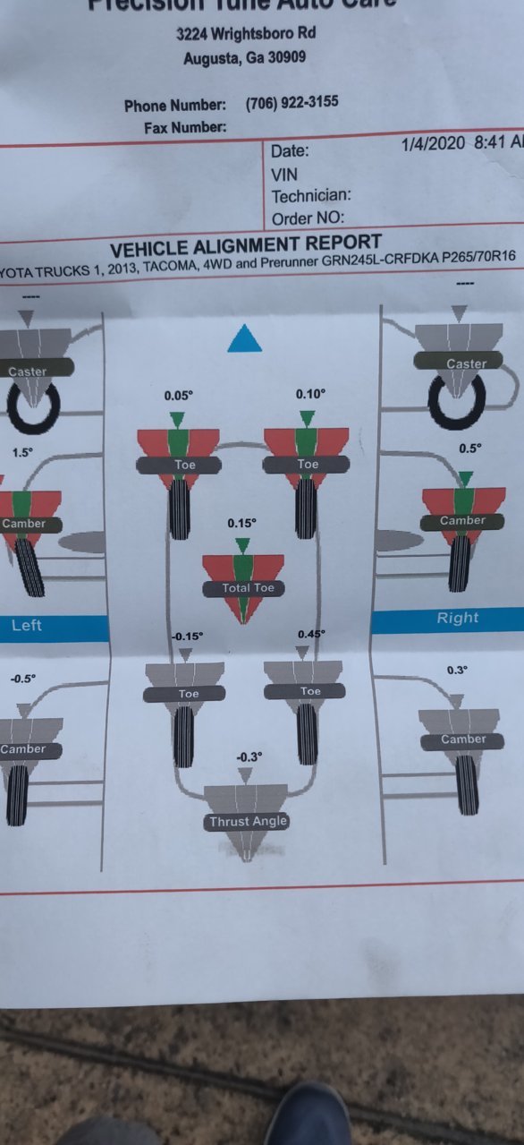

    So as the title states, my camber is maxed out on my drivers side front tire. Its sitting at 1.5 positive. The alignment shop said they think its just worn parts but didn't say what parts. Also said its not something to be too concerned about. I can definitely tell because of the wheel noise on my drivers side. I read a little on this from other peoples experience but im hoping someone can tell me what it could be.
    I took pictures of the eccentrics both front and rear of that wheel so if anyone could help itd be appreciated. Thanks

    1 1/2 degrees of camber is definitely something to worry about. Your cams are not maxed out. They are at the mid point. They “think it’s just worn parts”? If I inspect a front end, I can tell exactly what parts are worn/loose.

    Also, in your pic, there’s a “—“ above the caster pic. I’m gonna assume that means that they don’t even know how to check the caster.

    Just got off the phone with the Tech, he said (and I quote) "there is no camber adjustment on my Tacoma, not factory anyways"
    The Company is Precision Tune Auto Care, Augusta GA.

    Holy crap! That confirms that he’s a freakin idiot! Those 2 cams that you posted pics of are used to adjust caster and camber. Somebody needs to take a 1/2” torque wrench, beat him upside the head, rip his name badge off his uniform, and kick him in the ass in the general direction of the door.

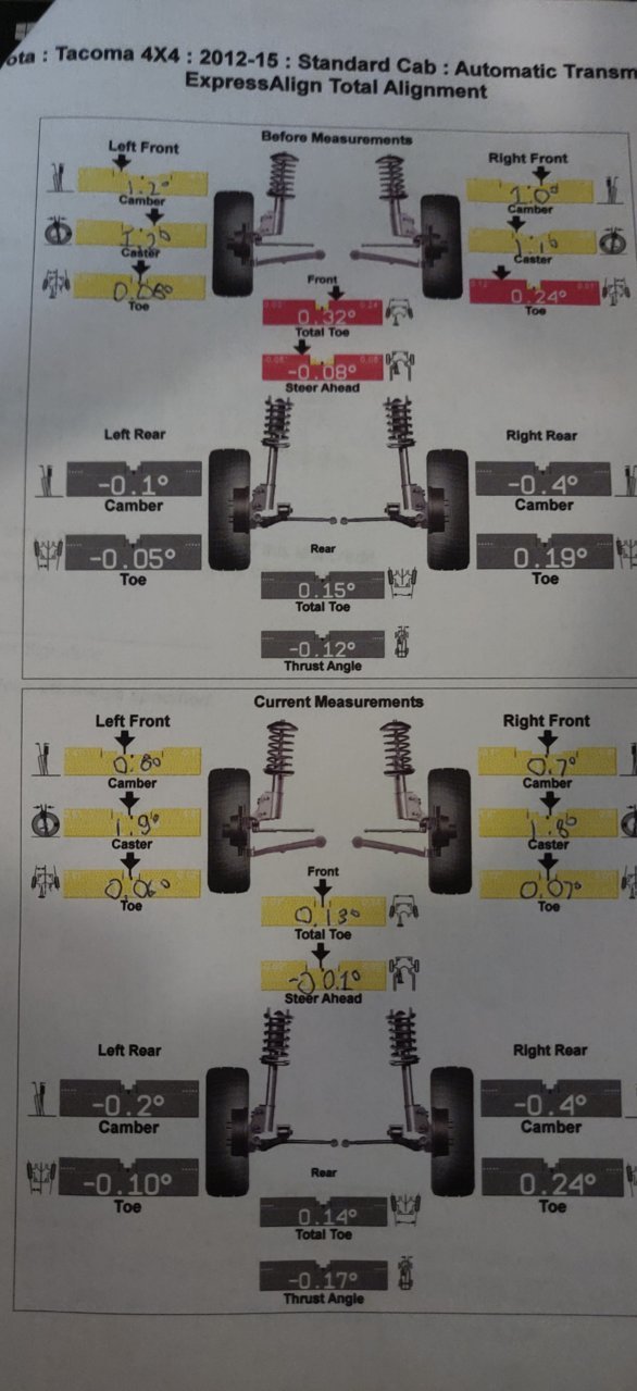

    Ok, I just got off the phone with Firestone, They checked it and said that both Cambers were over 1 and 1.3, but they said that the Toe on my passenger side was WAYYYYYY off and that it was pulling left because my toe on the passenger side. This should explain the wheel noise I hope. Its funny because the last company had it completely opposite. They are going to do the alignment now and it should be done shortly
    Also said that my camber bolts are extremely tight. which is weird, I put them to torque spec last night after raising my Lower Control Arms

    So, I have returned from Firestone These are my results. as you can see my Toe was WAYY off and my Wheel was also WAY OFF, and now everything is within tolerance. Problem im still having is the vibration around 35mph, and Sadly, It goes away when i turn on 4x4 meaning its my Differential. I put in the diff drop spacers when I did the lift install. Is there an easy way to fix this? Not looking forward to having to pay a bunch to fix it if i dont have to
