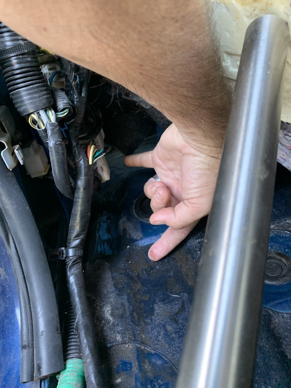

    ever figure it out? I've got it now and see wetness on the back carpet where my pinky finger is, at the bottom only. Water is pooling at my pointer finger area.
    Inside the engine bay water is coming out the pass through where wires pass through the firewall.

    i put a shit ton of silicone in the corner and in pass through and have not had a drop of water back inside my cab

    Been fighting this problem for quite a while. Please help me understand your pic. Where exactly did you caulk? I can't tell by your pic.

    I looks like all the white is silicone. A lot of silicone.

    I get that. But where did he cake it on exactly?

    I don’t know your truck, but that is exactly like mine. Drivers side. On firewall.

    Looks like the cable wire feed through on the drivers side of the firewall.
