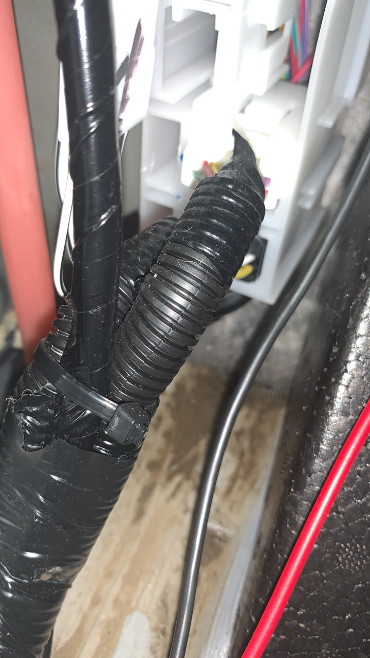

    see the white color stuff??? that is caulk my friend.....

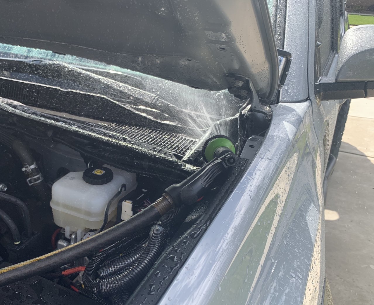

    exactly.... I also did the hose on roof thing to watch where H2O finds its way to and it sure was going into that wire harness pass through, and I also believe I had a leak in the wall/fender/corner joint... my floor would have water seep in at the bottom, never dripping or flowing visibly... so its a folded overlap of body metal, is my best guess.... and or the pass through....
    My floor has been dry since I applied what you see in my picture.

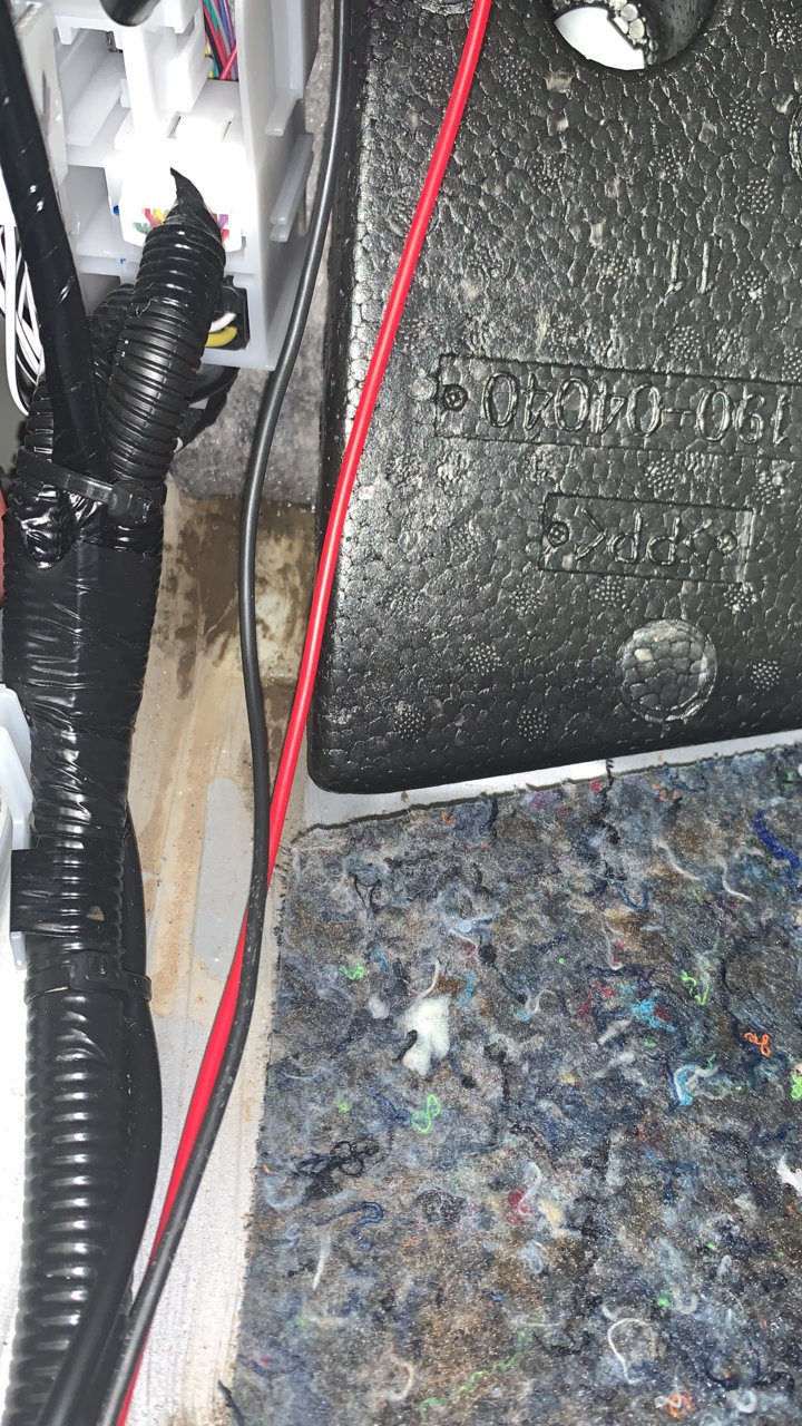

    After a week of no rain, I put a hose on the roof rack and windshield. I pulled up carpet, the smell from the padding was terrible. Looks like water is entering from the left of the black foot rest. There is mud there? Strange. The carpet is wet an inch up from the metal.
    anyone know what is behind the a carpet? How do I remove the black foot rest? The red hose on the left is dry....6044F3F9-46F4-4517-83C8-EE21F16FFA90.jpg 9C849EC6-2C4B-47FF-9D95-FAF8DF36E119.jpg 6A0B4A76-677B-4BBC-BD8F-FDEF154DCAB2.jpg

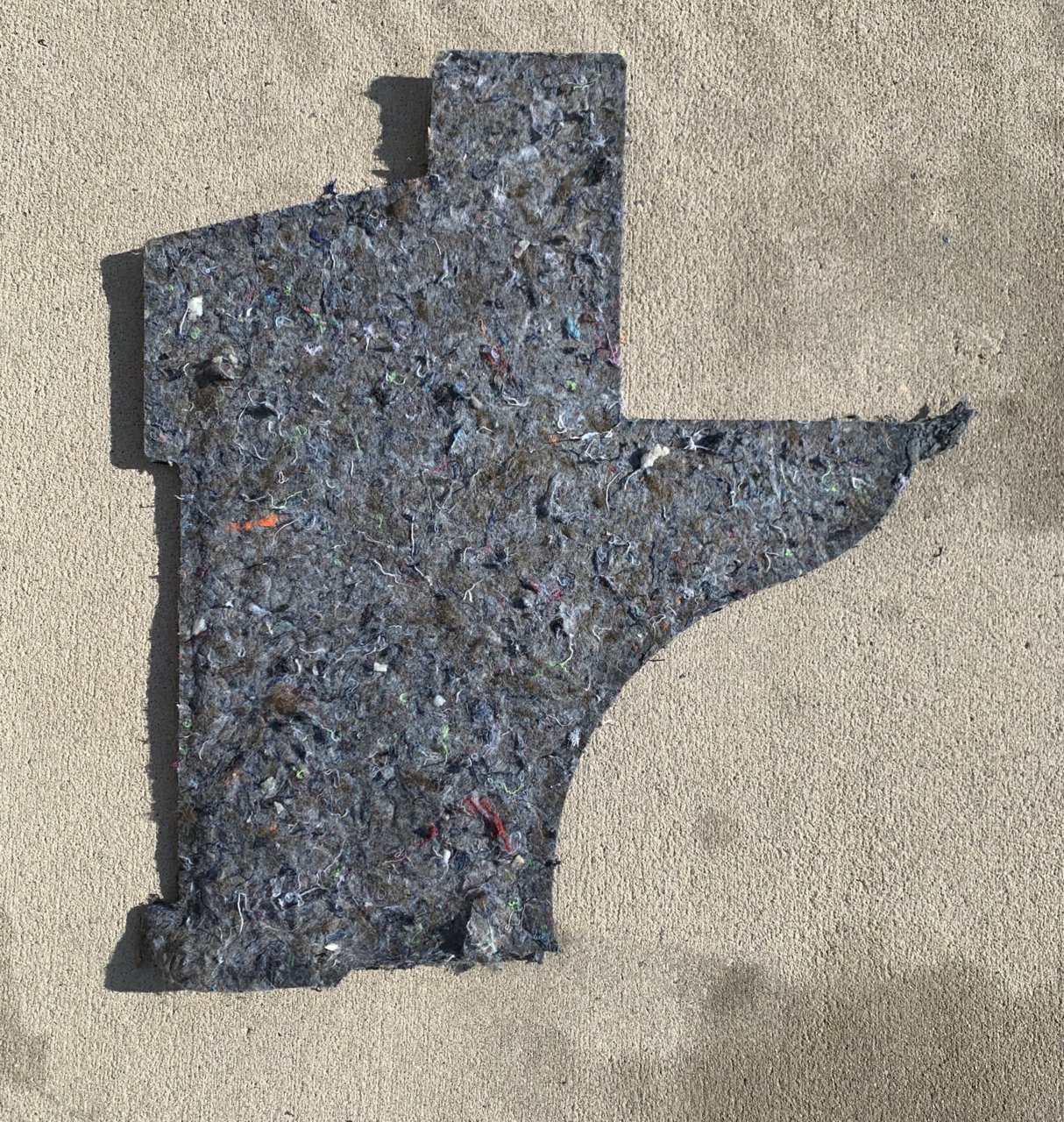

    I spray the pad down with bleach cleaner and rinsed, used shop vac to suck up and clean. It’s drying in the sun.

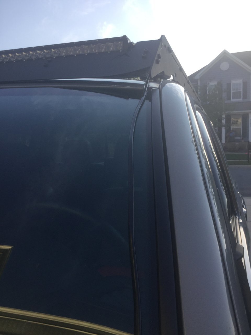

    I located the leak. Windshield seal broken. Looks like when I shoved the light bar power cable, I broke the seal. I went to Toyota and they gave me a new one under warranty. They said it is common, they break off in the car wash and sometimes leaks and sometimes doesn’t. I have resealed it with the black stuff silicone and the new strip with 3M tape.

    So i did the water hose leak test didn’t see anything..
