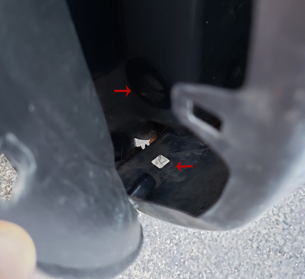

    I just fixed this on my 2009. The driver's side floorboard was wet. I removed the carpet and got the hose out. Water was entering though the corner by the driver's left foot rest area. It wasn't the windshield or the heater core as my mechanic had suggested. It was entering through the wheel well.
    Carefully remove the pins (watch a video first or you could break them) holding on the driver's side wheel well liner and pull it back. I found a handful of leaves, pieces of twigs etc. in there clogging the little square drain hole. When driving in the rain, it would fill and water would enter through the black grommet just above the drain hole. I broke a couple of those clips but the dealer gave me a few. Hope this helps.fix.jpg
