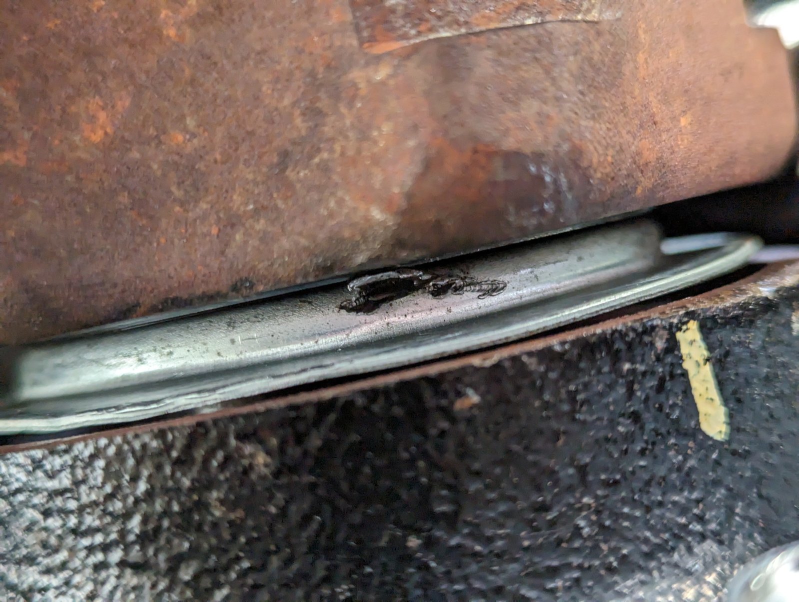

    I recently did the ecgs solid bearing replacement, i did replace the axle seal while i was in there but there is now a leak. There is a hole in the inner cv dust shield, can it even leak from there?

    Thats not the cv, thats the gear oil from the diff

    CVC is grease, not oil. Did you pre-lube the seal before the axel install?

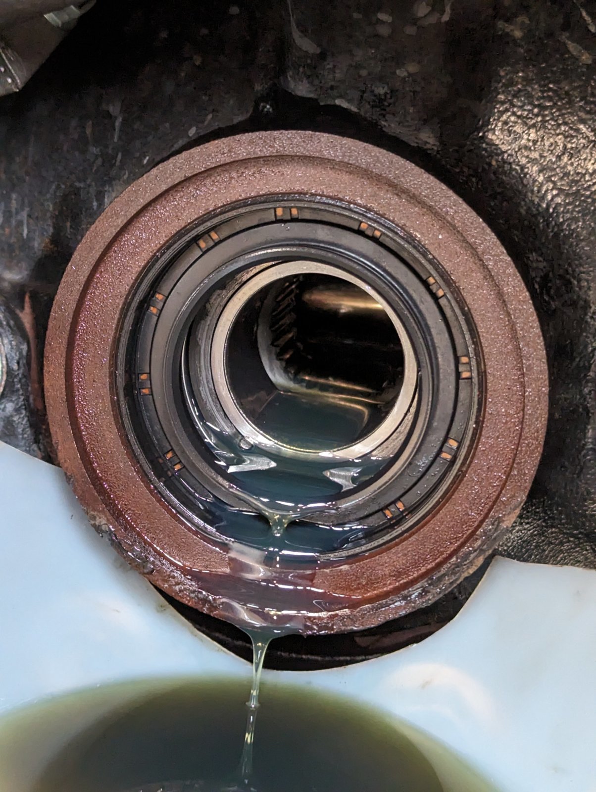

    Sorry, its leaking gear oil from the diff. I lubed it up with gear oil before inserting.

    Well turns out if you install the seal backwards it doesn't seal.
