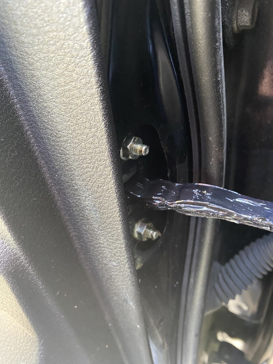

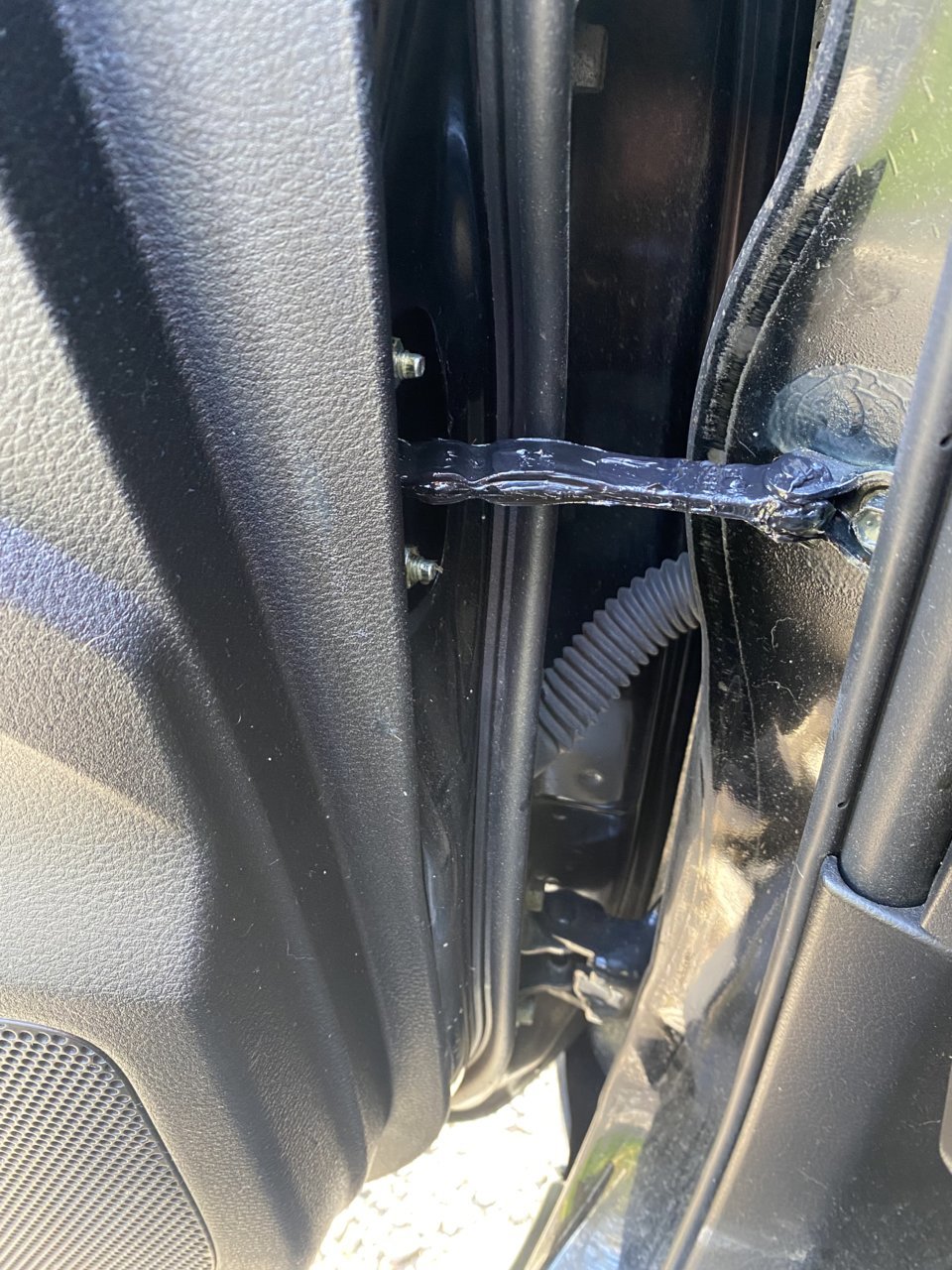

    These 2 gold colored nuts were very loose. Tightening corrected the issue.
