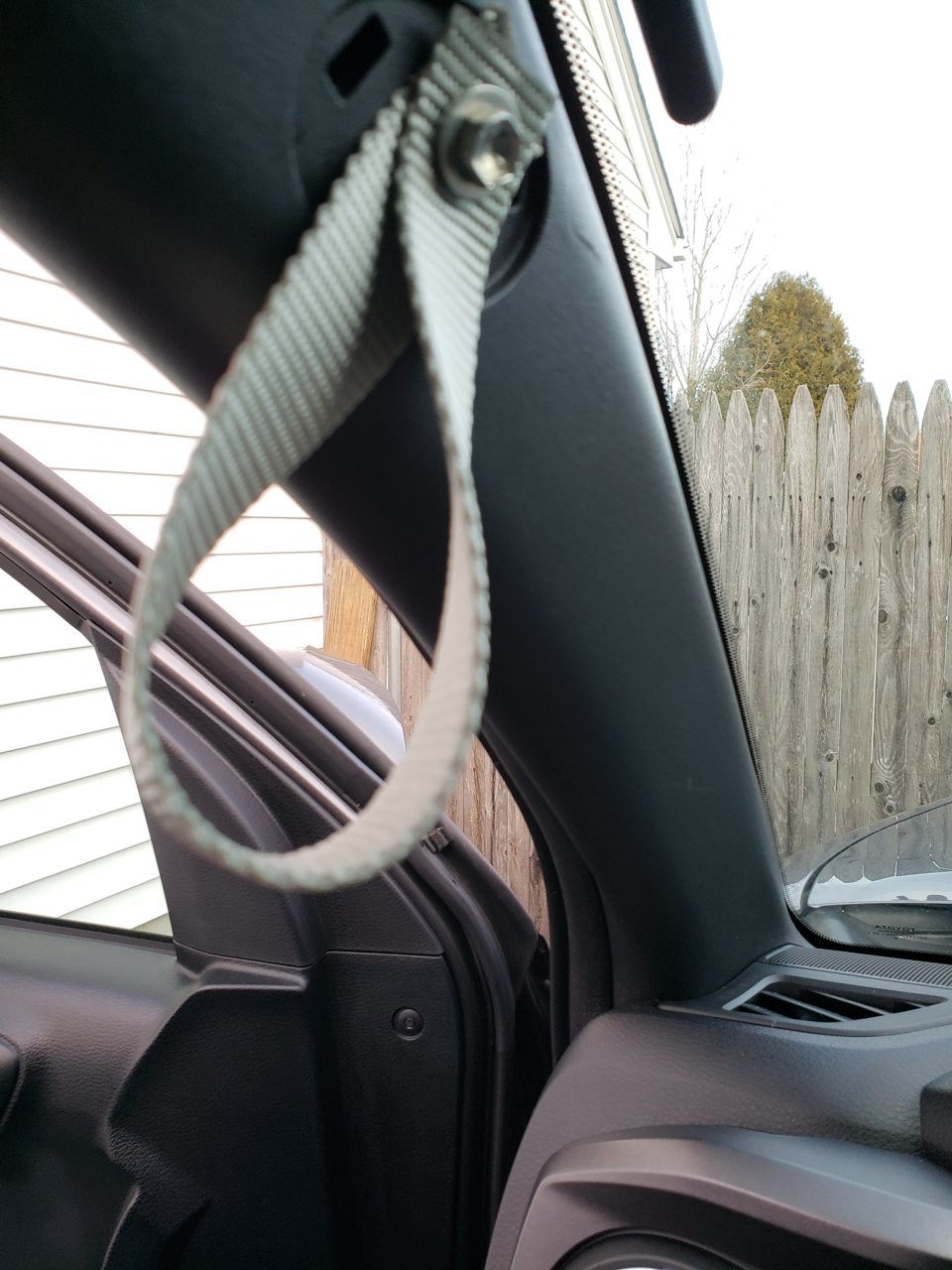

    There was a discussion in another thread about the lack of a grab handle in the 3rd gens. I couldn't locate that thread so here is what I came up with.
    I bought a Porsche RS style door strap on Etsy ($13.00 for 2), removed the A pillar bolt cover and bolt, slid the strap over the bolt with two washers under it and tightened it.
    It doesn't get in the way or block my vision.
