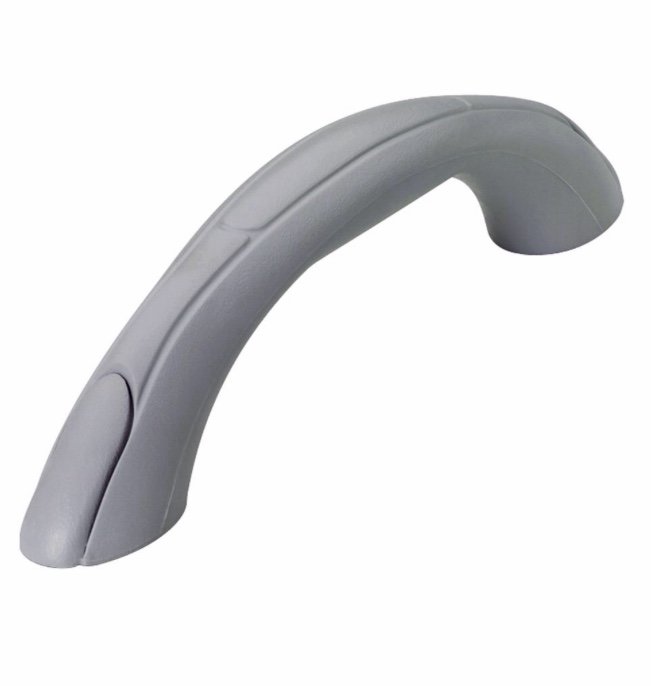

    For me, I wouldn't mind if it were lower profile. I was thinking about finding a color matched handle with the same bolt spacing. This is $10 at Home Depot:
    Does anyone know the distance between the bolts?

    I believe it is the same as on the passenger side, but you need to install a rivnut on the lower left side. The pillar trim comes out very easily, just the one 10mm bolt under the SRS label.
