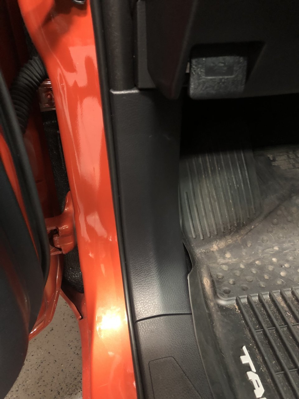

    For the life of me, I cannot get the kick panel back on. Can someone take a picture of the kick panel back on so I can see where the weather strip suppose to lay? thanks in advance.
    Ps I was installing the glass break sensor for the factory alarm.

    Can you look at the opposite side and match the install? It's kind of a pain, but once you get everything lined up, you'll know.

    I did but there is an additional lip on drivers side

    Ah.... tricky bastard. I’ve had mine off a few times and it’s the little white pins that bite you in the arse. You need to get those positioned right in their track first. Panel goes over the weather strip. I’ll take a pic when I get home but it’ll be an hour.

    Here you go.

    This post helped a lot !!! What a tricky bastard ! Make sure the white pins are pointed towards the engine not the cab.
