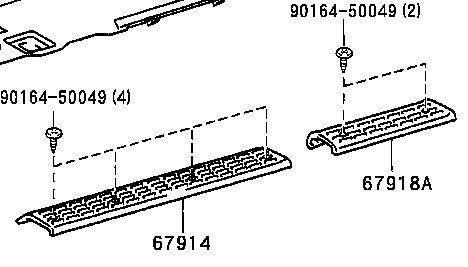

    I noticed the scuff plate sticking up a little so I thought I would tighten it up, but the screw just turns. I even tried pressing down and tightening but nothing. Below is the only pic I can find but it doesn't really show what it's screwing into.
    Any help or ideas??

    Yeah, mine are that way too. If you remove the scuff plate, you'll see those screws just screw into plastic and they get stripped out easily.

    I don't think it's the scuff plate itself that's the issue. I thought that at first myself, but as stated above, it screws into plastic below the scuff plate. Not sure if that's replaceable or not.

    I have a 1998 TRD and I don't know if the scuff plates are the same as on your model.
    On mine, the front screw in my driver's side scuff plate will not tighten. The reason is the scuff plate has a piece that is molded into the underside of the plate. It is about 1/2 to 1/2 inch square and maybe an inch long. It fits down into the square hole. The piece is split by design. A screw goes into the top and down into this molded piece and spreads it apart, thus securing the plate to the body. Well, that piece on my scuff plate broke long ago. Fortunately, the other pieces are still intact so the scuff plate is loose only at the front.
    I hadn't thought of using epoxy to fill the hole and drilling a hole into it to secure the screw. I'll have to try that sometime. Either that or some kind of nutwasher that will fit in there and that I can epoxy in place.

    purdy much the same deal ^
    Sometimes the insert prongs can break off the scuff plate...
    and the screw will just spin and offer no thread bite.
    Possibly you can get an "stand alone" expanding prong type insert
    then cut/grind off the prong (tab) attached to the the scuff plate.
    Push the new insert in flush, into the threshold's hole
    then screw thru the scuff plate into the new insert.
    I believe those inserts have a square(ish) look to them
    so they do not turn when the screw is tightened.
    Purdy sure they can be found at most auto parts stores.
