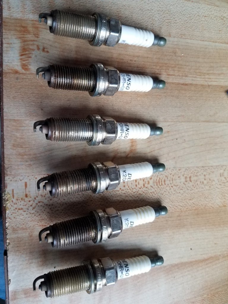

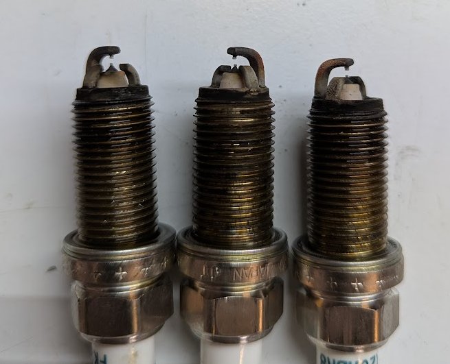

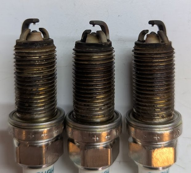

    Just thought I'd share these photo's. The whole job took longer than I thought, really tight spaces in the left bank. I found it odd the drivers side was so much more worn out. Any thoughts?
    2017 Taco Sport with 154,000 kilomooses on it. First plug change, I should have done them at 100k.

    Interesting. The iridium tips are gone on the one set of 3. Haven't seen that yet.
    Did it run better after?
    You had 96k miles. I've been changing at 80k miles twice now and see nothing close to that.

    I can't begin to say what it might be, but something is amiss here.
    IIRC, I changed my iridiums @ 120K (miles) and all six looked like they could have gone another 80K.
    I believe @bigoldbeef has over 410K on his truck, having only changed the plugs twice. Once @ 200K, and a second time @400K.
    Again, miles, not kilometers.
    He has contradicted himself with the numbers from one post to the next, but nonetheless, 400K+ with 2 plug swaps somewhere in between.

    OP's 1st post says original owner, FIRST plug change.
    Either way, @ 95K, the three bad plugs should look like the three good plugs.

    Something's not right, and depending on what the problem is, it may not limit itself to the plugs.
    The plug coloration looks fine, but if it were my truck, I'd at the very least be looking for answers.
    Those plugs look like what I'd expect to see at 200K (miles)

    Is it possible that the iridium tip is actually more of a rod than a triangle/dome, and the other part just melted?
  20. Mar 11, 2025 at 7:53 AM
    #20
    jmneill
    jmneill Well-Known Member
    Jul 28, 2018
    #260876
    3,264
    SE
    2018 Tacoma Sport ACC CB Inferno
    No, the iridium tip is exactly that. It's just the tip that's welded to the core, and it's gone from from these three plugs.
    It's not a rod or dome, just the itty bitty tiny, and this case, missing tip.
    If these weren't the original plugs, I'd have bet my left nut against a dollar, those three were ebay iridium fakes.
