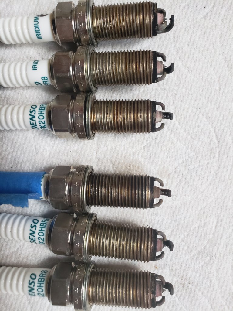

    I'm not seeing one side worse than the other. And not really sure why people think changing plugs so frequently is such a big deal.

    One pic shows the plugs with the iridium tips MIA, the other with three tips intact.
    Might be time for a new set of readers.

    Look for yourself..
    The bottom row electrodes are completely gone.
    I agree, most likely is somebody did the easy bank and then chickened out on the drivers side

    I already confirmed this was not the case. I'm the original owner, this is the first time the plugs were touched. I'm wondering if there is a fueling issue, but not sure a dealer could pick up on that if they hooked up a computer.

    X2 on the gap. I think there are at least two in this thread pecking away at braille keyboards.
    As to the plugs, OP has twice stated he's the original owner, and this is the first plug swap.
    You wouldn't forget doing a set yourself, and you wouldn't forget having them done, due to the associated cost.
    Edit to note: I've said it earlier in the thread, and I'll say it again.
    I changed out my original iridium plugs @ 120K~ and they were in nearly new condition.
    Even if the OP has lost his mind and had one bank done, something would still be amiss here with these plugs in this condition @95K miles.

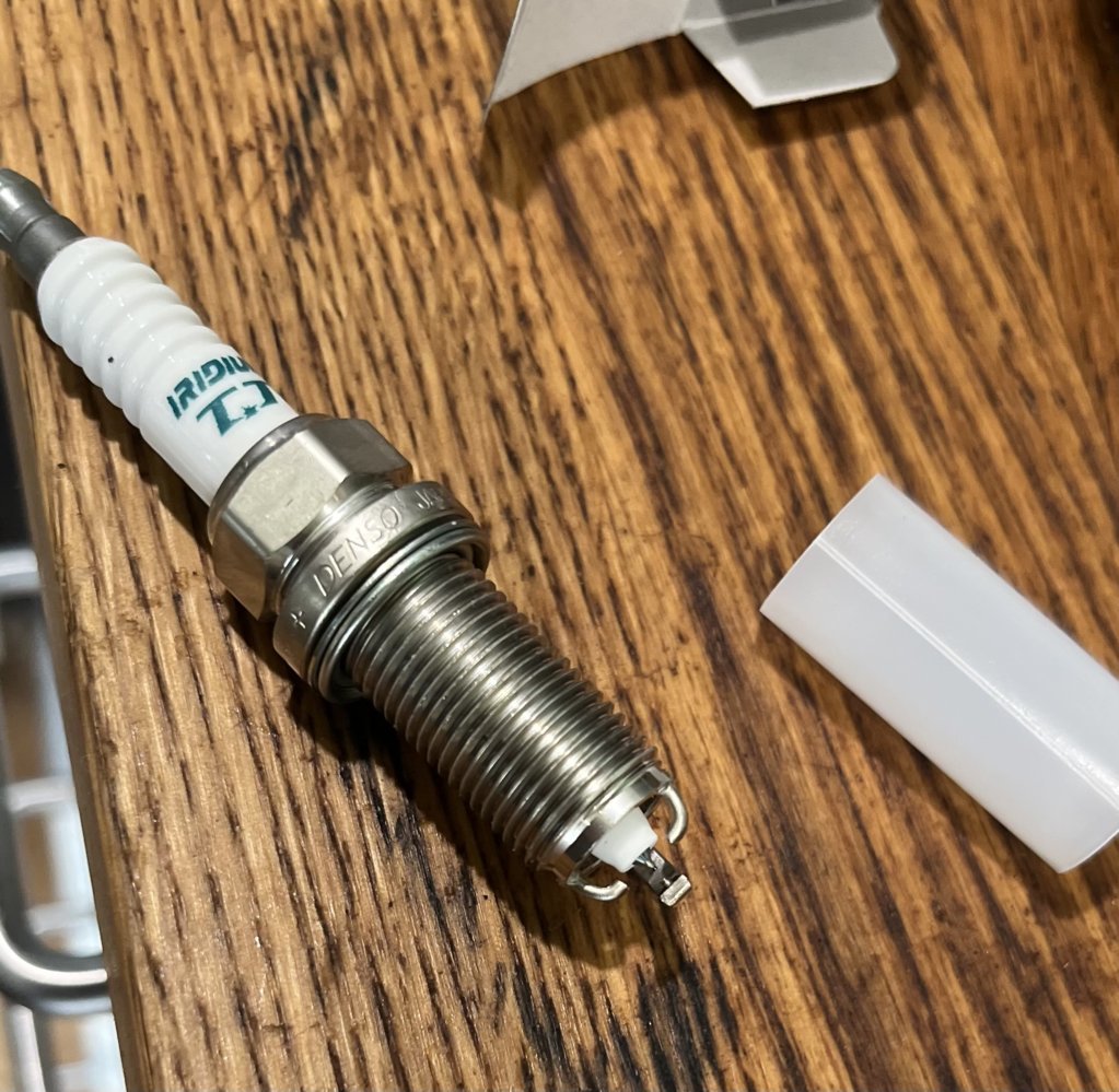

    I hadn’t realized that the rod portion had melted down, but I actually thought the new plugs were more of a dome shape. Idk. Time change?
    Here’s my new plug yet to go in…

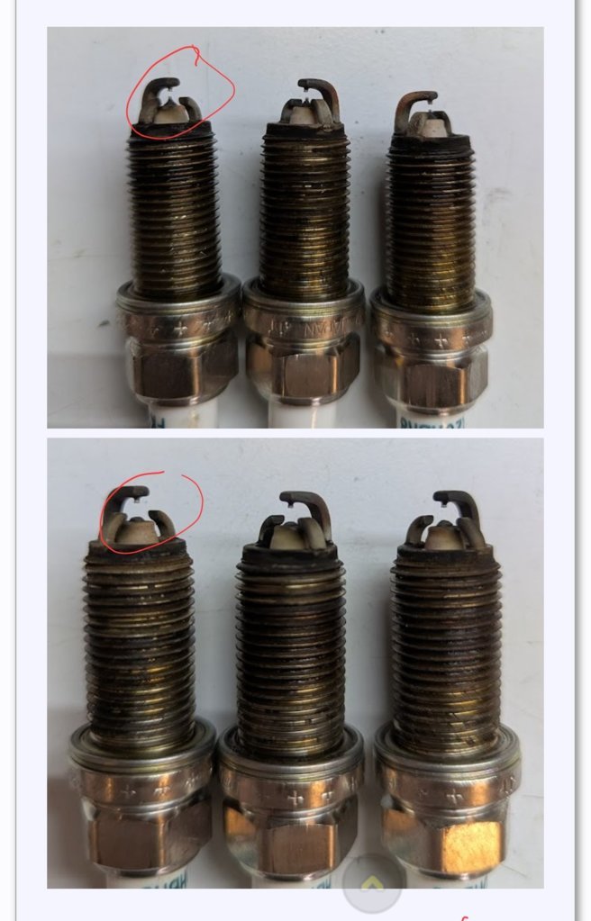

    If you read some of the tuning threads, there are mentionings of lean conditions on bank2 due to the fuel rail design.
    However, I don't see the lean conditions it on my truck. My both banks are the same.
    Probably worth a try to look at obdII
    data.
    Here ate my plugs.Top 3 are bank2. Replaced at 71-72k.

    If for some reason you have to go to the dealer show them the pic's

    Same initial thought I had here as stated in a previous post: Counterfeit parts: First thought that came to me seeing the pic for those three. But it doesn't fit the narrative, as from reading here it seems that these were the original OEM plugs from the factory.
