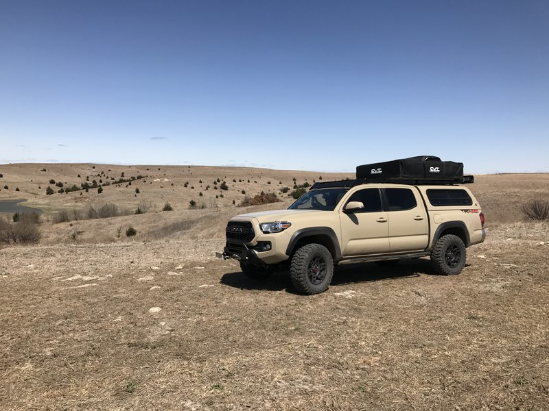

    I bought my 2017 Quicksand Tacoma back in Nov of 2016. It was brand new. I have done considerable amount of work to the vehicle to get it where I need and want it.
    The truck has had a Leer cap, Prinsu racks, Icon stage 4 suspension, Dakar springs, Southern Off-road Style Hybrid Bumper, Smittybilt Winch synthetic line, TRD T4R wheels, and Copper STT Pro wheels put on since purchasing the truck.
    I noticed around 1800 miles there was a thud or clunk occasionally when turning into my drive. I had the truck re aligned and the noise didn't seem as bad. My thought being the tires were rubbing from not enough caster.
    After a 2.5 hour trip there and back I began to be more observant of the noise and slight thuds. When I got home I attempted to manipulate the tire in the 3&9 position believing it was still an alignment problem and the tie rods could be the culprit.
    To my surprise the wheel had significant movement with the truck still being on the ground. I jacked up the front and I manipulated the wheel at the 12&6 positions and also had significant movement.
    I then believed my new 3600 mile Tacoma had wheel bearing issue. I removed the axle but and attempted to see if anything was misaligned. Reinstalled with same problem. My truck is under warranty. So I new I would take it to Toyota for warranty repair.
    Now I have had zero issues with my third gen. My truck has only seen dirt and wash board roads. The truck has not been in any accidents or hard struck any objects. I am very concerned to have a wheel bearing going bad with so little mileage and light driving done with the truck.
    Any suggestions would be greatly appreciated.

    I don't have any useful advice but your truck looks good :thumbsup:
