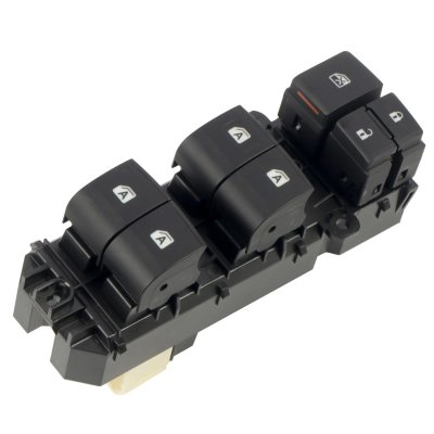

    I have a really nice '22 DCLB 4x4 SR5. I have the power seat, power mirrors, and power windows. But I was surprised my truck doesn't have an 'auto UP' feature for the driver's window.
    I saw some posts with a replacement switch, but I guess I'm wondering if the '22 should have it already, or was it something that only came on trim levels higher than SR5?

    I don’t mean this to sound condescending, but is the switch labeled with an “A”? If not, your truck doesn’t have the feature and you need an aftermarket switch. I think KJTO makes some but a lot of people around here have beef with that company because of some old drama.
    If your switches (both front windows) are labeled “A” and simply aren’t working, google the reset procedure. It’s like; hold a switch down for a long time and then up for a long time or something like that

    Never even looked at the switches, just noticed the “A” , thanks.
    For the OP, Techstream has some settings for the windows, don’t remember what the settings were, but perhaps a past owner had some “Customization” done.

    This ^
    I put one of those in a while back. It should have come with it. Such a nice feature. Easy plug and play replacement too. Don't think about, just buy it, ha.

    I also installed that all auto up window switch. And yes it is a very nice feature, only downside is on mine the rear passenger button brightness is dim compared to the rest.

    Maybe I'm clueless on the meaning of the ''up'' in what auto up really means. My sr5 has the single ''A'' button the Pro both driver and passenger ''A'' buttons. But the trucks don’t do auto up they do auto down. What am I missing here?

    Google and try the reset procedure

    Yes, my driver's window is labeled with the 'A'. I'll try the reset procedure tonight after I get home from work. Hopefully that will fix it!
