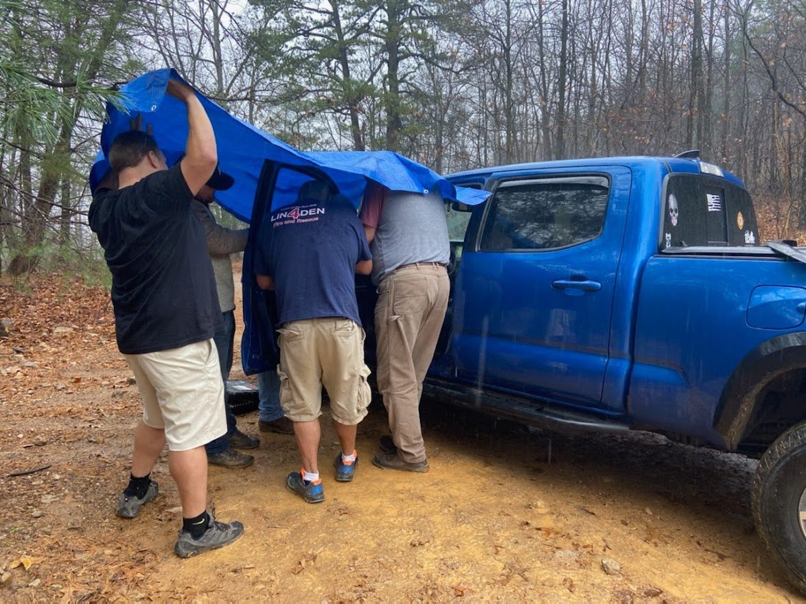

    Has anyone ever heard of or experienced a window track failure on their 3rd generation due to the front door side window regulator bolt having been vibrated loose from off roading? Truck has 14K on it, is 2 years old built in Jan 2018 and the door panel was never removed.
    Had a hard time removing the electrical connector block for the window switches as well. What is the trick in removing that? How does the release work?
    While removing the door panel on the trail the 10mm bolt from the front track of the window regulator had vibrated itself loose as it fell out.
    Ended up accidentally putting the window down again after the fix during the rain and it popped out again. Need a dry day to check it out but I assume it also won't under warranty since the truck is older than 2 years.
    Anyone have any insight?

    Had to pull the interior moisture door guard so the seal is disturbed and will be noticed. No clue what the warranty is; if its 3years I might get lucky.
    It was pouring rain so window had to be put back together and in line.

    Apparently Toyota has that issue now as well. Especially since the truck gets barely driven; pretty sure the tech will figure out that this rig gets taken offroad plenty of times also: pinstripes, mobtown skid plate with trail scars, mudd in places only the doctor would look etc.. So offroad or not that thing vibrated loose while driving during a monsoon storm sadly.
    At least I had preplanned by having a tarp in the bed of the truck.

    That funny click might be the front track bolt being loose. Didn't recall hearing anything click but the truck sits mostly and even had a dead battery some weeks ago. Didn't take any pics as it was pouring down when we found the bolt had dropped after removing the lower panel clips.
