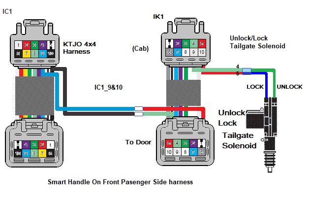

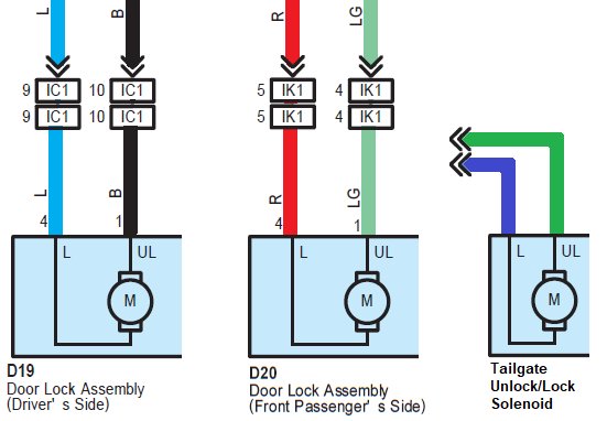

    For those wanting to have front passenger's door unlock at same time as Driver's door.
    Revised manner, avoids any electrical gremlins...
    P.S. Think of it as you'd install the TAILGATE unlock/lock solenoid.

    Wait can't you do this through the headunit?

    Dunno, can you? It's driver's or all doors unlock on first click in Head Unit settings.

    My bad I miss understood passenger's door as all doors not just the front two

    Carista enables this setting.

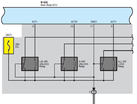

    Unless Carista is a physical thing, there's no magic switch to tell the Head Unit only the Driver's and Front Passenger's door and not the both rear passenger doors...
    D-DR UNLOCK = Driver's Door
    L/D-DR = All other doors
    ALL DR LOCK = ALL doors LOCK
    STrooper likes this.

    On my 19 you can change in Settings

    Change only front doors unlock...do show

    It can't tell the MBECU just unlock driver's and front passenger's door and not the rear passenger doors (rear left & right)

    Totally awesome. I’ve been longing to make this happen. I find the all settings just too much and the driver only a pia big time. I wish I could do just driver side so my dog didn’t need to be on all fours etc. thanks

    OP, I have to say, your first post was unclear. I read it as all doors unlocking (passengers can also ride in the back). For me, it is a non-issue, as I want the back doors to unlock as well.
