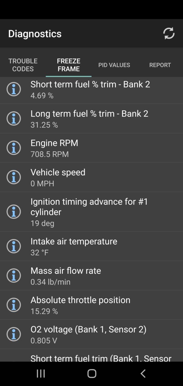

    I replaced the driver side up stream sensor and an still getting the same code.
    I assume I'm should replace the drive side down stream next?

    Oh, my bad.... Thought I posted it...
    The code is P0174 System to lean

    I have heard that the freeze frame data can help... Next time it goes off I'll screen shot the info and post it. Can the dealer get more info off their scanners then a simple app? I use OBD Fusion

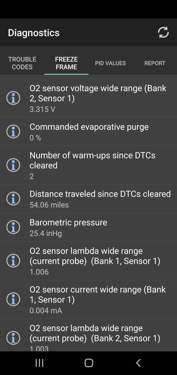

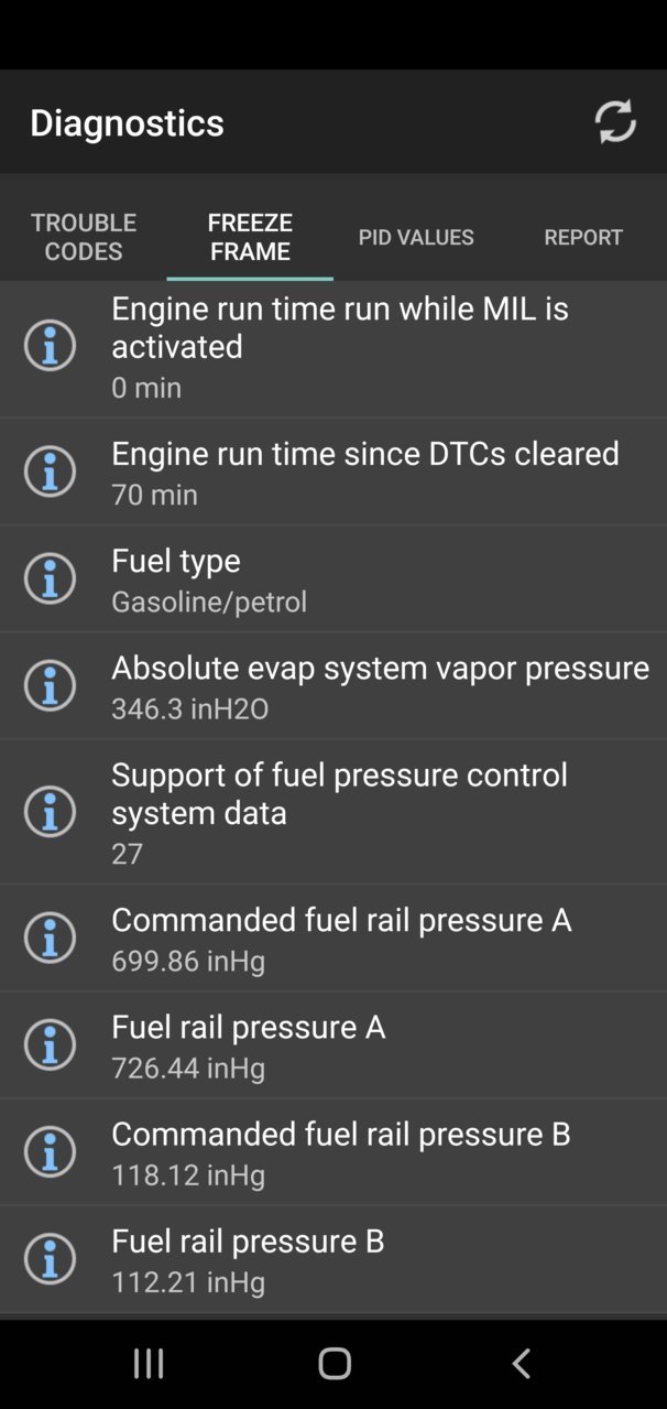

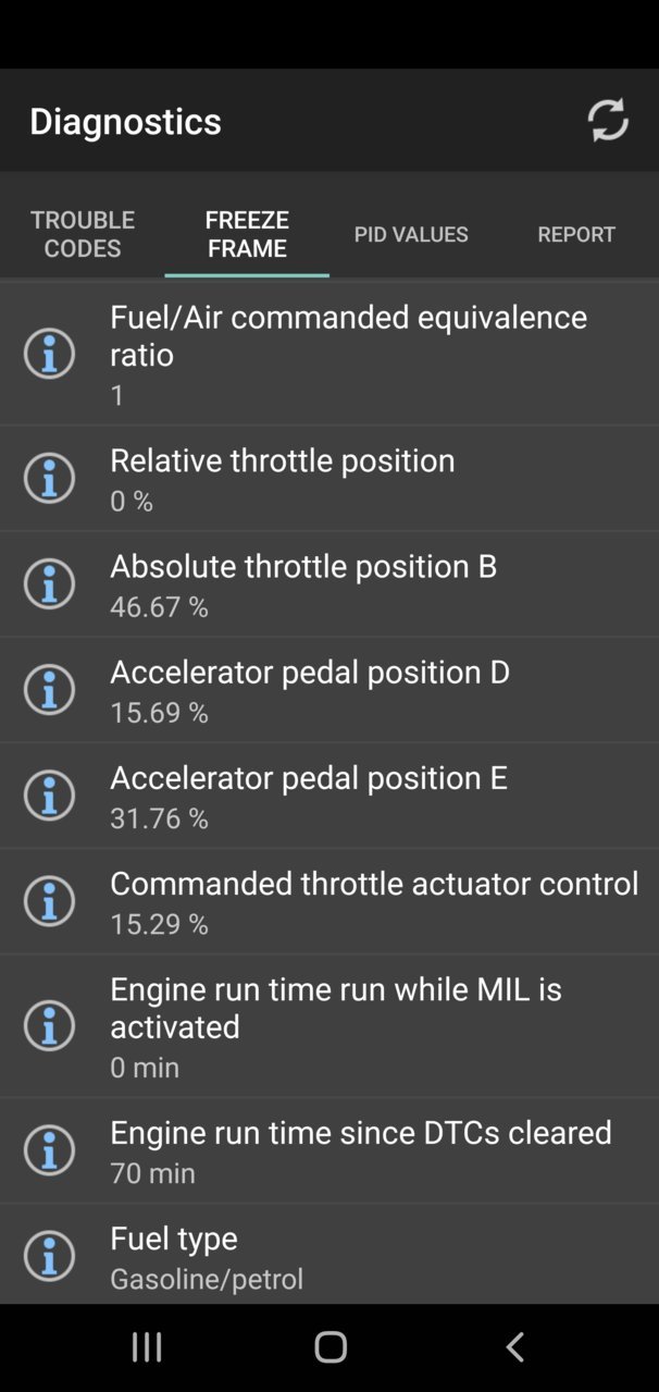

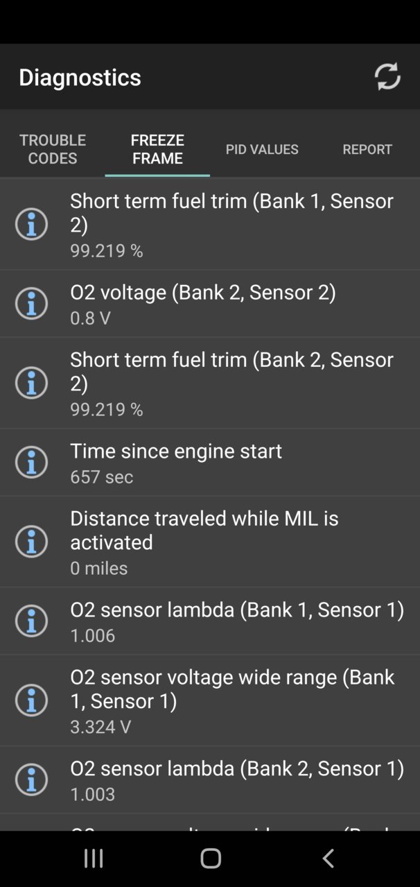

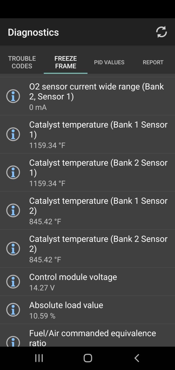

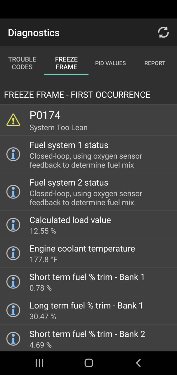

  17. Nov 30, 2022 at 5:53 AM
    #17
    JDKred
    JDKred [OP] Well-Known Member
    Nov 30, 2020
    #348298
    593
    JD
    16 MT KDMax Tuned
  18. Nov 30, 2022 at 6:07 AM
    #18
    Bishop84
    Bishop84 Well-Known Member
    Dec 17, 2015
    #172494
    12,019
    Both banks are lean, very lean.
    Not sure why it’s not calling bank 1 p0171 as well.
    this could be fuel pressure, maf, vacuum, purge valve, etc.
    You want the fuel trim below 10% long term.
    JDKred[OP] likes this.
