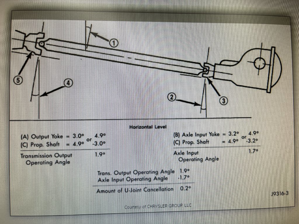

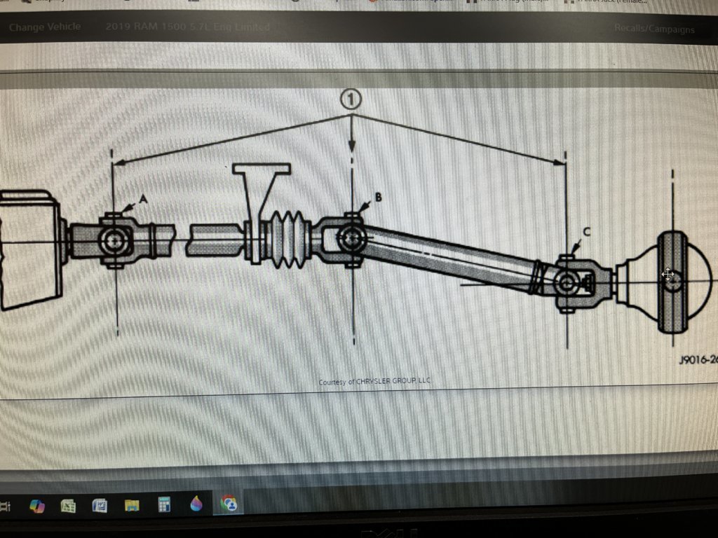

    See if this helps you.
    baltimorebirds2[OP] likes this.

    Hmm. Let me add that, I’ll show how I arrived at that

    TRD Pro 17” Wheels, Toyo Open Country AT3 33s” (255/80/R17), Hooke Road Offroad Roof Rack, LEDs (Low Beams, High Beams, Fog Lights, Interior Lights, Reverse Lights, License Plate Lights), Diode Dynamics SS3 Sport Fog Lights (Yellow), Sequential Turn Signals, OME Nitrocharger Plus, OME 4004's & HS 0.5 Spacer for 3" Lift, JBA UCA, Icon RXT Option 2 Leaf Springs 2.25" Lift, Yukon Clamshell Bushing, Alpine ILX W-650 Stereo, Infinity Primus 6004a Amplifier (140w*2), Sound Ordnance M75-4 Amplifier (75w*4), Infinity Kappa 693C Component 6x9 Speakers, Infinity Kappa 63XF 6.5 Speakers, TRD Shift Knob, Black Emblem Overlays, TRD Grille Badge, OEM Door Sill Protectors, Driver’s Seat Jackers, Pop and Lock Power Tailgate Lock, AJT Designs start button and trim, 4x4 knob, shifter trim, and cupholder trim, MESO Customs Vent Rings and Door Handle Covers, Gasshole, Drop Stops, AC Drain Mod, Bed Lights, Rough Country Roll Up Tonneau Cover, Window Tint, KDMAX Tune
    Thanks, let me take a look!
