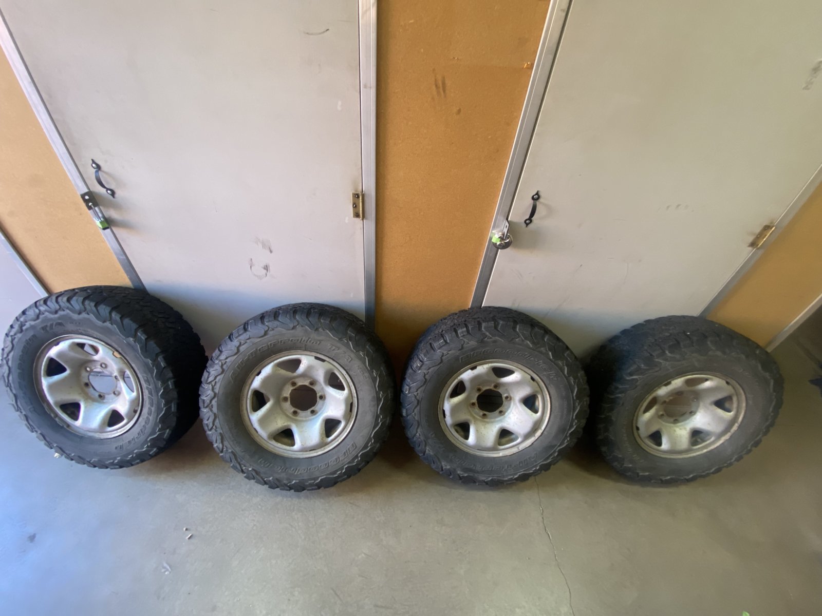

    Don't overlook plain old wheel balancing. I have a trail set of 32"s on american racing 16" wheels and a daily driver set of street 265/70/16's mounted on OEM wheels i bought 2nd hand. Had a good vibration (steering wheel shaking) at highway speeds with the oem setup and noticed it completly went away last time i threw on the 32's and went camping. Gonna have the street wheels/ tires re-balanced next week.

    Wheel balancing doesn't matter if they're not concentric with the hub.

    I agree, I honestly wonder how much the mag nuts will make a difference. They’ll be here end of next week. But I’ve taken these tires off and put them on a few times now and never had an issue like this before. The other wheels I’ve had on without issue are these.

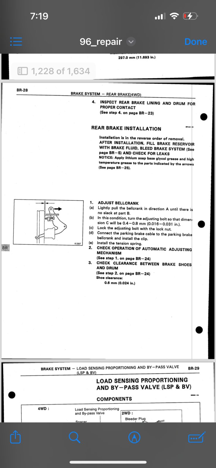

    At least in the video for the 4runner, he basically just gets the shoes close to good, then keeps pulling on the ebrake handle. I did that method and it worked to the point where the wheels lock up but not as much as my 2nd gen Tacoma. If I replaced the drums I could probably get it better, but it was good enough for me at the point where I was with it.
    I know the Tacoma's pull and twist handle is different than the lever ebrake in the 4runner, but I'd imagine it doesn't matter as long as tension's being applied and removed from the adjuster.

    Adjusting the rear brakes takes a little longer than you think. I’d adjust again you’re looking for slight drag.
    Also the new drums might be out of round - this is totally possible with cheaper parts. Might be worth grabbing the NAPA ones so it’s local?
    Adjusting the rear brakes will bring the pedal to a better feeling. I had the same issue with mine. If things were fine before and got worse after start with what you replaced. If you spin the wheel and hear it only contacting the shoes sometimes it might not be perfectly round.

    Old drums are back on while I go get the new ones checked out. Death shudder is gone but some brake shudder for sure still present. Highway vibe still present.
    I think I got the brakes adjusted a little better and the pedal feels more solid, back to normal as far as I can tell. I got them close with the star adjuster and then pulled the e-brake a few times with a consistent 12-15 click maximum. This is lower than the 20+ I was getting with the new, fresh out of box drums.
    I will go get NAPA drums if the new ones are unsalvageable junk.

    New drums turned and put on the truck, all mating surfaces thoroughly wire brushed and cleaned, brakes properly adjusted this time (big improvement here). 5-7 clicks on e-brake. Pedal is nice and firm with no death shudder on hard braking. Braking feels much improved.

    OH and to Dalandser, I noticed I have ONE mag lug nut on one of my front tires. I have never seen it before and I surely would’ve noticed it as it is a 19mm hex. I’m thinking the tire shop put it on when they balanced and rotated the tires. It was just a smidge over finger tight. I’m wondering if the tire shop was attempting to send me some sort of subliminal message to change my lug nuts. Needless to say I jacked up the front end and torqued all lugs. Mag lugs on order.
