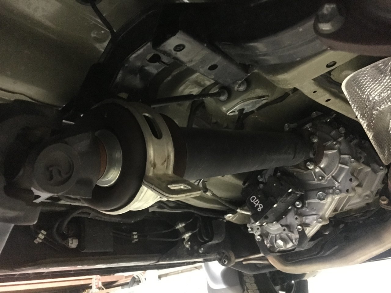

    6C0B6FB5-284F-4213-8275-5DBEFE800DFB.jpg So I had the rear differential seal replaced under warranty and drove the truck 200 miles and found out somehow the center support bearing unbolted from the crossmember and the driveshaft was just hanging down.
    What would you guys do in this situation? What to ask the dealer to check?

    Tell me about it. What is crazy is all I heard was a whining sound when I got off the throttle. I drove 120 miles back home and went straight to my buddies house who has a lift. Threw it up on the left and found that. I don’t know how it didn’t vibrate the shit out of the truck

    They are sending a tow truck to pick it up tomorrow. I’m just worried about other parts of the driveline that may be damaged. I’m sure the third member is tore up because the pinion angle is definitely changed. I am also worried about the driveshaft and transfer case. Maybe even that you joints. What should I ask them to check

    The center crossmember support where the bearing hooks up is bent so I don’t think two bolts was going to fix it

    Because whole drive shaft has to come out, to remove center section.

    I don't think so. The back half of the DS telescopes. Remove the 4 bolts bolting in the U-joint to the pinion and it's out and you have free access to the pinion/front of the diff.
    I'm wondering if the CB was loose from the factory?

    I would have them replace u-joints, carrier bearing, seals on diff, and transfer case. Also possible bearings in diff, and transfer case. With that flopping around for around 120 miles There could be some damage to all that I mentioned..

    They changed a diff seal you just unbolt it from the third member a tie it up with a bungee cord. You never have to touch the carrier bearing

    It won't slide forward enough to get it out , it has to be completely removed. No slip joint on rear drive shaft.
    Guess I should rephrase it proper procedure.
