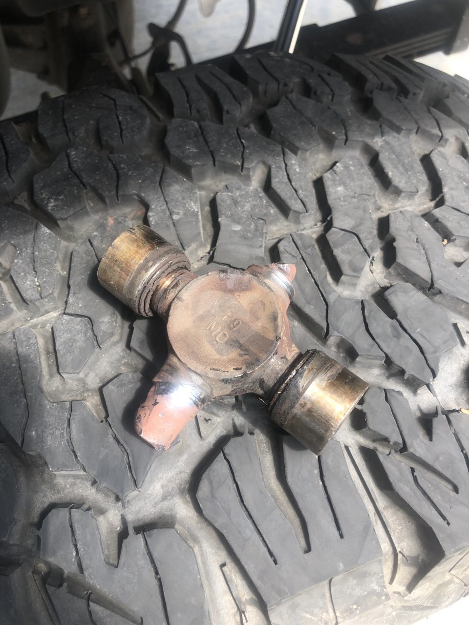

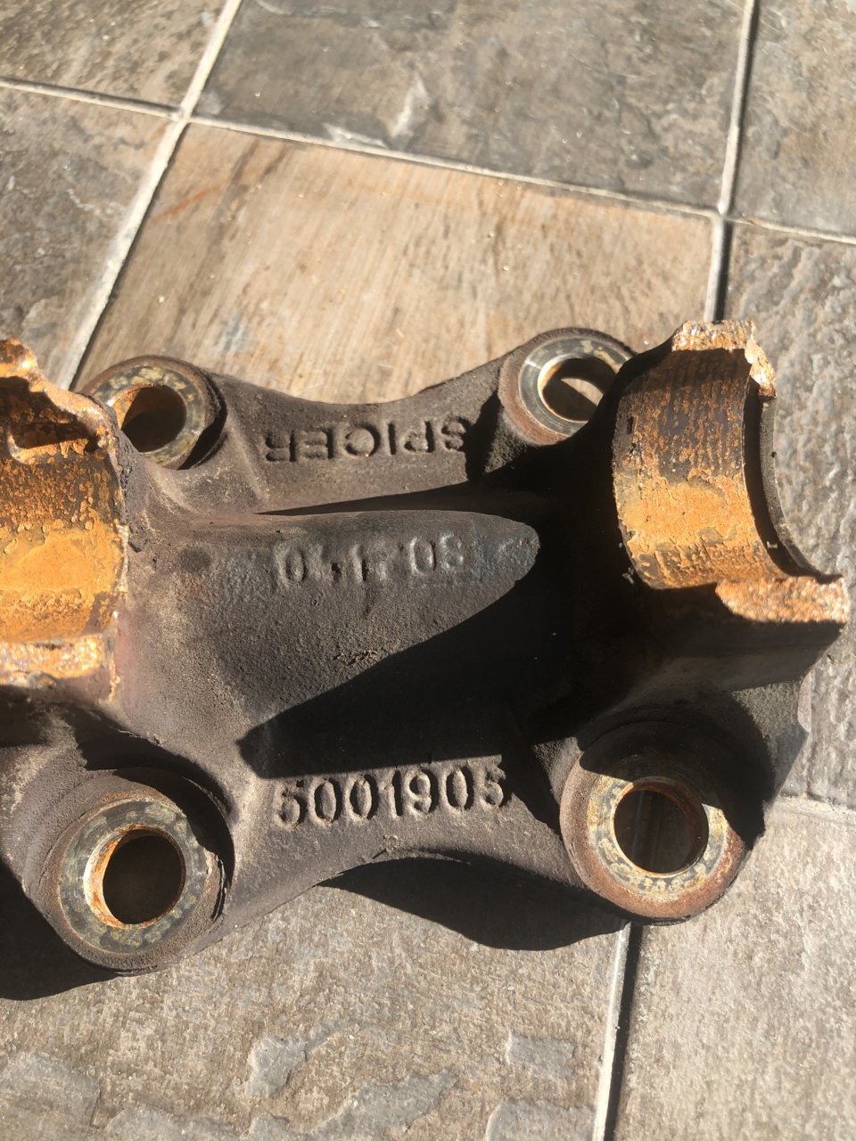

    Well, technically not the entire driveshaft, just the frontmost part of the rear driveshaft. The flange yoke and u joint decided to crap out going 70 on the interstate...on a cross country trip from Utah to Florida...currently broken down in the middle of no where Kansas. Dreams do come true.
    Heard a loud BANG, swerved as the rear axle lost all power, and came to an emergency stop. Got out of the car and, lo and behold, the rear drive shaft was hanging about a foot off the trans in the air. At that moment I knew, yep I'm f*ed.
    Managed to push the car to the nearest exit. I've called all the auto parts shops, junk yards, and Toyota dealers in a 3 hour radius andnobody carries the flange yoke. As others have mentioned, Toyota can special order the entire driveshaft for a mere $1028.
    The crazy thing is that the entire driveshaft, including these parts, was replaced 2 years ago at the Toyota dealer under the driveshaft "warranty enhancement" program...a fancy name for a recall that they'll fix.

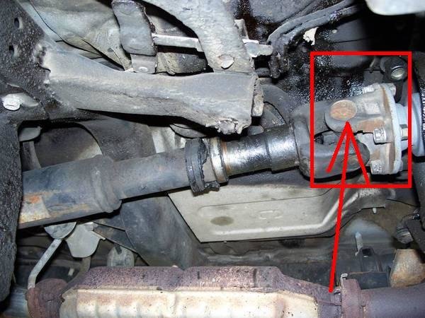

    I decided to order the flange and u joint online and have it overnighted. Does anybody know if other vehicles use the same 1330 flange and u joint (tundra, 4runner, FJ, etc)? Any suggestions??? Any help is appreciated, thanks!
    (last pic borrowed from @htx6002)

    Well I hate to be that guy but it’s obvious that the joints were never greased with any regularity. There is rust on the cross we’re needle bearings ride it was bound to fail. At least that’s what pic looks like .

    EDIT: Why does it have rust on the newly broken surfaces? I sense some tom-foolery going on here...

    My goodness....was that ever greased?

    Regarding the rust/grease, yeah perhaps Toyota only changed the shaft and left the old flange and u joint. There are 2 kinds of u joints, greasable and non greasable. I believe this was the non greasable variety. No excuse though, still should have been swapped out. I thought I was being mindful and had my mechanic inspect the driveline before the road trip and got a thumbs up.....ahhhh another reason to do all your own mechanical work.

    35"....and yeah I sense that too.... Would have never known it was rusty from the outside (the inner metal is covered by the u joints)

    Did the yoke get wet immediately after it broke?

    Nope must've been rusty in there beforehand :/ also don't live in northeast or salted roads etc

    @Hobbs actually come to think of it, I tossed the yoke in the bed and it rained overnight.....likely cause of the rust!

    That makes sense to me. I see rust "pooled" in the saddle and rust on all broken surfaces.
