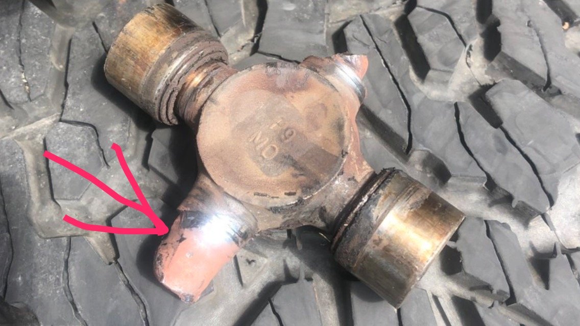

Driveshaft exploded today

    Yep! I was thinking "how could the broken surfaces be rusty?!...oh yeah it rained overnight" :rain:

    13 DCSB TRD OR v6 Auto
    OP. with the rear shaft removed, Start the truck, in park flip to 4hi, Then put it in reverse or drive depending on which way the truck wants to roll right AS YOUR LET GO OF THE BRAKES. If your actuators or functioning properly it the trans should spin and everything should clunk into place... reason for wanting to let off the brakes is it will clunk pretty good.
    If this doesnt work... whelp it explains the rest of the failure one of those being to properly maintain (use on the regular) the 4wd system.
    Also OP, do you have a big drop bracket lift? and subsequently big ass Carrier Bearing drop? Its very likely that your working U joint angle at the trans especially if you are a DCSB or Access cab, is WAY to high which will prematurely wear a u joint out like this.

    @nd4spdbh yeah it's a 6 in rough country lift which has a drop bracket. And yeah the lift came with 3 quarter inch carrier bearing spacers to drop the carrier bearing to the desired position. I installed all 3...would you forego these spacers or only install one or two? I installed those thinking it would help realign the driveshaft angles closer to the original angles

    Yikes!!!
    Guess that rust didn’t help

    See above. The rust was from rain after it broke :)

    Sorry to hear that you're broke down on your trip. If I was closer I would try to help you out.
    I hate to rub salt in the wound, but this is evidence that it had to have been clanking, squeeking, and vibrating for a long time.

    Haha thanks. Actually no clanking or vibrating or anything like that or I would have serviced it. It vibrated for about 2 seconds before the big bang though

    Glad no injury, Did it have a squeaking sound before the part broke?

    No squeaking, just 2 seconds of vibration like a rumble strip

    Tom Woods double cardan driveshaft....
