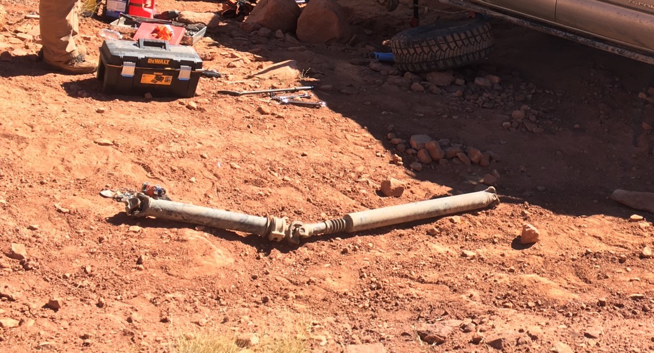

    BEB2C78D-4485-4F75-8D8F-B5728DD4ACC7.jpg Seen this before, IDK if it’s better on the trail or the highway? Good luck I hope you stay safe! I also hope you get some help as good as the guy this happened to.
