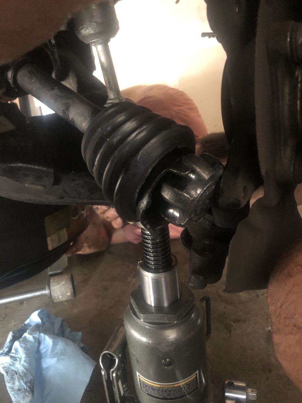

    For anyone considering a lift, the driveshaft angles get screwed up even if you "adjust" with the center support bearing shims...which puts more wear on the u joints and flange (and a ton of other important things like your cv axle). It takes a lot of angle measurement and math to get it back right...which you can never quite do back to stock specs...and optimally a single piece custom made offroad driveshaft from Tom Woods driveshafts ($5-700+).
    Alas, currently waiting for the flange replacement shipment to arrive after being stuck in Kansas for 5 days.

    @nd4spdbh here's a pic of the cv angles you asked for...they became pretty extreme after the lift

    Basically it literally blew up from the excess friction. Once the rubber gasket was shot grease started leaking out and burning up. Followed by loss of cv bearings rolling down the road. And then extreme grinding noise. You lose good steering control and it ain't pleasant.

    Jezus, no wonder why they exploded... those CV angles are WAY too high.
