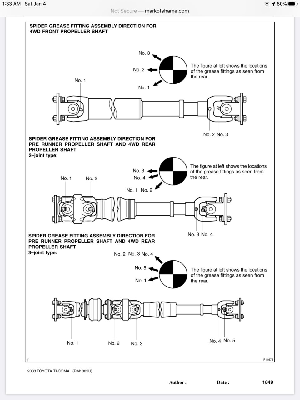

    When I replaced the center bearing the front half drive shaft flange fell off before I applied any match marks so I used the picture below to try to line things up buy the zerk fittings. Can anyone confirm that was wrong and I should have used an inclinometer on the U joints and made sure they were all at the same angle front to back?

    You did it right

    Thanks @mechanicjon and @slander. I checked angles using the inclinometer method and I’m spot on. I’m getting frustrated chasing vibrations. Just when I think I’ve got the problems solved something else crops up, the latest is really bad when I go over 70 mph. I pulled the slip yoke and checked the rear u-joint and could feel a very slight change in resistance when I rotated it through one axis so I ordered a couple Spicer 5-1510X replacements. While I have the rear on jack stands I’ll run the rear wheels over to the local Firestone to check the balance. Again.
