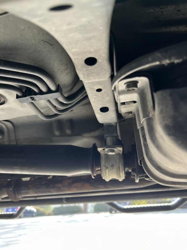

    I used bushings like this and longer bolts between the carrier bearing and frame when I installed my ome springs.

    @Parkvisitor do you happen to remember what size those are? Did you change your pinion anlge with shims at all? What was the result?

    IMG_4056.jpg Stevo I used M10x1.25 70mm length bolts and the bushings from Ace Hardware. I have OME springs the extra leaf and probably a 2 1/2” rear lift. No driveline vibrations.

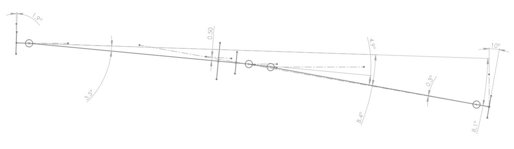

    Thanks Juan, I made my own out of some 1/4" aluminum flat bar. Doubled up for a 1/2" drop. Maybe the 3 degree axle shims were overkill? Anyway, here is was my current angles look like:

    Looks good, drive it, if no noise, it’s all good!!

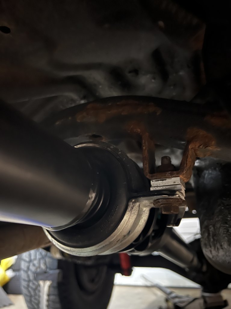

    That's the problem, I still have a shake over 65 and a noise that starts above 20 and just increases with speed. Sounds like a bad carrier bearing would sound but its a brand new 2-piece shaft from USA Standard gear that came pre-assembled with the CB in the middle. Everything should be in phase and balanced from the factory.

    Pretty easy to inspect the C/B. If you replace I recommend the spicer.
    The carrier bearing in your photo looks ok. I mean when they’re worn the D/S is noticeably dropped in the rubber donut.

    It's a brand new carrier bearing that came with the pre-assembled two-piece shaft.
