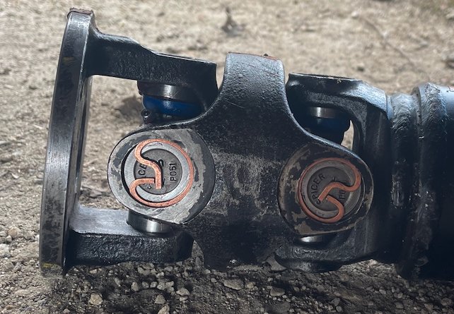

    Hello TW,
    Truck: 2010 4.0L V6 4x4 with 120k miles
    I made an original post asking for advice on my shudder starting from stop happening around 10-30mph.
    Everything I have done to it includes, spark plugs, tire rebalance and rotation, MAF and throttle body clean. All fluids including oil, transmission, diff, transfer case. All U-joints replaced (I believe) and carrier bearing replaced about 10k miles ago.
    Shudder is still present!! Ended up taking to Toyota in Bozeman, MT and they said,
    “rear driveshaft looks twisted and u joint is out of line” and want to me to replace the entire driveshaft for $1400.
    I took a look under there to see if I could find what they were talking about because they would not tell me which u joint it was… let alone what part of the driveshaft. But I saw a space in the u joint (pic below) and was wondering if it would be enough to cause the entire driveshaft to be replaced or even needing to replace the u joint.
    Any thoughts or comments are appreciated.

    Id say normal use no. Ujoints look bad, it takes a lot to bend a driveshaft.

    I do not know too much outside of basic maintenance but I am trying.. so the think the u joint is bad? Is it possible for them to go bad after only 10k miles?

    I don’t drive off-road. I have gone in a couple of rough places but that was two years ago. This all started when my carrier bearing went bad in November and was replaced along with the u joints. I did not replace the joints myself so I am not sure what parts they are

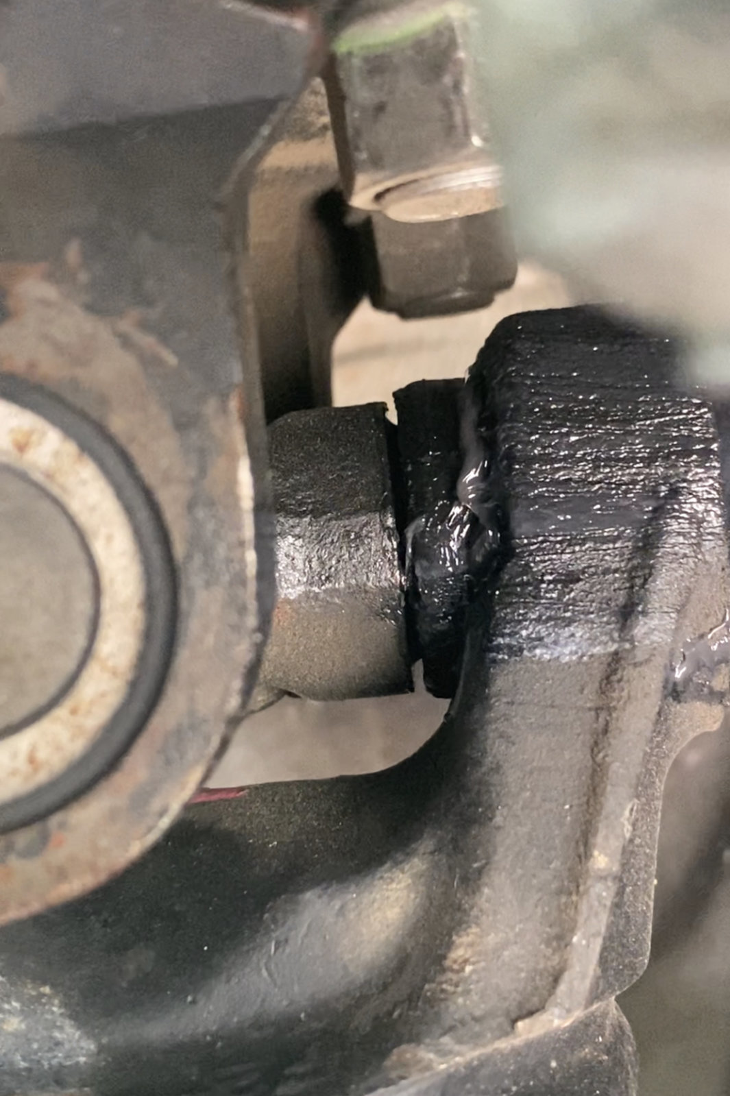

    The picture is of the diff one

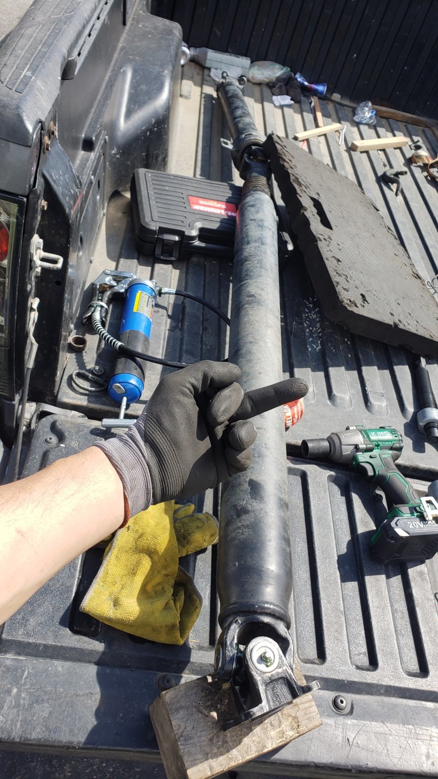

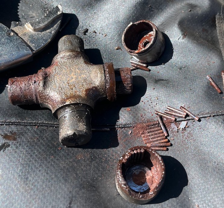

    I just replaced mine a few weeks back -- pic below. The cap of the ujoint is what gets pressed in and there are a bunch of needle bearings in there. If one of those falls out and into the top of the cap it doesn't sit flush down in my case, the blue rubber (?) seal thing that keeps the grease contained. I say this because in your pic it does look like there is a gap between the cap and the main base ... possibly caused by one of those needle bearings coming falling down when the install was done. The bottom pic shows my 'bad' ujoint and you can see the needle bearings I'm talking about.

    Thank you for clarifying what the needle bearings look like… I’ve never seen them.

    If theres a gap in the rubber like that its bad. It wasnt seated right or they didnt put the clips in on the ujoint. Or they dropped a needle bearing in the cup and installed the ujoint

    Quoted/bold because I did this once and didn't realize it until I couldn't get the cap all the way seated and clip in position.
