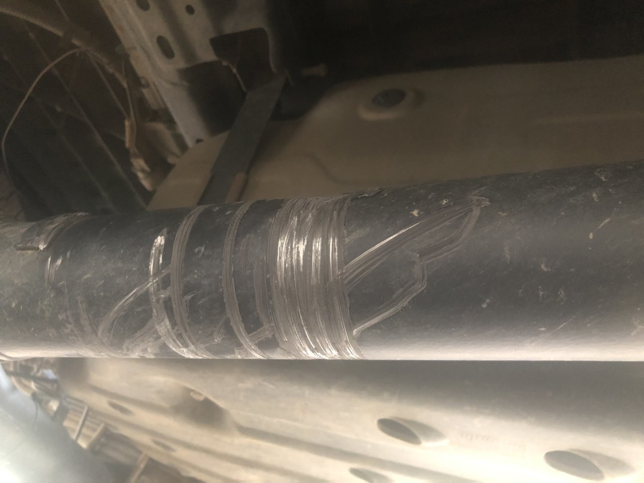

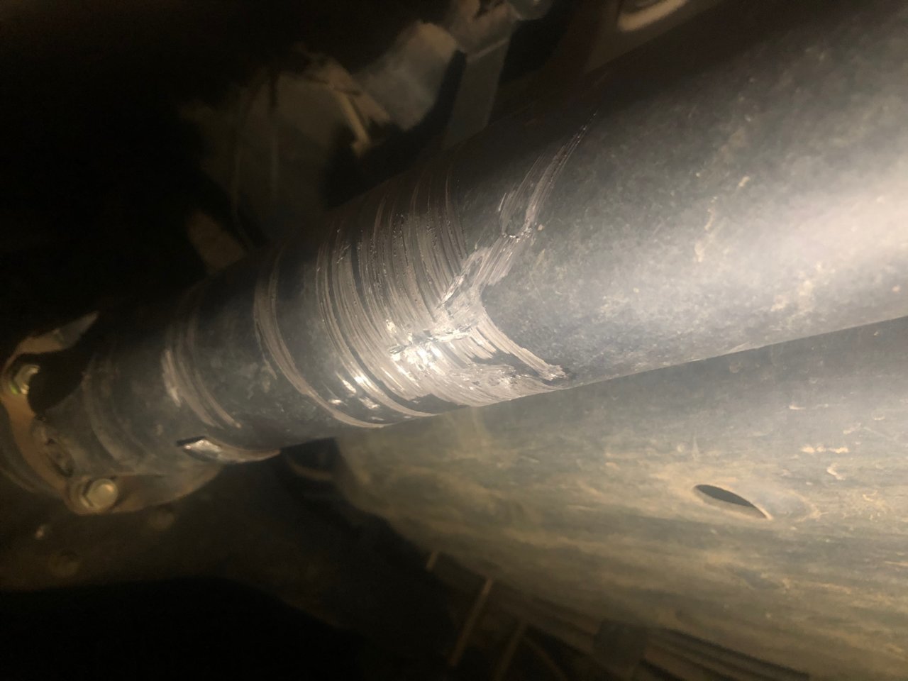

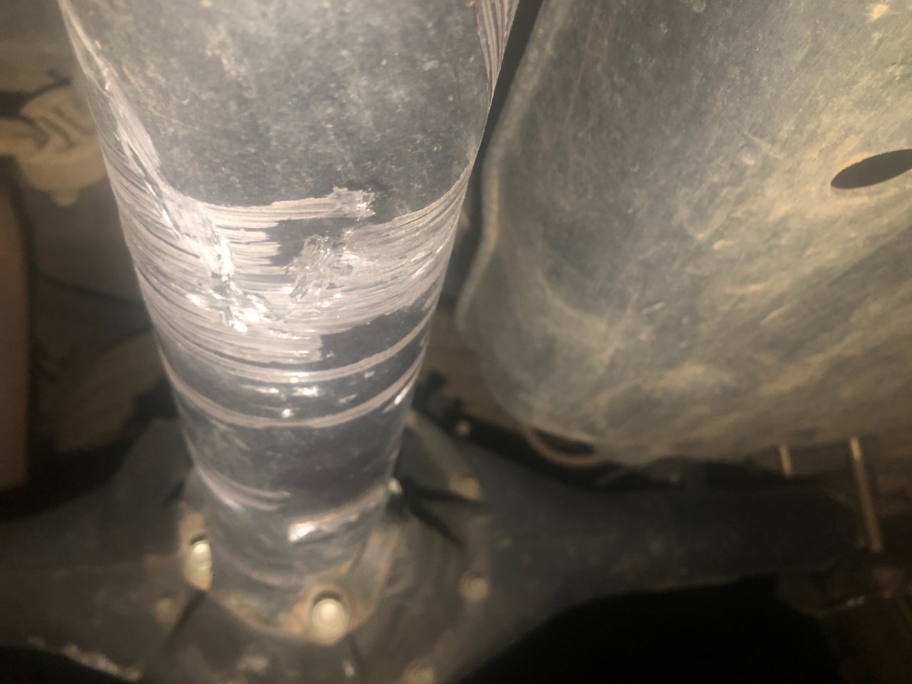

    Hey all,
    I was out doing some light wheeling today and lost traction going a bit off-camber over a large rock. I ended up sliding off it and the driveshaft landed directly on top of the rock, making first contact after the tire slippage. I was barely moving when it happened so there wasn't a lot of force at play, but wound up resting driveshaft to rock when I came to rest. I backed up a bit to see if I could renegotiate the obstacle, which is when I realized what had happened.
    Anyway, I got some nice scars on the driveline from reversing, as well as a pretty good dent on the side of the thing from the first impact. It drove home the ~45 miles home just fine with no shuddering from the rear end or anything like that, that but I'm wondering if I should be worried in the short or long term about driveshaft damage. Should I replace immediately? Will it be fine for another 200k miles? Do I need to obsessively check the carrier bushings from here on out? What gives?!
    Curious what your all's advice is. Only thing searching got me was how to replace it, not much about when to replace it.
    Thanks in advance, you glorious folks, you.

    As long as the driveshaft is true, and is not wobbling, shuddering, or causing vibrations, it a trip to the hardware store for some black paint.

    Based on the pics, the damage isn’t that bad. If you’re concerned, take it to a local driveline shop and have them balance it. You say it drives fine without any noticeable vibrations or shuddering, so most likely you didn’t do any serious damage.

    If he’s saying there’s no vibration or anything feeling different, he’s probably fine.
    Eventually, if it’s not balanced, he’ll trash his carrier bearing or u-joints.
    ...but those usually wear out anyway, so meh.

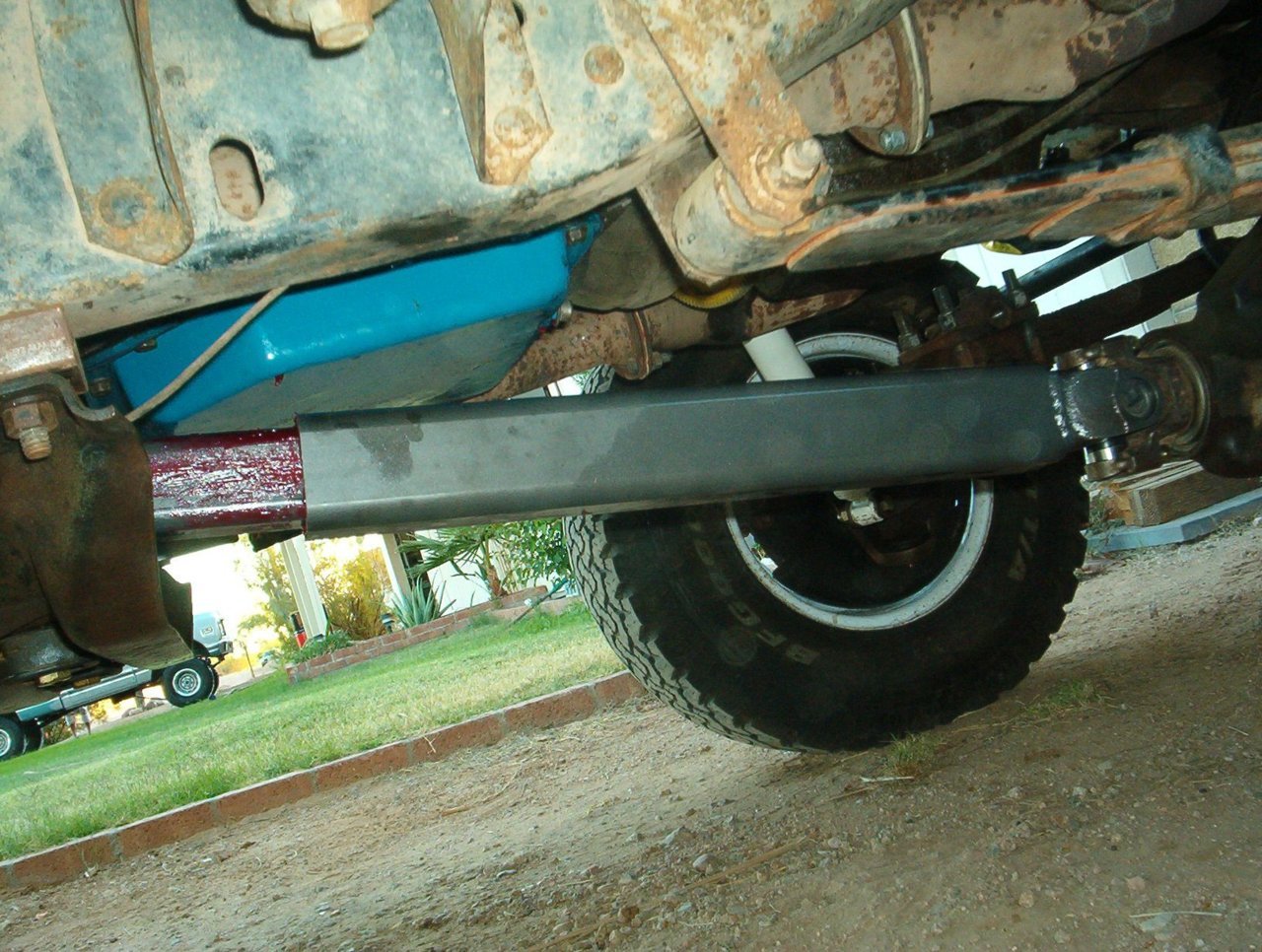

    First time you get on a ledge and bounce the tires and load up that shaft it will turn into a pretzel. A good driveline ship could build you a better stronger one for not too much money. Smaller diameter and thicker wall is a good thing.
