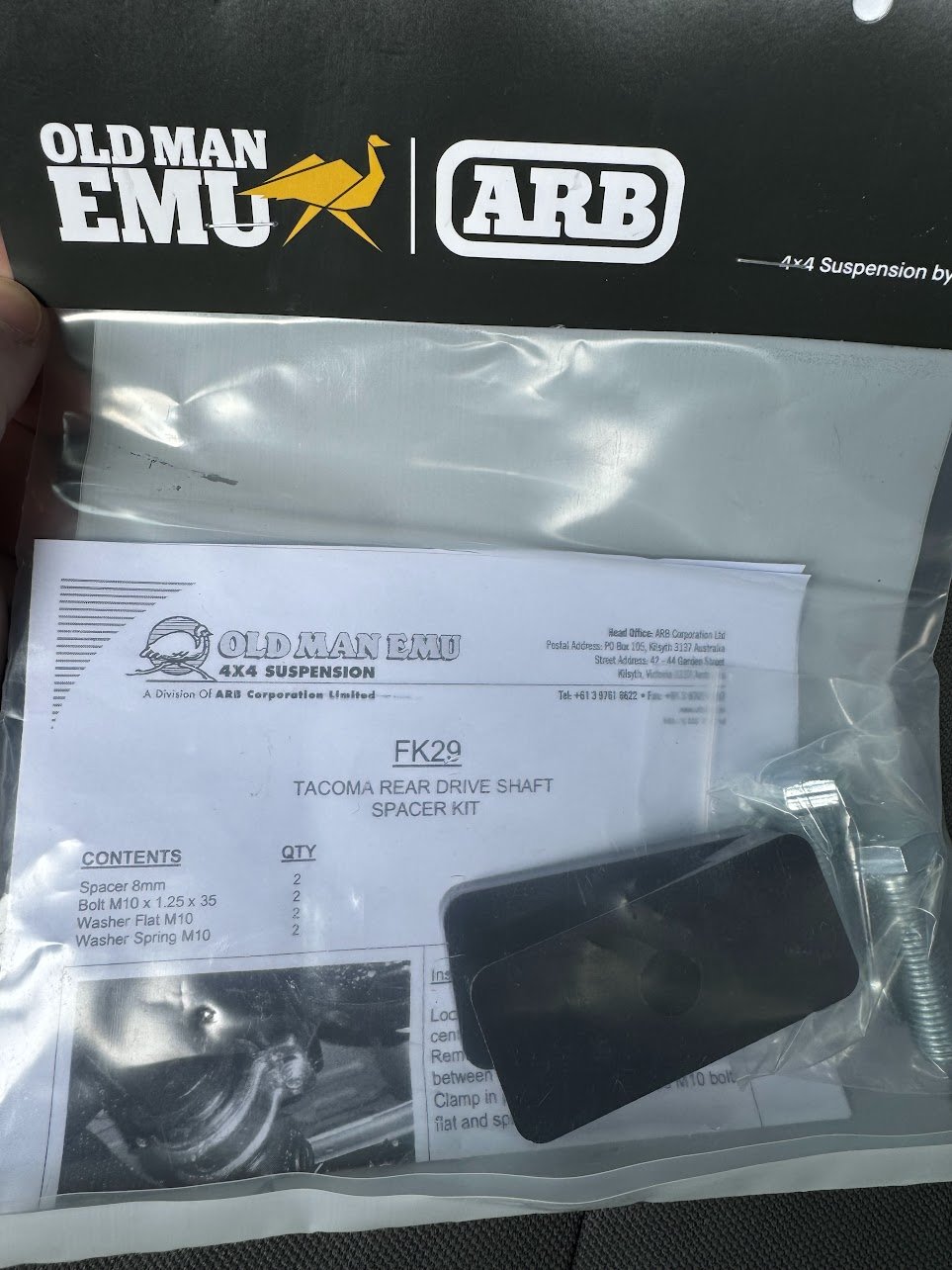

    Hey,
    I own a 2022 Tacoma SR Utility Package, RWD. I have a 2" front, 1.5" rear lift. The truck has 17k miles and doesn't get driven much, but ever since I owned it, the braking was a little rough (made previous posts about it). Even before the lift, I noticed my rear braking would sometimes "shudder" or feel rough. The brakes work great, but the braking has never been smooth since I bought this truck. The dealership did replace both rear brake drums and rear axle under warranty, they said they were out of spec. I purchased this Driveshaft Spacer part over the winter, and now have some extra time. Should try and install it, how easy it is to install, and if it would help my issue at all, or make it worse?
    Thanks

    That part lowers the carrier bearing to manipulate angles in the driveline.
    Tends to be a solution for driveline vibrations and vibrations upon acceleration or at a certain speed range.
    Which I think is a different animal from brake vibrations or brake shuddering, etc...

    Very easy to install - probably 5 minutes with hand tools. Like @SUMOTNK said, it's not going to help with brake shudder, though.

    Ah, yeah I don't get any weird vibrations when accelerating, so maybe I'll leave it alone. The braking thing isn't that bad, I've gotten used to it and the new axle and drums helped a lot, so I'll probably just leave it be then.
