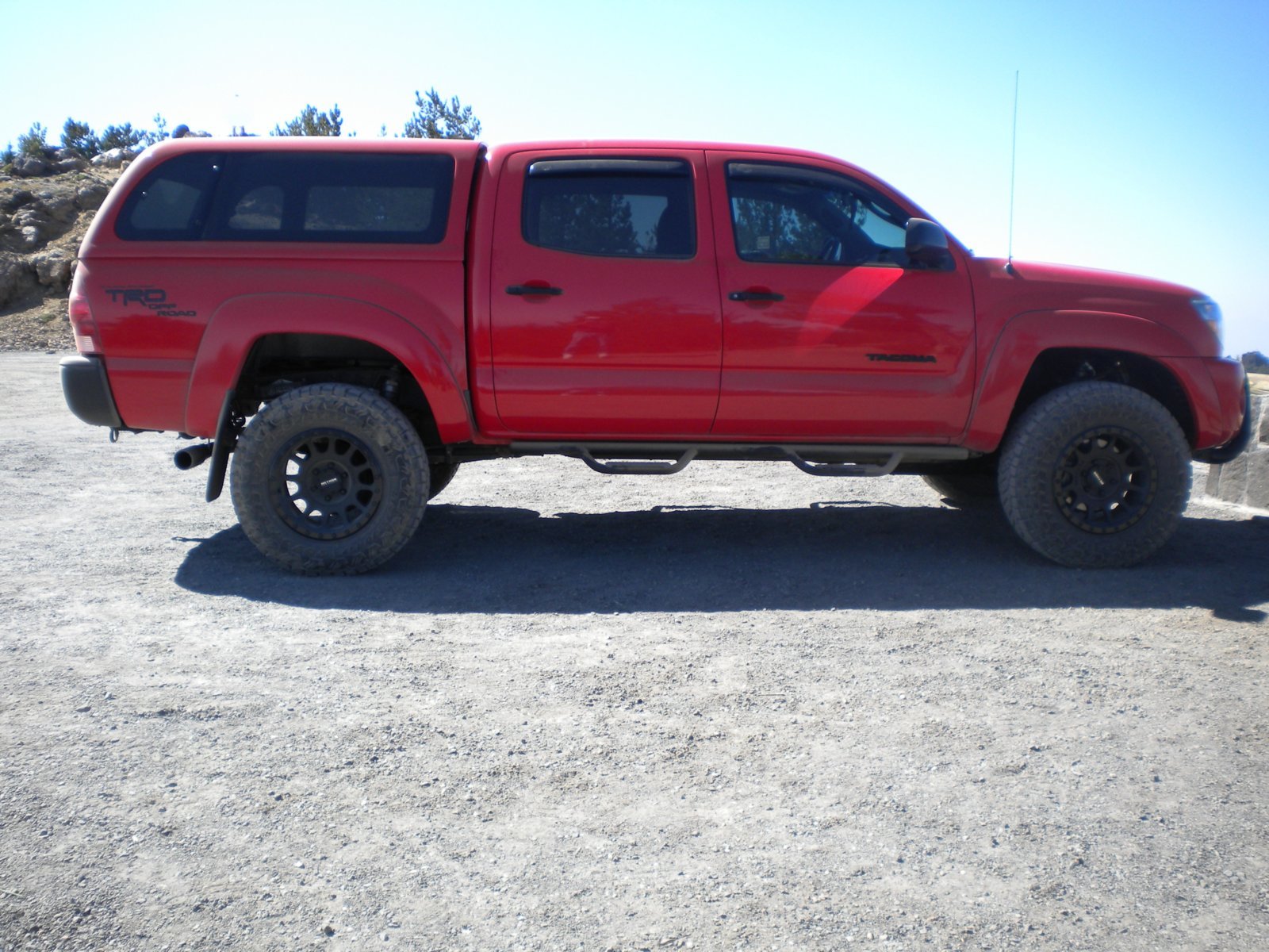

    These trucks are light in the back and like you many complain of axle wrap right from the start. The blocks would only make it worse in my opinion. Personnally, i'd skip the tsb and go for a quality leaf pack (not aal's.) The icon rxt pack is a great choice and has 3 lift height/load options... here's how option #2 with the weight of the canopy looks (2" lift front/back.)

    I was looking at the Old Emu leaf kit in the future. I would want to raise my front from 2" to 3" if I did that though, since most the time I have an empty bed and don't want the rake for no reason. How good are those ones? Do they make a 2" leaf kit that would level out a 3" front lift? I see this one you linked has 3 options? I'd prob go with option 1, just under 2"
