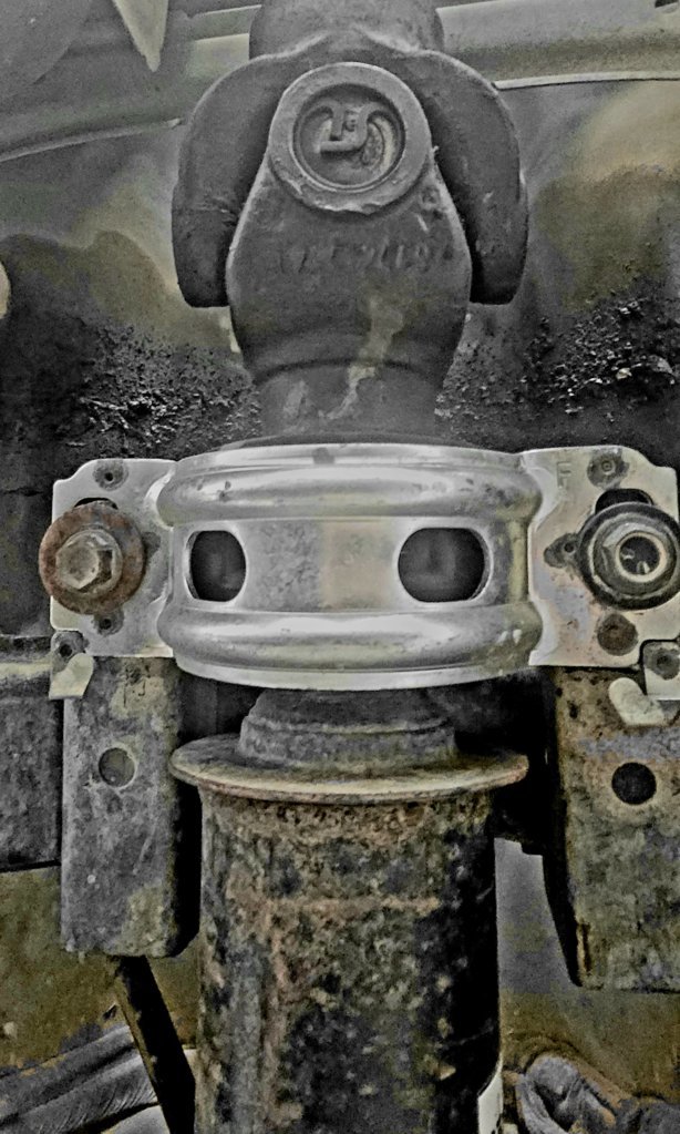

    2 of the ujoints were replaced less than two years ago as well as the carrier bearing, the front is the only ujoint that hasnt been replaced (long story). The carrier bearing was installed backwards (not my doing) and I do not mean 180' out, I mean facing the wrong direction so Im assuming as there is a F on one side of the bracket, I will try to post a picture. I let it ride that way, didn't seem to be causing any issues, now I'm having 2nd thoughts on that. The leaf spring recall was done and the bolts are torqued. I want to pull the driveshaft today, but don't have a 2nd vehicle to get parts (wife is at work). So no, I haven't yet checked the yokes quite yet. 20250603_112156.jpg

    A 2005 that the front universal joint that hasn't been replaced along with the other two.... That is where I would suspect an issue, but it could still be any or all of the joints and or carrier bearing.
    Do you know if the front joint has ever been replaced or if it is the original?
    I would also inspect the frame mounts for the engine mounts, they have been known to break loose due to crappy welds. give them a look.

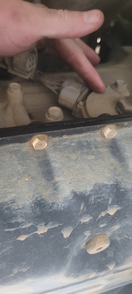

    I do not know if the other one was replaced. I think I'm going to pull the driveshaft and replace the other U-joint, along with the carrier bearing and grease the splines. Off topic, put the truck in neutral, jacked up the rear end and spun the driveshaft and there is an audible clacking noise, that I will post that sounds like a penny bouncing around in the transmission, just above the oil pan on the right side. The carrier bearing is also squeaking some. You can hear the carrier bearing in the video as well...Now I'm really concerned...Transmission clacking. It won't let me upload a video so I'll just post a picture of the location of the sounds...picture isn't the greatest, but it's where I'm pointing to just above the transmission pan on the right side.
    And yes, I know I do not have lower O2 sensors...Don't judge me...Prior owner put an exhaust on and there were no holes made or upper O2's installed. I let it eat, just poor gas mileage.

    If you live in the Rust Belt and from the photo you posted in #6, I'd do what Jimmyh said, look over the frame. The surface area around the carrier bearing and the drive shaft surface gives me the impression that there could be more going on than we can see.

    Turns out brother that you were right. Little to no play in the U-joints. Carrier bearing makes a little noise but, not enough play and hasn't entirely failed. Started inspecting the engine mounts at the frame...Sure as shit, worse case scenario...Drivers side frame mount weld failed at the bottom. Just to be clear, I don't off road my truck or put heavy use on it. I can't speak for the previous owner, I traded for it. I can push up and down on the frame mount and visually see movement at the frame mount...I'm pretty screwed I think
