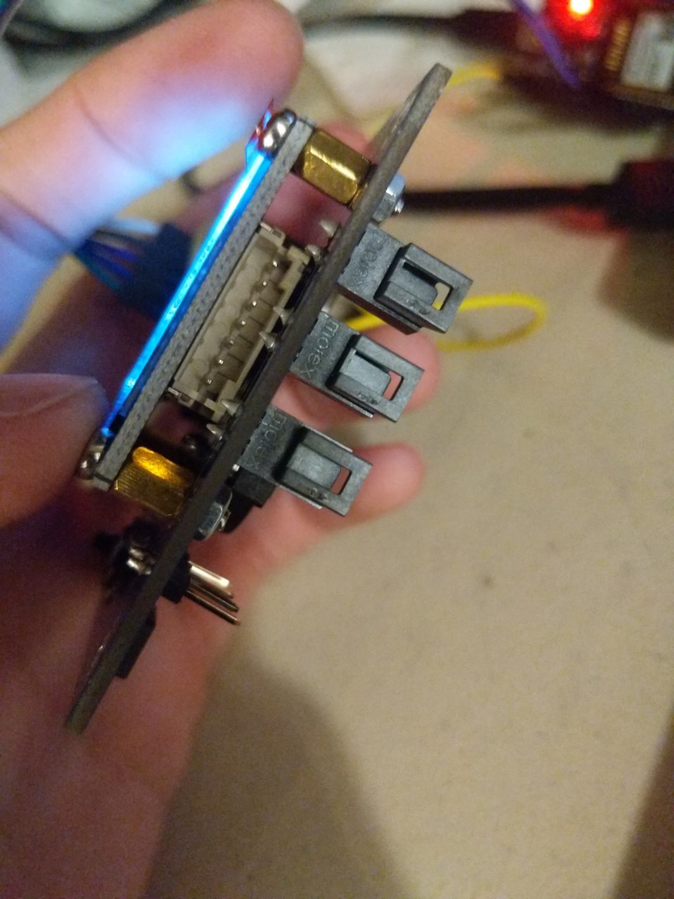

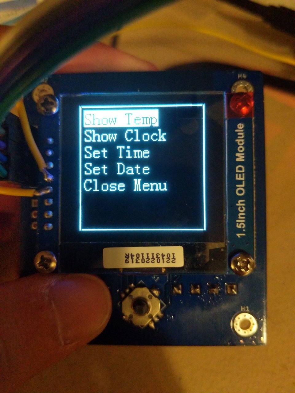

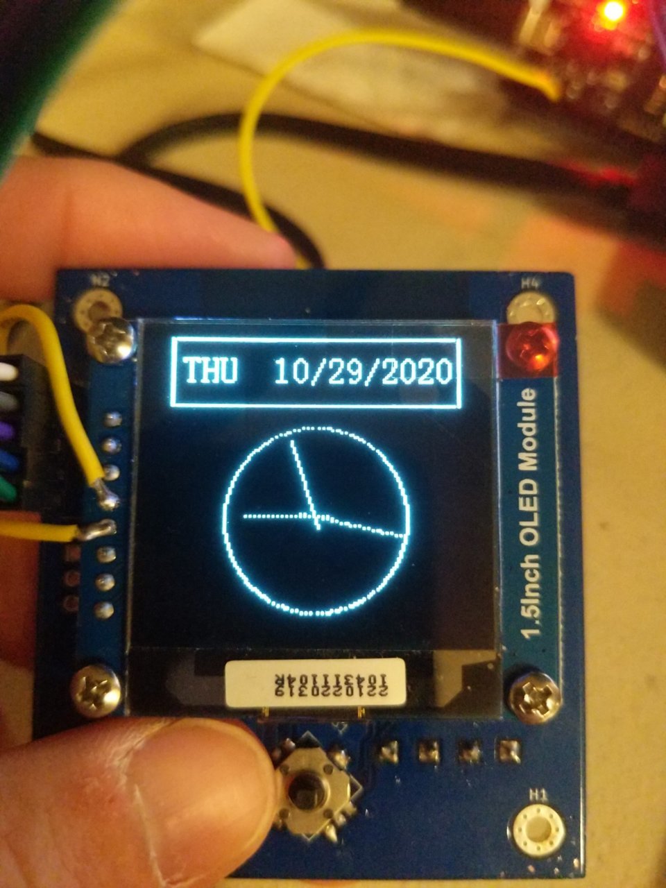

  5. Oct 29, 2020 at 10:19 PM
    #45
    drewmox
    drewmox [OP] Well-Known Member
    Jun 15, 2020
    #331556
    129
    Andrew
    2003 4x4 3.4L Black DC
    SS3 Fogs, Bilstein 5100s, KC Cyclone 3rd brake, stock AF otherwise.
    Finally got all the components in to solder up the first PCB prototype. There are a couple traces that needs to be switched and some refinement on the code side but other than that it seems to be running fine. I am going to design a better plastic housing and 3D print it to install this baby in my truck for a few weeks and see how it runs in place of the OEM clock.
    The clock is pretty nice to watch go round, nothing fancy though just a simple analog clock that is rendered using some simple algebra.
    I have gotten the little 4 direction switch working so I now have up-down-left-right-press function in a small form factor. I had a design on how to control it with a 3D printed joystick but that needs a few changes that can only happen when I have the housing designed. I will need to see what it is like to change the settings while in the truck before I settle on the final shape. One nice feature is I can now toggle between the different screen modes by press left or right on the joystick. Before I had to change variables in the code a re-flash the whole unit so this really saved me a lot of time when testing features.
    I went with Molex connectors for the sensors in case I need to remove the whole unit to make changes to the firmware later. The large white JST plug isn't used for the OLED screen as I opted to make a direction connection on the left side for the sake of easier assembly.
    If things keep going this smoothly I should be able to get the remote firmware updates working. That will save me a lot of time by being able to connect the device to wifi and allowing it to automatically update while my truck warms up in the morning.
