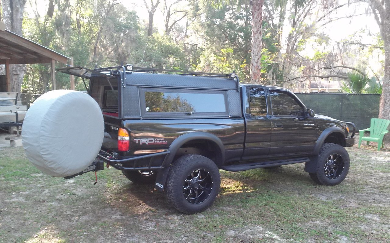

    Where did you get that awesome camper shell?!

    id like to know also...i like that one way better than my fibreglass one

    The cap is made by catamount in Vermont. Contractors cap and I made the rack on Top and did the diamond plate myself.
