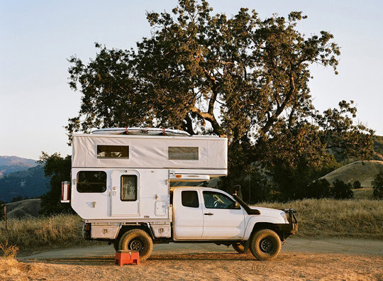

    FWC doesn't sell the flatbeds as a shell model, so they are all fairly well optioned. We added a few things (awning, 60L fridge) but also removed some things (AGM battery -> Lithium, bed pull out). The flatbed is a Utebed to which I added tool boxes and a pull out drawer. For suspension I have OME Dakar heavies with an add a leaf, air bags (usually 10 -20 psi, just to fine tune) and OME BP-51s. This has worked fine so far (18K miles) but I am aware that I am heavy and definitely wouldn't want to be any heavier.
    As for temperature and condensation - in a humid climate you will get condensation anytime the outside temperature is much below the inside temperature. I was up north in August and September with temps just around freezing at night and it was already an issue. It will be more of an issue long term.
    You definitely COULD do this in a Tacoma/FWC Flatbed or XP Camper, but it is not the right tool for the job. Something like this would be much better (if you want to stay small):

    Thanks for responding! Did you do the suspension modification before picking up the camper? I’m wondering if the stock suspension will take a 5 Hour drive down to Sacramento to pick up the camper. Have you taken it off road a bit? I’m wondering how stable it is in terms of top-heaviness. Since I’m heading into retirement, I don’t plan on driving it serious off road but will come across areas of mud and sand. I’ve talk to you to people up in Seattle and I am considering them. You said you had under body boxes, did you get them from them?
    Thanks! Haven’t figured out how to p.m. people but if you want to go off-line we can

    Stock suspension will be fine for that short of a trip - it may be done shortly after though if you do any flexing with the weight on
