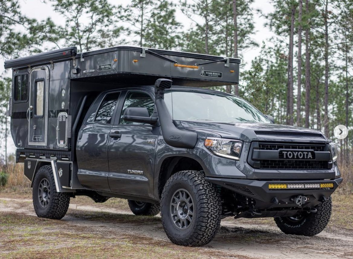

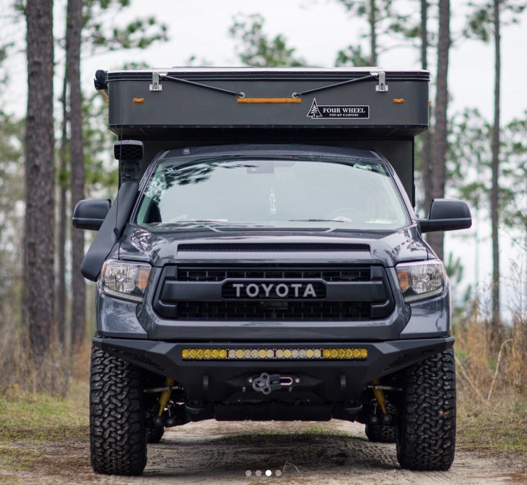

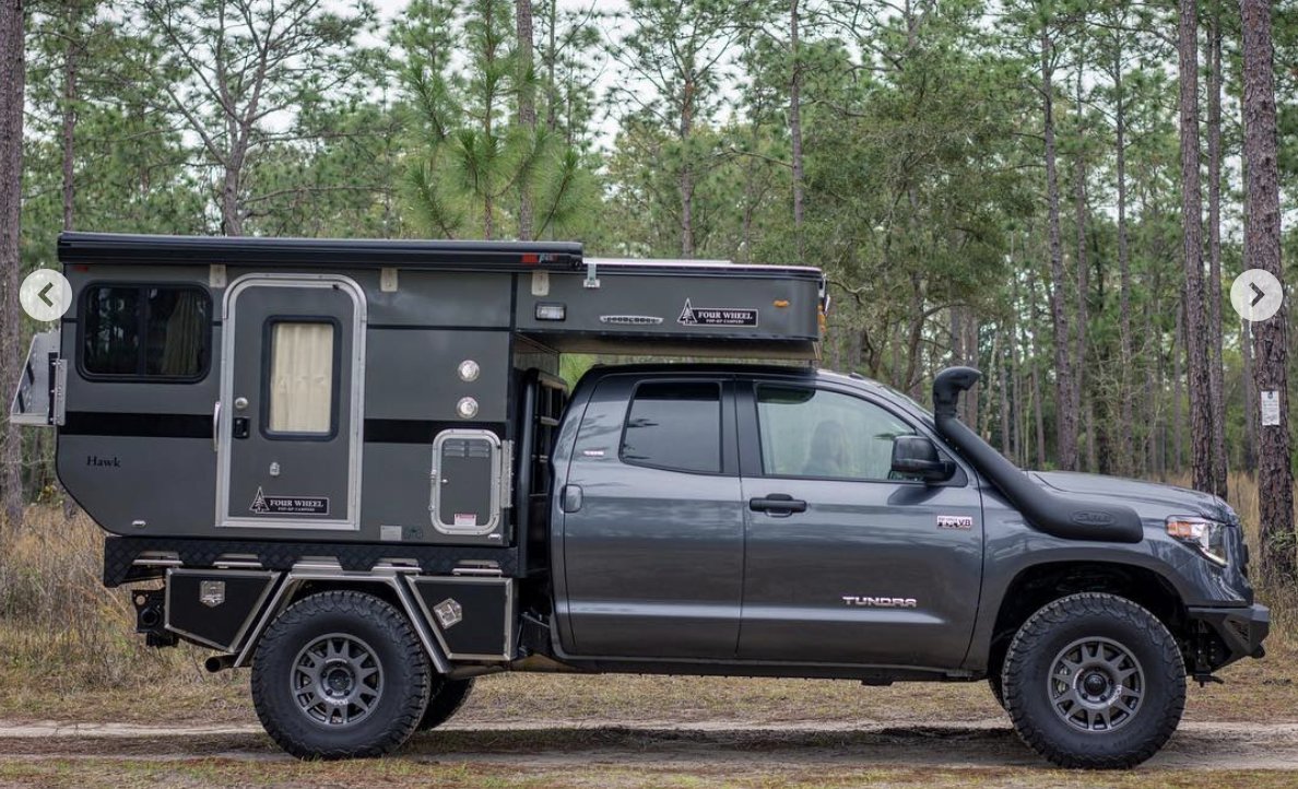

    @Round the world this is a new build by Main Line Overland and @Bound.For.Nowhere (on instagram). This build is exactly inline with what I have planned in hopefully the not to distant future, except with my Tacoma of course. They are uploading their build blog tomorrow at https://www.boundfornowhere.com/blog/ if you're interested. Thought I would share! Hope the process is going well for you, and continually look forward to updates you make. :)

    I've seen flatbed version of the camper on Tacoma and it is really nice, but the problem is that you are maxing out payload by having camper only.
    Still need to put 2 people in, extra gas, gear, food, recovery tools etc; which will result in 800lbs+ overload of the platform. How do you plan to go about it? Some countries could be strict about the max GVWR I've heard.

    i agree it will max it out. This tundra looks great and i am sure is good set up.

    For starters being able to increase the GVWR with aftermarket suspension, wheels, tires, leafs and bump stops (don't know how that works at boarders though). I would also imagine that the aluminum flat bed is lighter then everything you take off to put it on. I am also not planning on traveling the world in my set up, so it's a different ball game. Just looking to share with @Round the world something new that interested me.

    Nice rig! I really like the FWC Hawk because I can actually stand fully up in it. I’m 6 feet 4 1/2 inches, the hawk is a crucial 1 inch taller and 5 inches wider than the Fleet; it has plenty of room. But the half ton trucks are too wide for where we’re headed.
