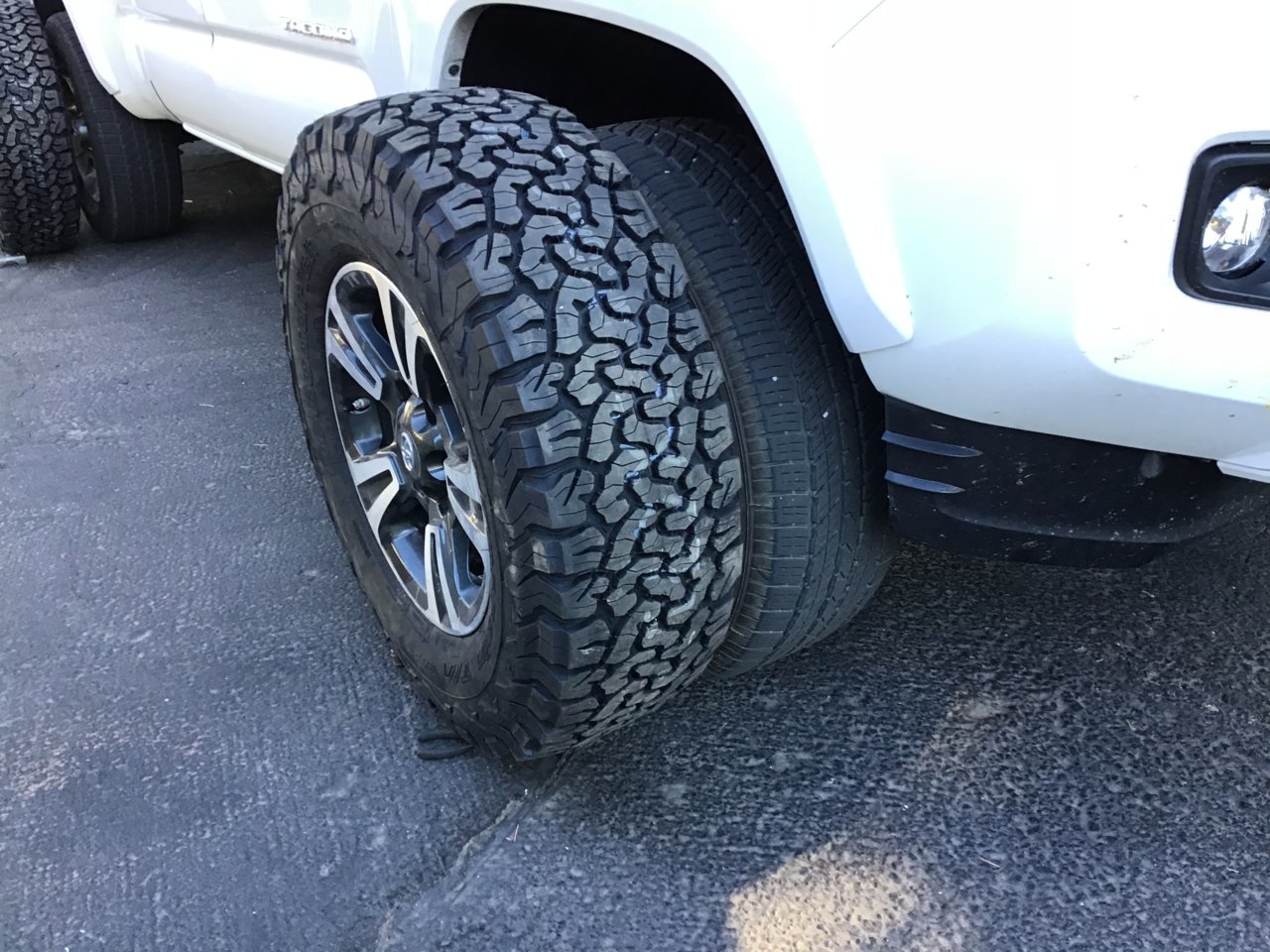

    Excellent! I went with the K02 as well (265/75/16) E rated version as I think these will be the best choice or a mix of dirt/ road use and should also be reasonably easy to find replacements.

    Find a way to have a new set waiting for you around every 20k miles down the pike. Fresh solid rubber will save avoidable humbug.

    That’s just what we’re hoping to do, although I’m hoping I can go 50k using a 5 tire rotation

    SCS F5 - 17x8.5 Matte Gunmetal Cooper ST Maxx - 255.80.17
    Personally would have selected Yokohama G003 or Cooper St Maxx. They will be better in almost every aspect. The KO2 are decent but not great at anything and below par in rain or snow.

    I agree with you otherwise. It’s just hard to beat the k02 for being known and sold the world over. Questionable Wet and snow Traction aside, they are durable tires for sure.

    We use KO2s as our main work tire on F150s where they have to contend with snow-covered roads for about 4 months of the year. Coming from our foresters they seem to like them.

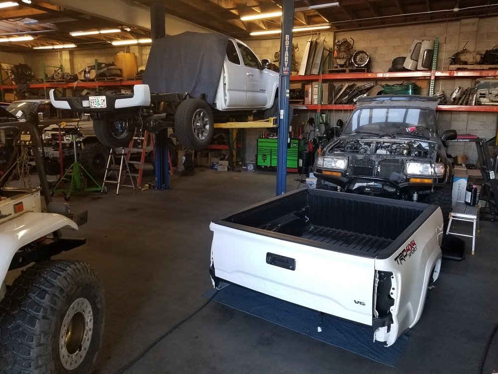

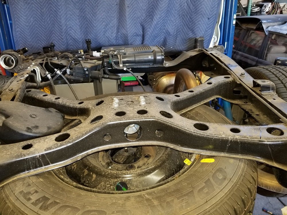

  20. Jul 17, 2019 at 10:18 PM
    #460
    Round the world
    Round the world [OP] Well-Known Member
    Jan 4, 2019
    #278143
    1,777
    Andy
    Home's our Tacoma
    2019 Tacoma AC LB TRD Sport MT
    flatbed with 4WC Fleet with extensive mods
    installation of the LRA 33 gallon fuel tank
    Taking the bed off took maybe 25 minutes
