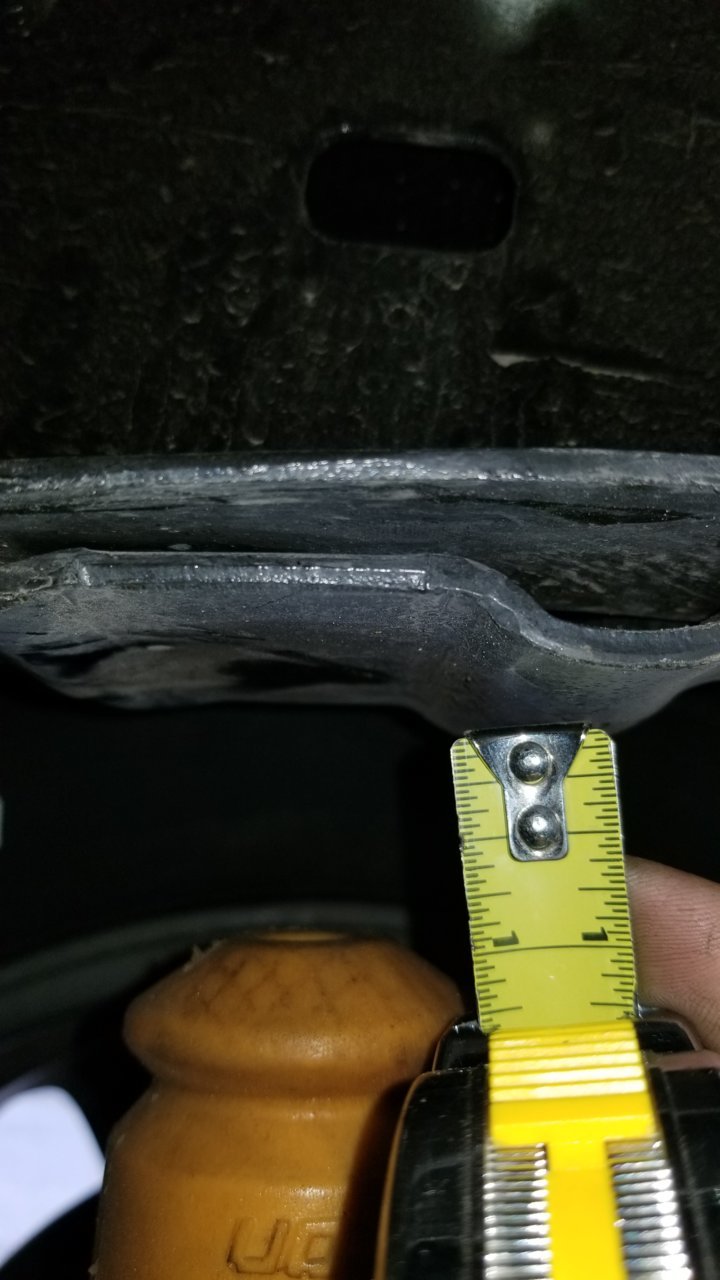

    Funny you mentioned custom springs. Our extreme duty Dobinson springs (model # L59-176-R) which are not even an option for Tacoma's and are designed for the 2,000 lbs loads on a Hilux aren't cutting it.
    Notice that the spring is basically flat
    And there's only 1 1/2 inches of clearance above the falcon bumpstop
    So we've ordered a custom spring set from Deaver. Should have listened to you...

    Yikes, I've got these and will have to watch them. How long did that take?
    I guess you always get what you pay for, will probably end up doing some deavers and custom valved rear shocks at the same time...

    Is that fully loaded with gear and provisions? To me, it looks like it's got over an inch of up travel until it hits the overload, at which point it will hit a more progressive spring rate. And the bump stops have quite a bit of compression to go through. I don't think it's that far off, but having a little more cushion than that seems reasonable.

    That pack looks like it could use one or two more leafs. 10+ leaf packs are pretty common to find in 70 series troopy campers and utes, as well as HD packs by Deaver. Given the distance and variety of terrain you're looking at, I'd also bring along an extra leaf or two.

    It happened basically immediately, truck now only has 500 miles since the install. What's too bad is a set of custom springs is maybe $600-$700 versus the Dobinsons at $400. Oh well better to figure it out now vs later. My rear axle weight is 3,980 lbs now, stock rear weight was 1,900 lbs so I'm at the limit of the Dobinsons

    These pictures are with recovery gear and a full tank of gas, no propane, water, food, or people. I'm thinking that we'll add up to another 500 lbs. When going over a pretty deep pothole one of the rear tires hit one of the underbody boxes so knew i had a problem. We're going to put on a beefier bump stop, a Timbren

    Oh yikes! Yeah I think the dobinsons just aren't the right spring for you. I'm pretty sure the 176 is only like a 550kg load rating.
    I still need to weigh my rear but I have a slide in shell so much lighter than you and no flattening after a few thousand hard miles.
