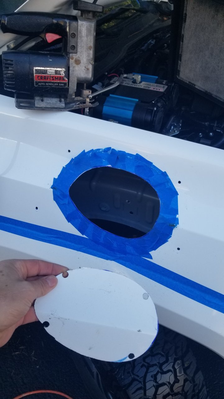

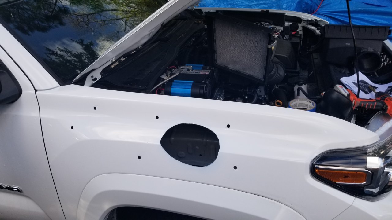

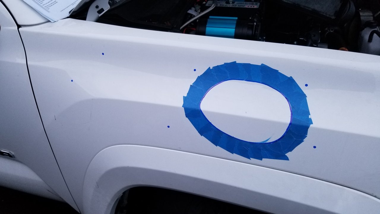

    Here’s one addition I’ve added: An ARB snorkel from Wheelers Off-road in Grants Pass, OR for $500. The install took about 5 hours over a couple of days. The hardest part was the removal of the plastic part that covers the inner wheel well. Cutting the fender on basically brand new truck was quite committing.
    I coated the edge of the big hole with painters tape to protect the finish even though it gets covered by the snorkel body.
    As you can see I used a simple saber/scroll saw. I did hold it a 1/2” off of the body in order to not scratch the paint, it was the easiest step
    Now ready for the fun part; installing the body.

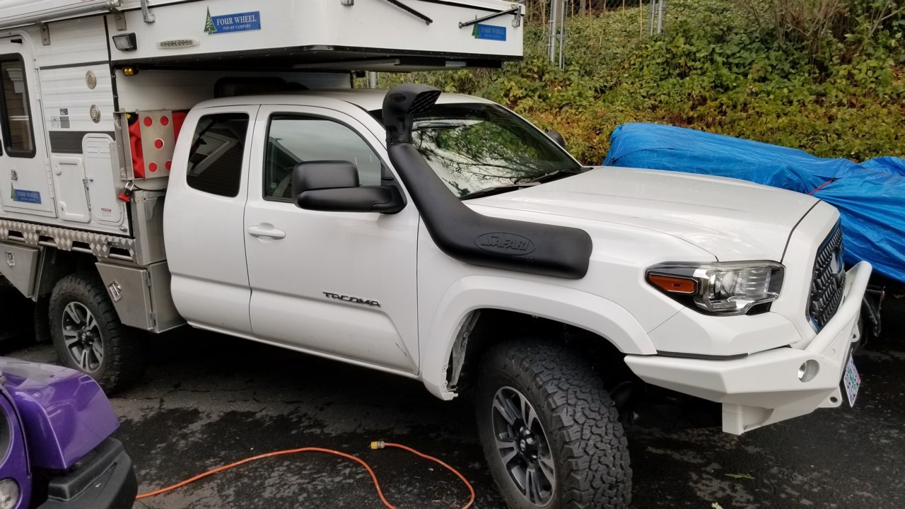

    The finished product. I did elect to install the snorkel on the A pillar using VHB tape instead of drilling holes into the cab. We’ll see how long this holds
    if anyone is thinking of this mod, @Hodakaguy did a great job showing this. BTW, I found that I did not have to remove the mass air sensor from the air cleaner. Here’s a reference https://www.tacomaworld.com/threads/3rd-gen-safari-snorkel-install-how-to-article.543067/

    I have my pillar mount attached with VHB also. About every 10-12 months I have to unbolt it and replace the tape. Other than that it does fine.

    glad to see it works. We’ll be carrying VHB tape in repair kit. Do you find that the air filter stays cleaner longer?

    I do a lot of traveling on limestone gravel roads. Without the snorkel I was putting a filter a month in the truck with it I am good for at least 4-5 months on a filter.
