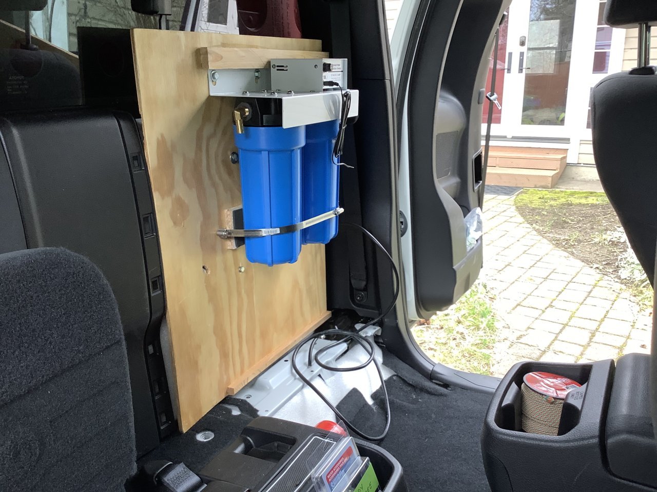

    Continuing to work on the truck. Here’s the water purification system in progress. Need to have the Scheel Mann seats installed first before finalizing the plywood shelf/box.
    you’ll also notice that I’ve removed the jump seat and its floor mount behind the driver.

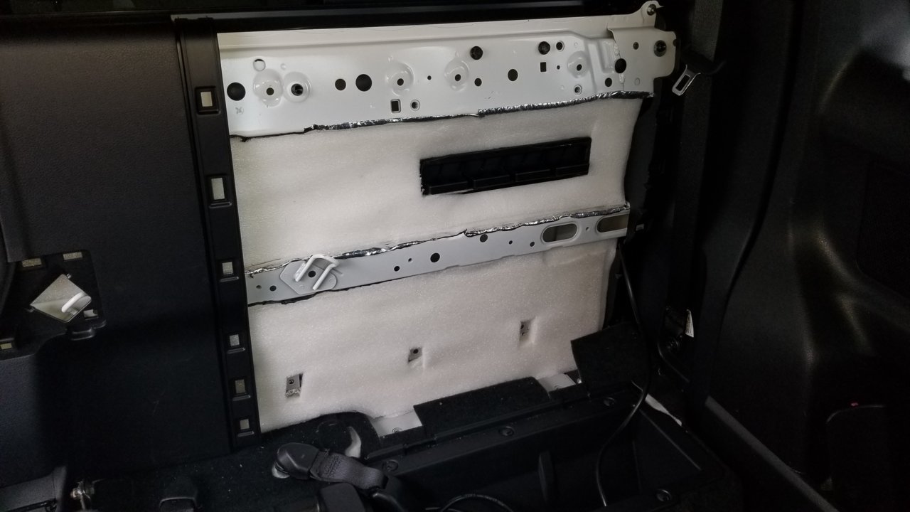

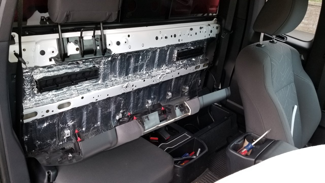

    Kind of going backwards but prior to installing the water system I put Noico 80 mil on the back of the rear wall behind both seats to attempt to reduce some noise. I was impressed at how much noise comes from the back wall without the rear seats and the pitifully thin OEM sound deadner.
    Then I put 1” of plastic insulation and reinstalled the passenger rear seat. One of our kids might want to ride with us for a bit on our trip. I’m hoping that after adding the plywood box surrounding the water system things will quiet down
    Even after this there’s quite a bit of noise coming from the vents in the rear wall. That’s the rectangular black area in the white insulated area. This vent is so you can easily close your door without slamming or popping your ear drums.

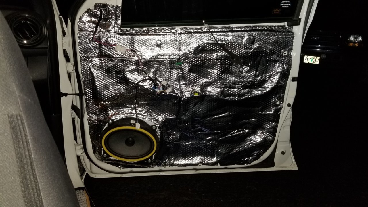

    I also decided to add Noico 80 ml to both front door panels while I was putting on some wider mirrors.

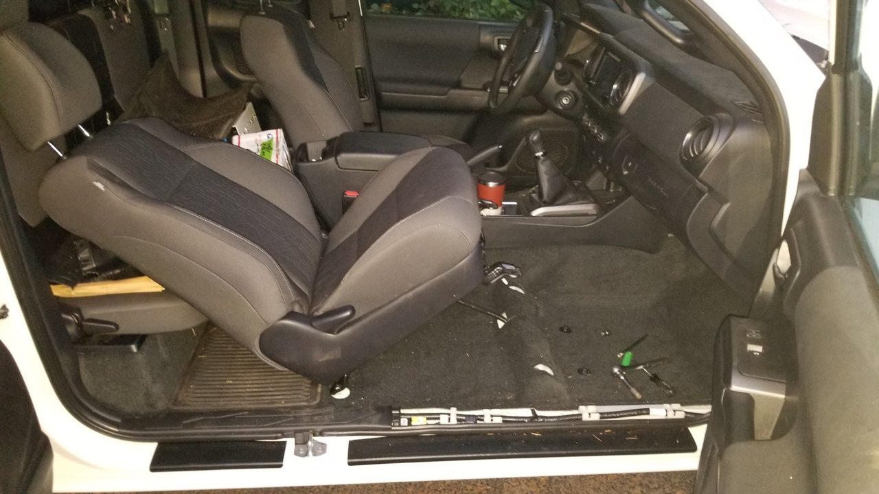

    I also added it the floor as well. Taking out the seats and center console wasn’t too hard as there’s great posts here on TW on how to do it.
    The very unscientific results by my ear are that the truck is now super quiet. Well worth tihe time and weight.
