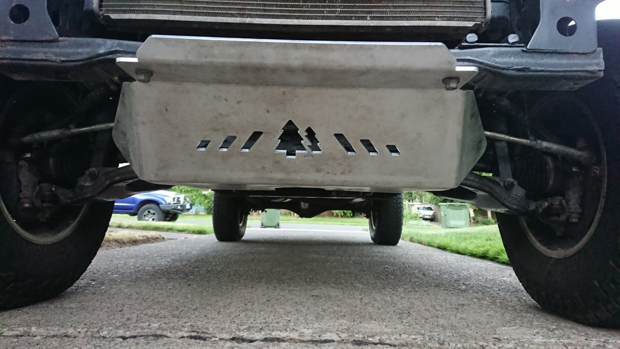

    Skid arrived from Greenlaneoffroad! Thanks for that tip- great unit at amazing price.

    Very nice! It’s a great tradeoff between weight vs protection.

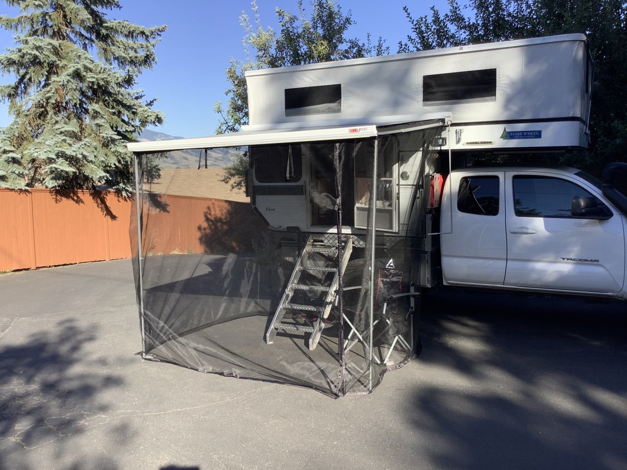

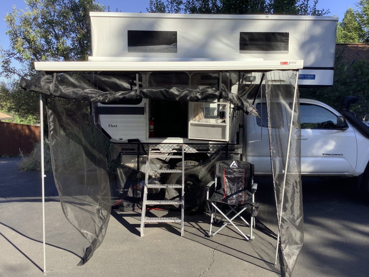

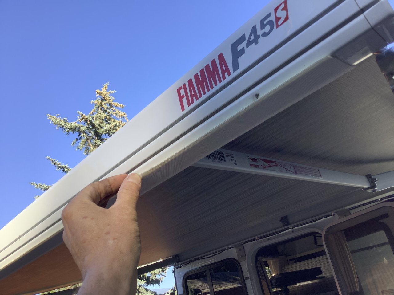

    Finally finished the insect netting that completely surrounds the awning. It’s about 7’ by 8’

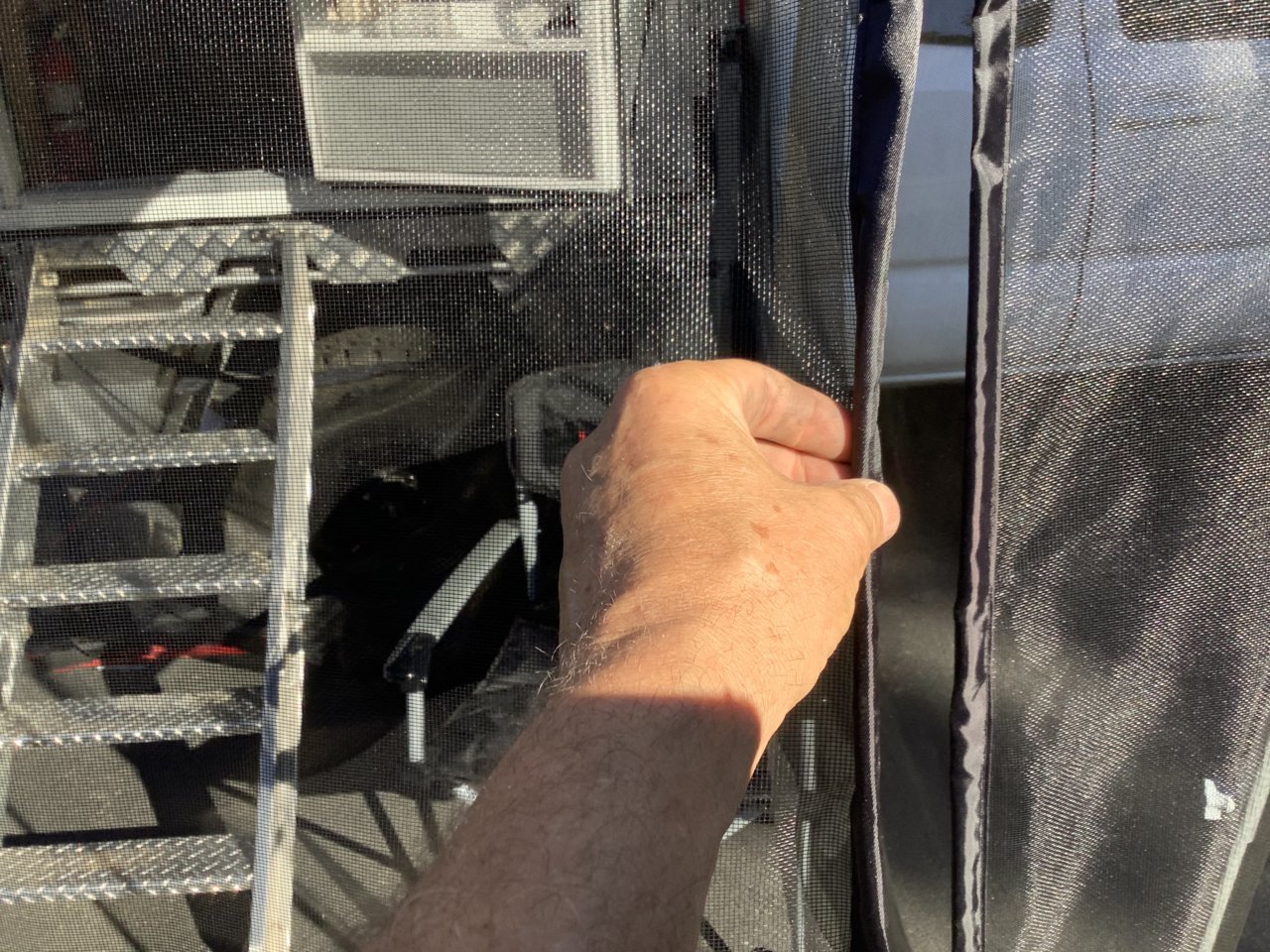

    I made it with two 16’ by 7’ mosquito netting designed for a double car garage. It has two entrances; the one below uses magnets and the other zelcro. Had to sew the Velcro one by hand due to going thru 4 layers of Velcro, only took 7 hours...
    The front rolls up and the back screen under the stairs is attached with magnetics.
    Front is attached with 2” wire Velcro, stays on really well. Even though the bottom has some weights, will use stakes when camping to hold down the bottom.

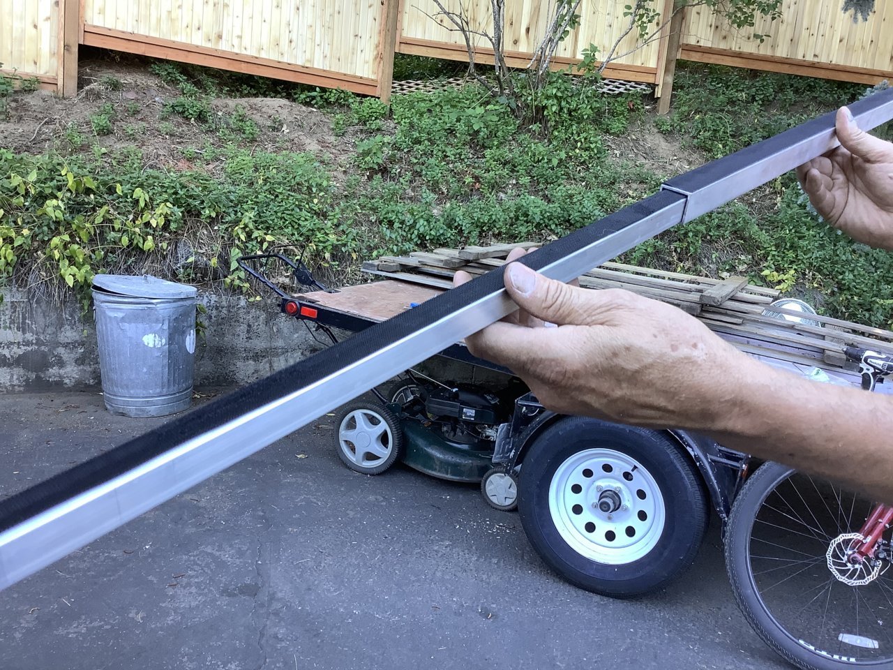

    I used two aluminum square tubes each 4’ long that slides into each other. And put Velcro on two sides.

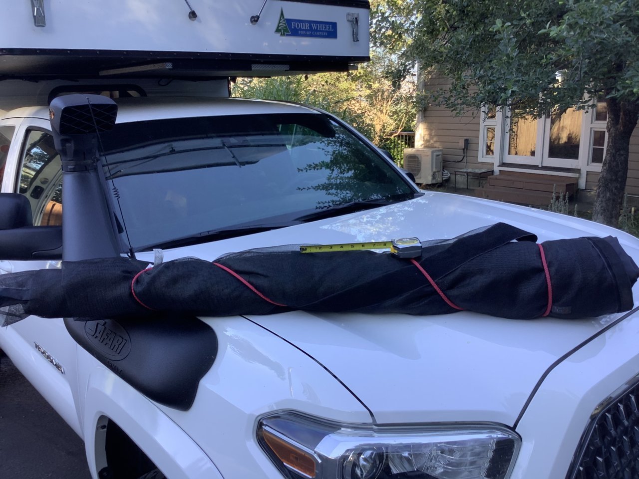

    Rolls up into a 6” by 5’ roll. Thinking of putting it into a 6” plastic pipe and mounting it underneath the camper overhang.
