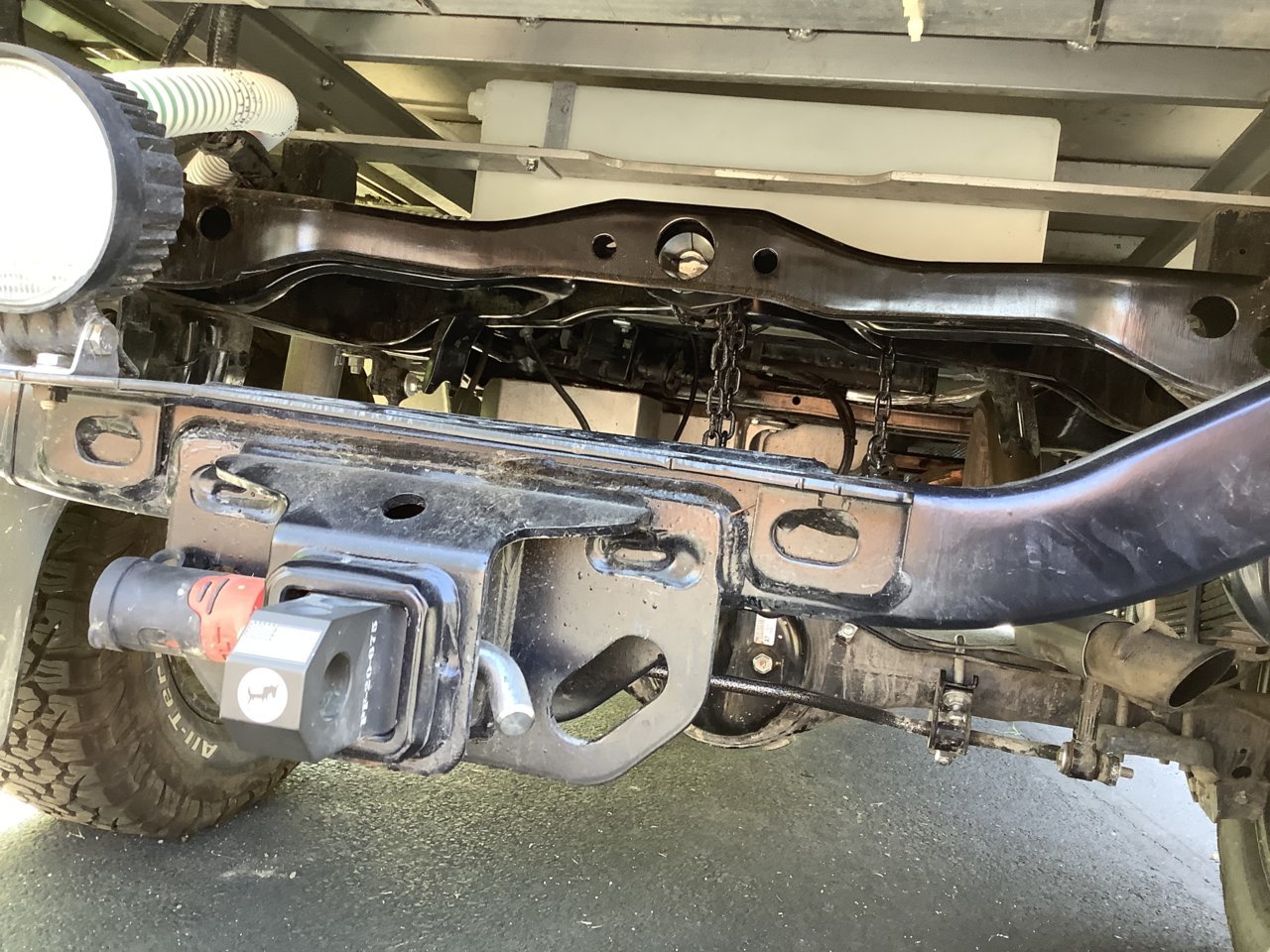

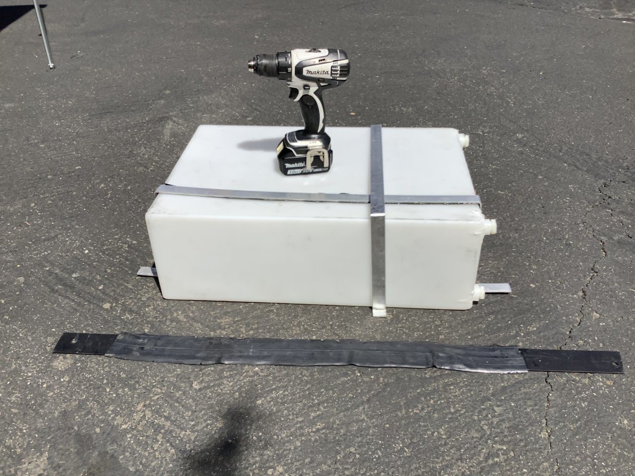

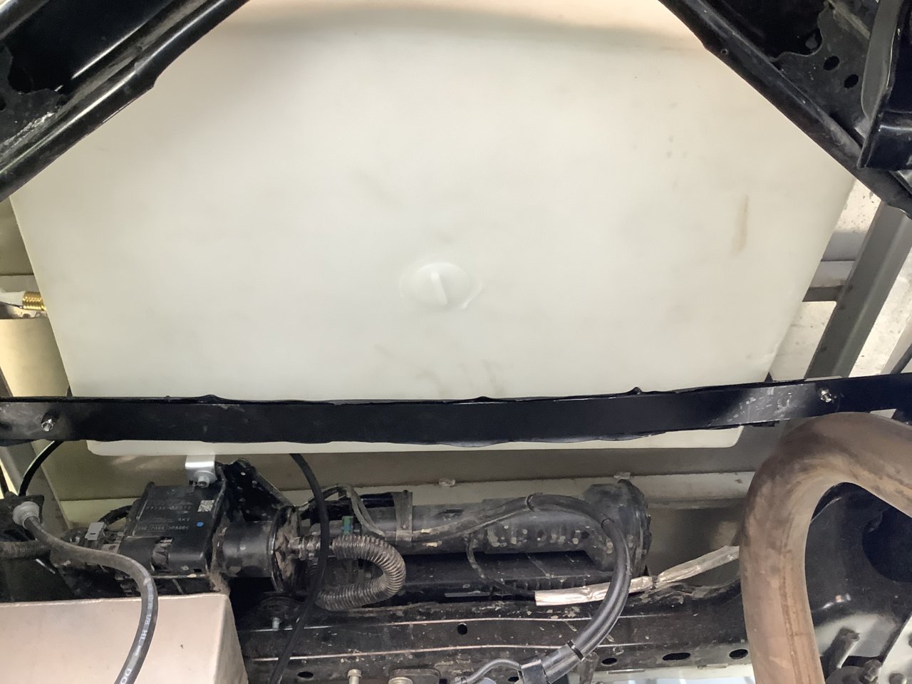

    Finally completed installing a 12 gallon grey water tank immediately behind and above the spare tire holder. I was not planning on having this thinking that out in the boonies of Africa i could just let it drain onto the ground or at least into a bucket. But with the overseas portion of our trip postponed because of the virus we’re now planning on touring the western US because the sale of our house is less than 2 weeks away! US campgrounds highly frown on grey water dumped under campers
    So enter another project!
    I used aluminum bars padded with a bike inner tube bent around the tank and then securely attached them to the truck frame.
    Pretty cool! The sink and shower water now drain thru a couple of garden hoses into the top of tank. When I’m in an appropriate spot another hose attached the bottom allows it to drain.
    I think i may have to modify the exhaust as it comes within a couple of inches of the tank
    Now time to focus fully on tracing the short in the camper electrical system

    Do you have a link to the tank you used or the dimensions? Look like it fits like a glove

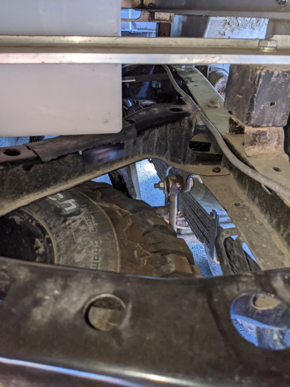

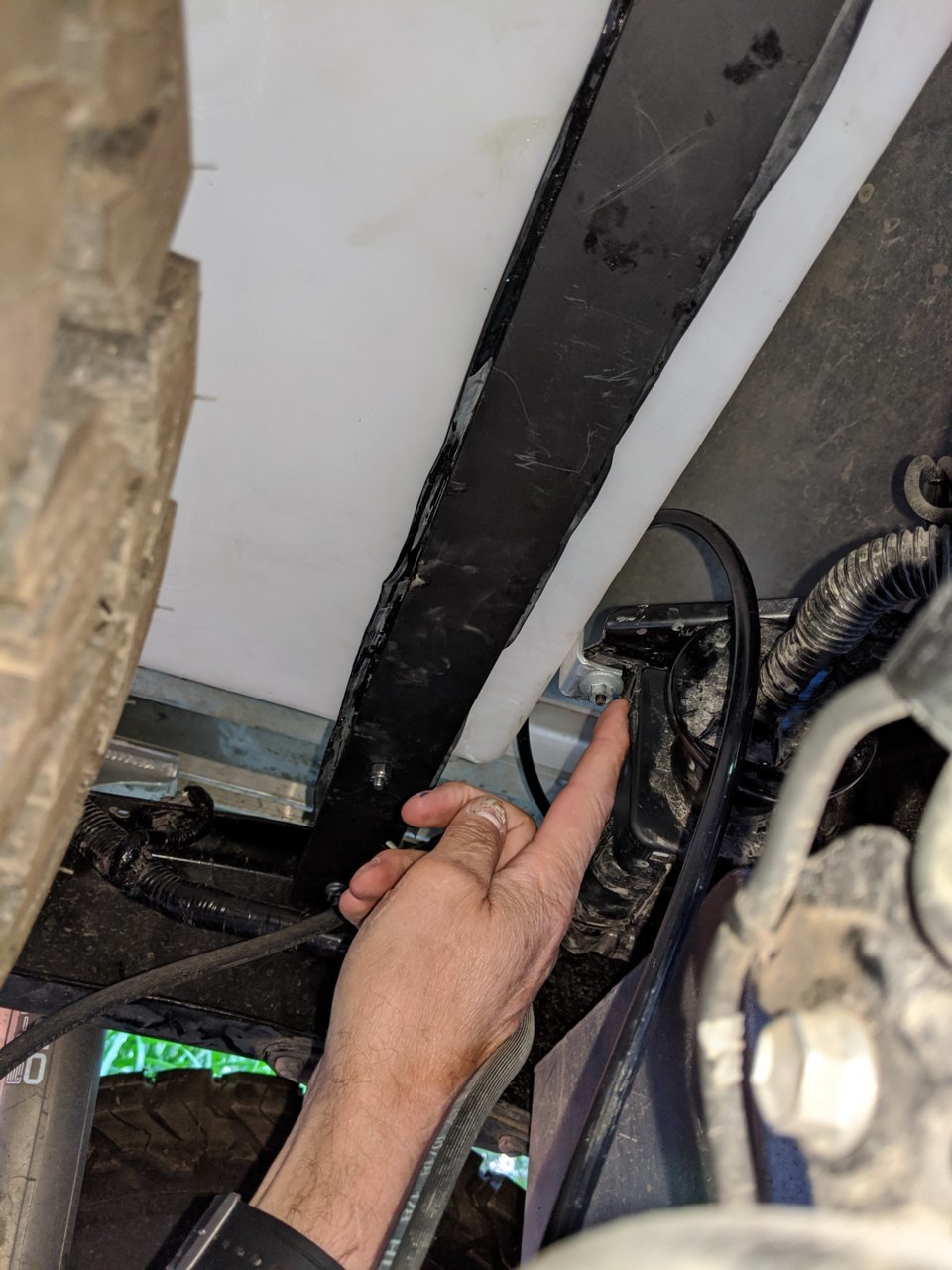

    I just ordered it from a local RV store, no brand on it, sorry. The dimensions are 8” tall, 16” long (between the axles) and 24” wide (across the rear axle). The rear portion of it rests on top of the spare tire mount
    and in the front it just barely fits between this thingy...
    All that being said you would need to have 8” above the front portion of the spare tire mount for this to work. But please realize i have a flatbed which has been lifted about 2”. But you might be able to fix a tank 6” tall; drop your spare tire as it’s way easier to measure
