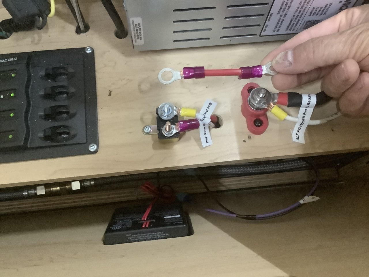

    For about 6 months I’ve noticed that there’s been an unexplained loss of about 30 amps per day which is about 30% of the battery capacity. After 4 months of removing one wire connection at a time this blind robin finally figured it out.
    The builder of this truck and camper had installed this wire jumper between these terminal posts. What he had done was to wire the truck battery which is a normal lead acid battery which normally runs around 13+ volts to the terminal on the left and had the camper battery which is a lithium battery which operates around 14+ volts to the post terminal on the right...and then connected the two terminals with the jumper wire I’m holding. While i was trying to understand the wiring system my son suggested that i install wire labels; super helpful!
    Since the two batteries were in a sense wired together they tried their earnest to equalize their voltage, causing the drain. What i don’t know if it damaged the truck battery as the lithium has it’s own software to protect itself.
    With it removed, everything now works perfectly, just in time as this week we head off with the truck to Corvallis, Bend, and La Grande, OR and then points east!
