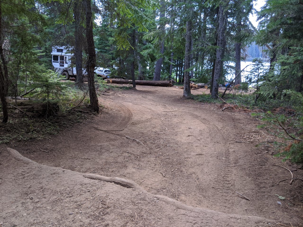

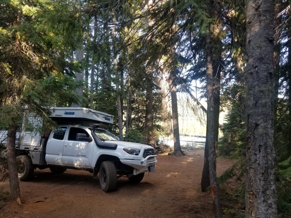

    Well we finally had our first real wild campsite which was located on the shores of Deer Lake which is near the southwest corner of the Three Sisters Wilderness near Bend, Oregon.

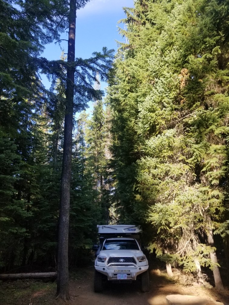

    Since we got a late start setting up out truck we arrived to the extremely busy area of Century Drive. Basically all of the campsites in the nearby roughly 50 campgrounds were all full. So we pushed up very rough roads and lucked out with this spot. The road down was very twisty
    One full-size made it down to us but then had to do a 10-point turn to get back up; Very happy to be driving a Taco!
    Truck is driving fine at 5,000’ in elevation, it’s no speed demon but it handles well on the curves. We’re super happy. The next day we did a great 13 mile gently-sloping loop (Many Lakes trail) hike through the wilderness, we were pooped.

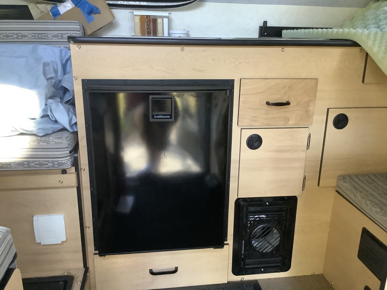

    Our consumption is a Dometic 85 liter frig that pulls about 43 watts. We also have led lighting and cell phone charging. I've noticed that the frig runs alot when the temperature is above 85. We have 320 watts of solar but that doesn't do much when cloudy or under trees.

    That doesn't seem all that different than my 50L CFX. It will pull something like 4A initially and then evens out at 3.6A or so on 12V. Yours probably just runs more from the 60%+ more volume and the freeze side.
    If you have room, throwing a surplus wool blanket or two over the fridge may help. I tend to do that even on fridges with reflective covers. It is surprising to feel how cool it gets under the blanket after an hour or a few.
    Another thing I've done if I'm moving a lot is pre cool a few hours before stopping below my usual target temps, and then set it to nominal when I stop (if I remember lol).

    Good thoughts, thanks. I’ve heard that the electricity consumption doesn’t change a lot due to frig size.
    Unfortunately ours is built into the cabinet. But now I’m wondering what coolness setting its set at.

    I pulled mine out and found space down the sides to fill with more insulation. Pulling it out does mean that you have to re tape the reflectex on the backside.

    I think I reused it. You just have to tape it up again. I think you need to caulk the edges too. To protect from water seeping in. The tape I used was foil.
