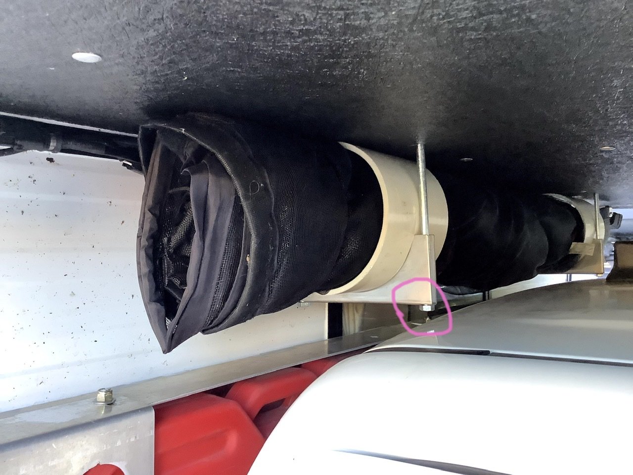

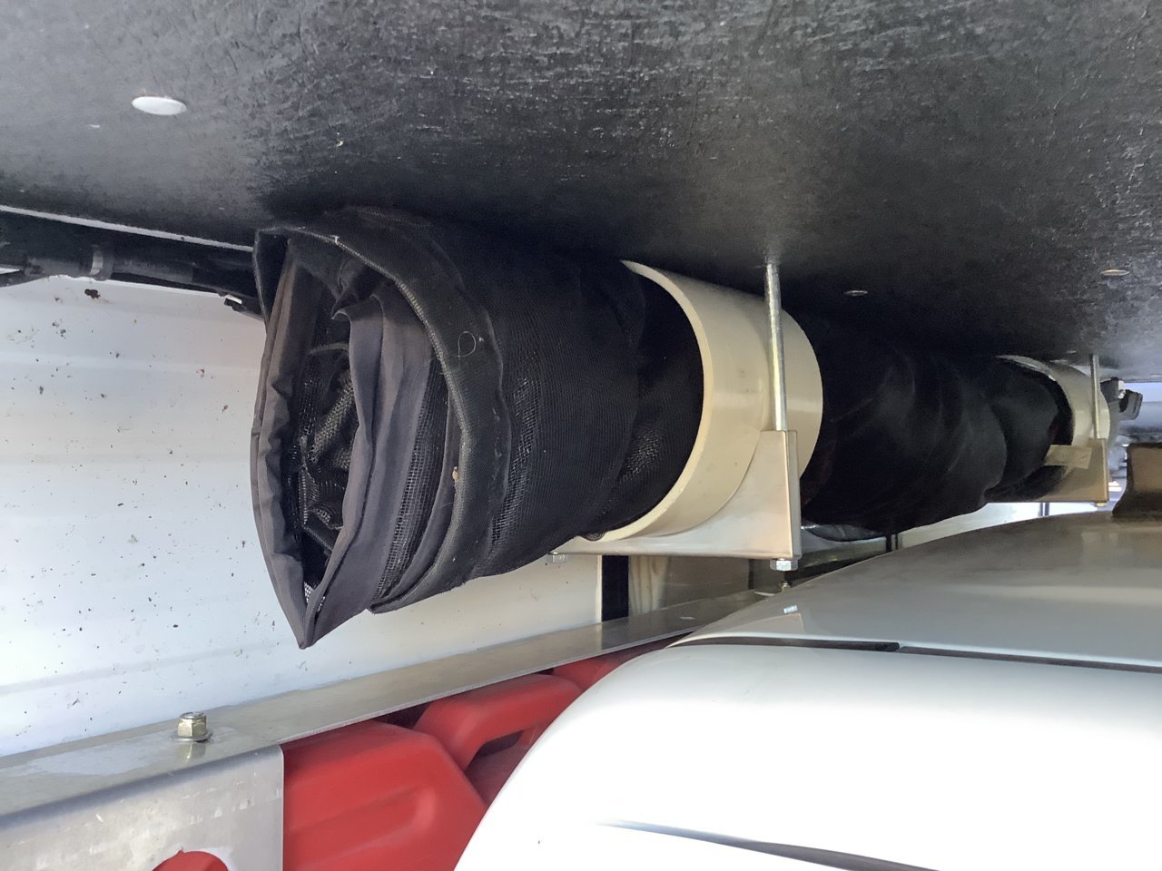

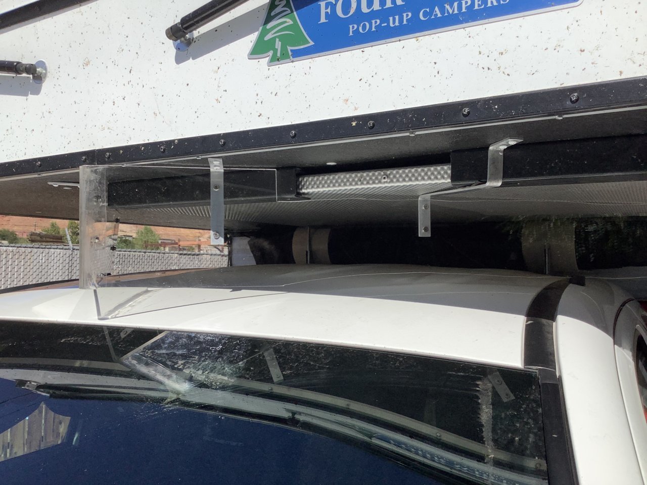

    Hey there. How heavy is that mosquito net? You could put some webbing straps with snaps on the underside of the camper where you have it now and just snap it into place. No worries about the hard mounting hardware.

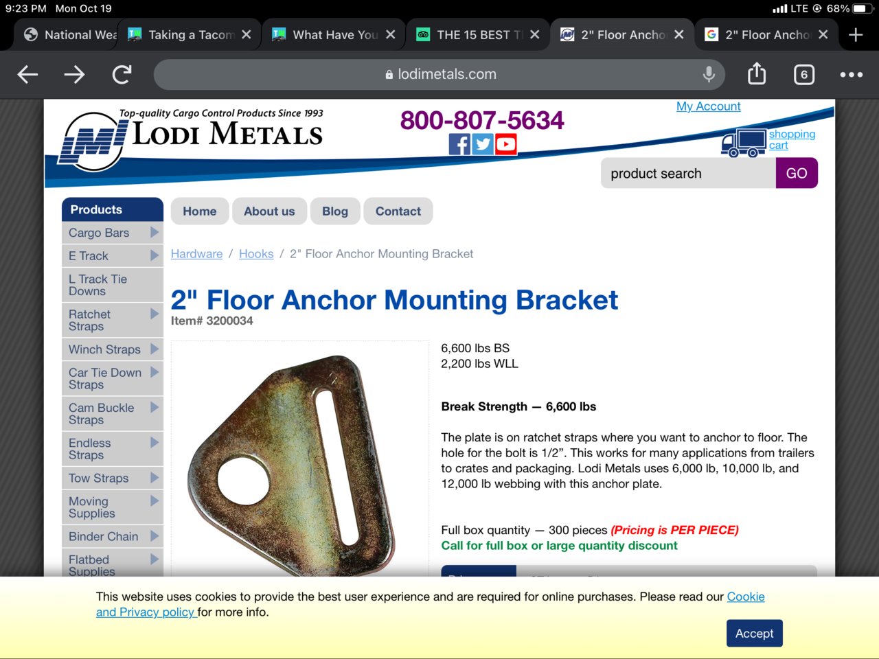

    The mosquito netting weighs approximately 10 pounds because there’s four aluminum bars. The challenge is that the head of the bolt is only 1/2” from the Tacoma roof and slightly hits it when off-roading.
    You have made me think about it more and I think I’ve discovered a simple solution thanks to you!
    So I’m thinking of continuing to use the 6” plastic pipe but remove the metal bracket and mount this to the underside of the overhang with this:
    Then I’ll use 2” Velcro to hold on the plastic pipe and bingo! No more hitting of the roof!
    Thanks @RushT !!!

    Yep, a strap system came to mind too, but I figured you’d be off in the right directions once an alternative was considered.

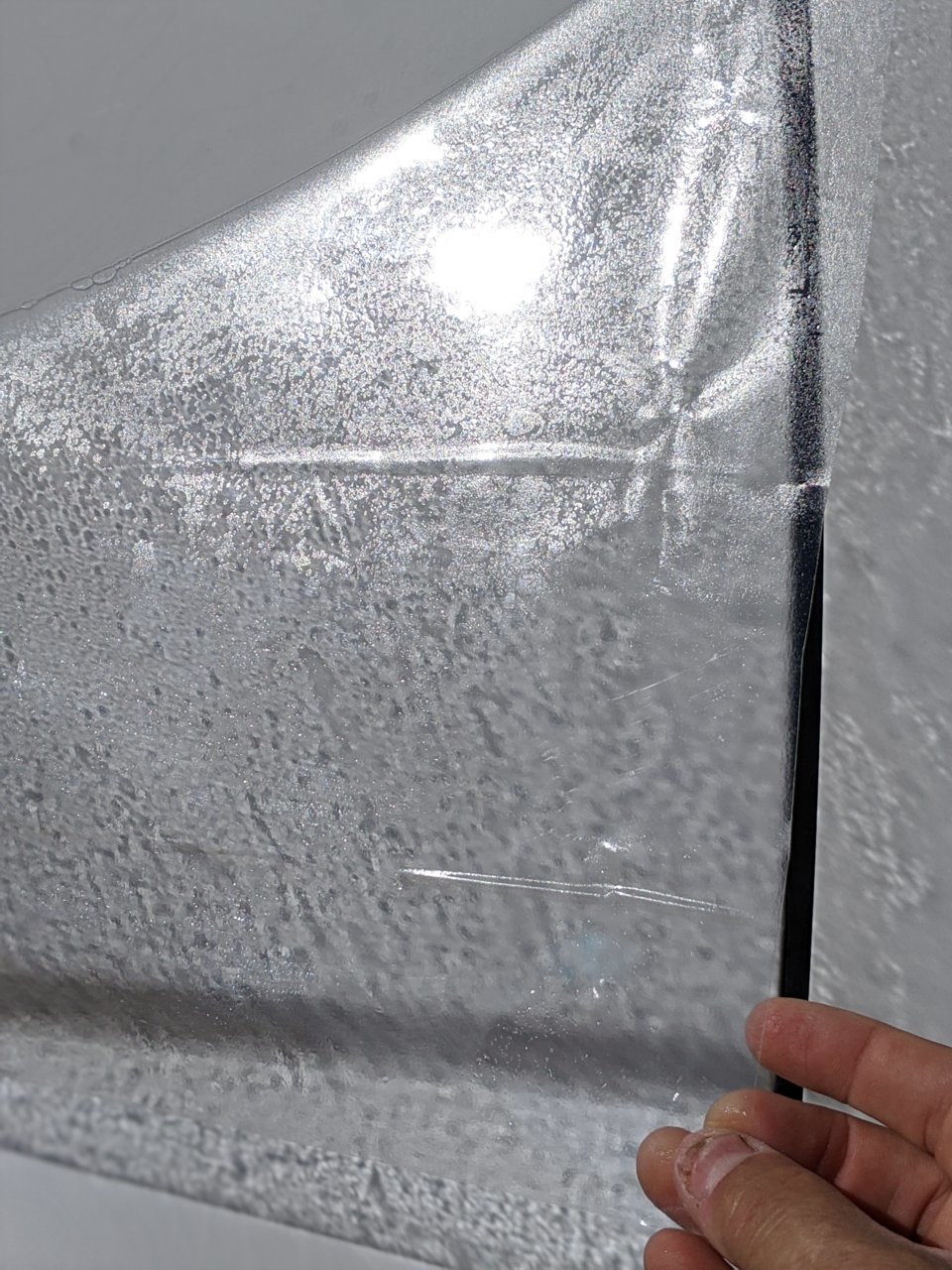

    You can poke a pin hole in the middle of the air bubbles and squeegee out the air. The pin hole will disappear.

    yeah I tried that with success with some of them on my last panel but I’m seems like that has to be done in the first day or so.

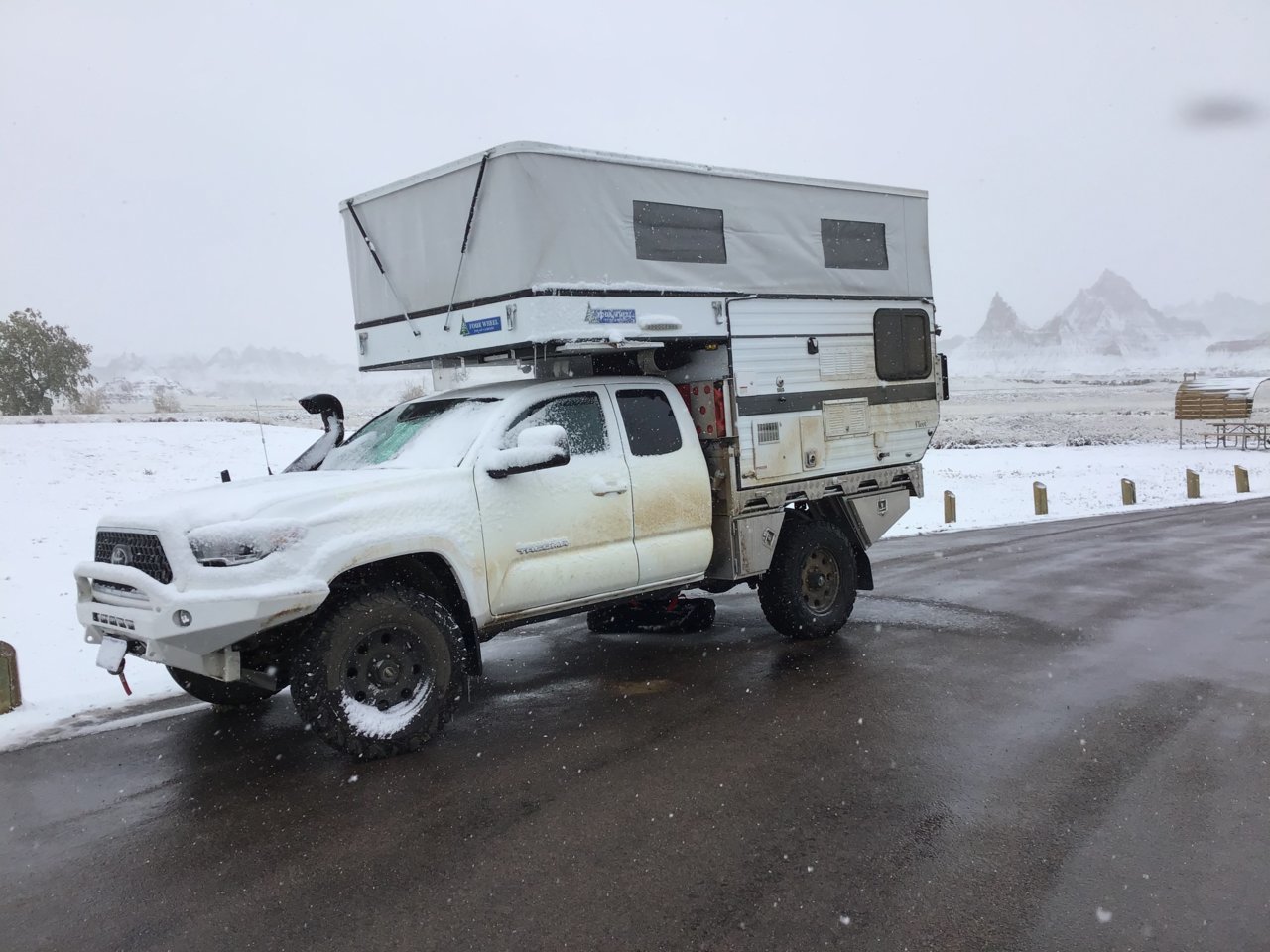

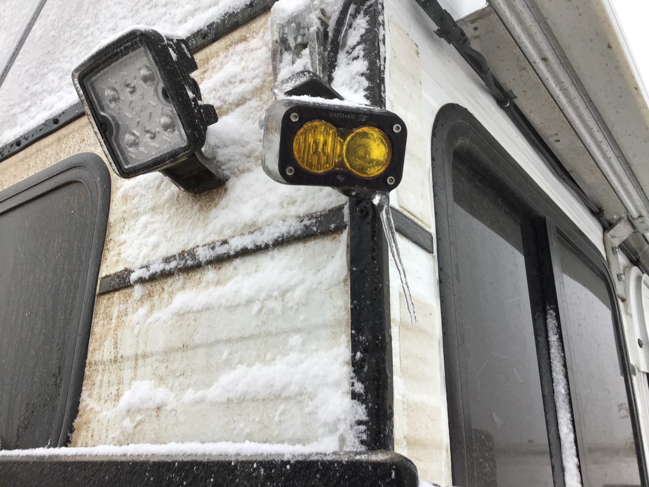

    Weather took a bit of a turn for the worse, freezing rain and wind made some interesting ice formations on the truck
    The Baja Design S2 is frozen over with a crooked icicle!
    Probably not the best day to be exploring the super slippery clay of Badlands National Park
