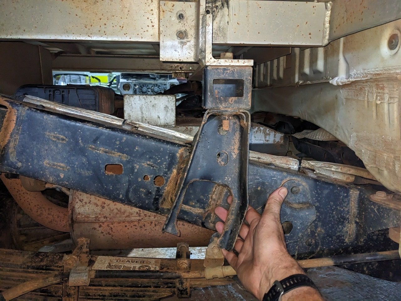

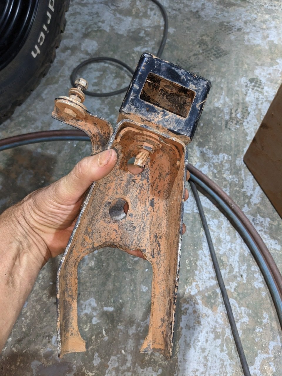

    Here’s the problem, both sides have the front mount completely detached.
    Toyota only welded inside of the “U”.

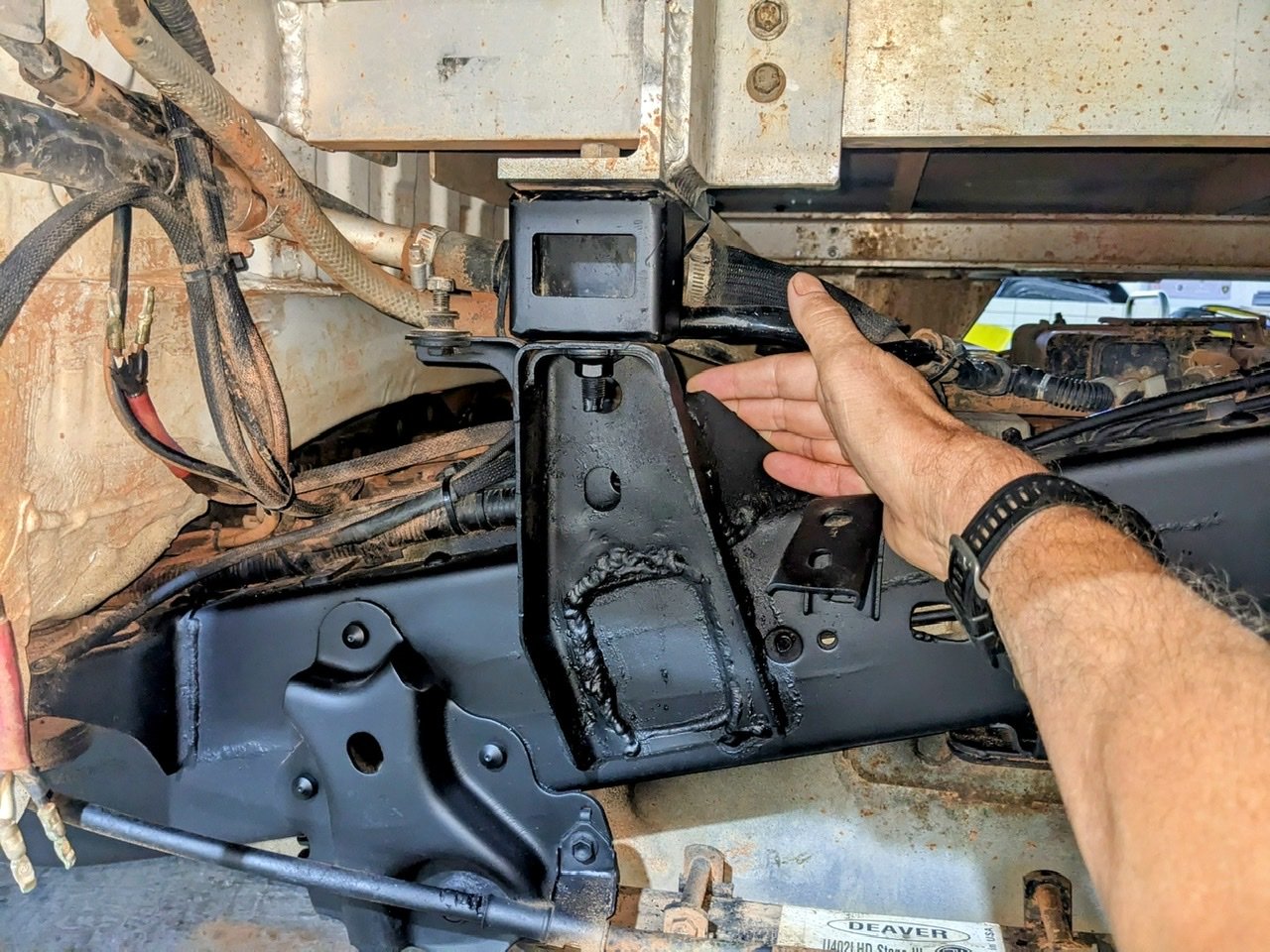

    Finally all happy! Welded on the inside of the U as well as on the outside of the bracket

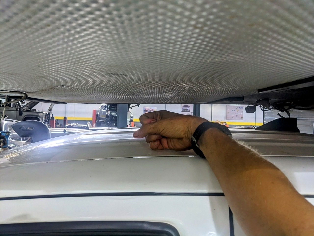

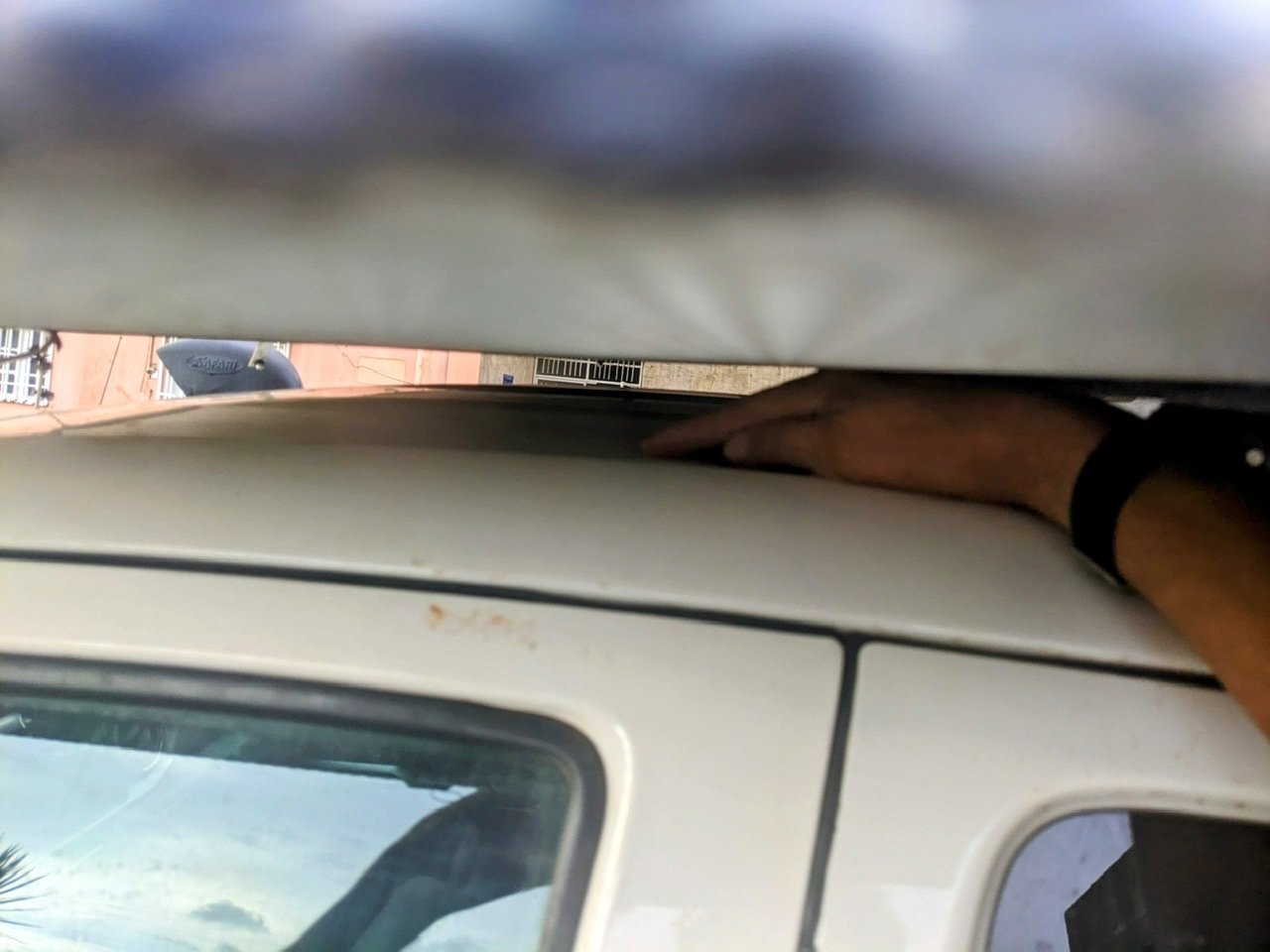

    Before the fix, the camper nearly resting on the truck’s roof
    Happiness is a large gap!

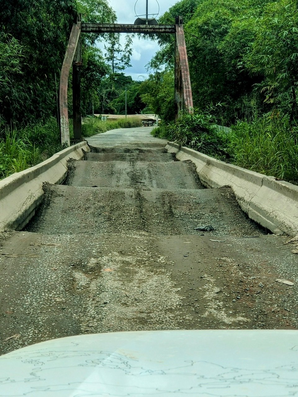

    Some of the roads traversed that day, ridiculous

    I'm Glad Andy got it fixed, but calling it a suboptimal design and attempting to shame Toyota is a bit much tbh.
    First off, that weldment is designed to fail/bend/tear off in the event of a major collision. Keeping the occupants of the inside of the cab alive is the top priority. Having that mount shear/fail/bend increases the unsupported length of the bottom of the bed, making it easier for the sheet to buckle, rather than pushing into the cab of the truck.
    Also, the Tacoma is being used way outside of its intended design. This is a weight that people like Andy and I have to carry ourselves, when we modify our trucks to these lengths. You can't get upset that a hook rated for 5 lbs fails when you try to lift 100 lb. with it.

    nice also do you have carpul tunnel? picture 2,3, and 5 your hand is in a funny position

    I don’t think until now i called it suboptimal, but I think mounting this bracket directly on top of the frame like the others would prevented this. I also think Toyota has enough smart engineers that this could have mounted on top of the frame while also providing for crash safety, but hey I’m not an engineer.
    You’re correct in that I’m running our truck through stresses that Toyota USA probably never planned on but I’m confident that the Hilux had these loads in mind. Every day here in Africa I see cars and pickups loaded far above what they’re rated for.
    This car must have 100 10 liter jugs of gasoline/diesel. But, hey its a Toyota!
    Don’t worry, I’m not dissing or upset with the Tacoma. I either need to shed weight, drive smoother roads, or slow down; I’m choosing the latter.

    Ha! No I don’t, just bending my wrist trying to show my fist as a scale.
