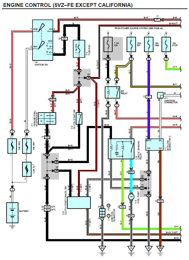

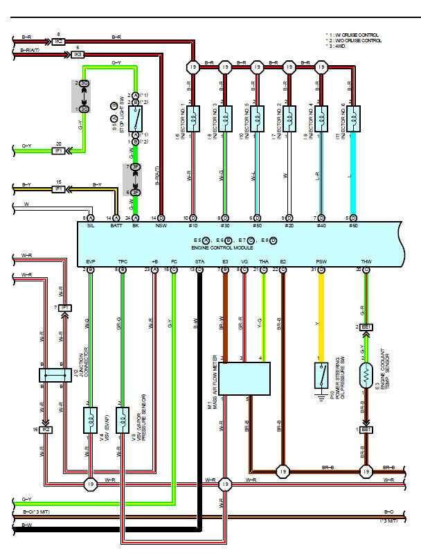

    Just happen to have these handy. It's a 2000 V6 but it's the same as my paper 99. I have the 4cyl diagrams, just not as handy.
    ENGCNT1_zps357dc814_f4b19757e9e6cfe0535c99df85ce5b4d6240e18c.jpgENGCNT1B_zps25486b85_6f4fe30af070f578ba1d70cdbdf598347a4024b9.jpg
