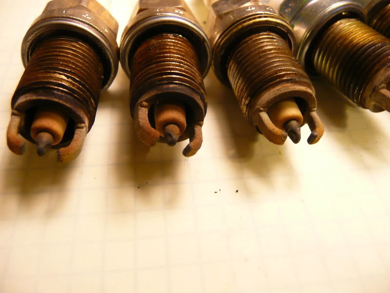

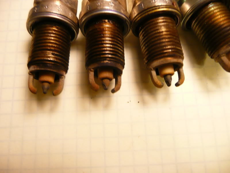

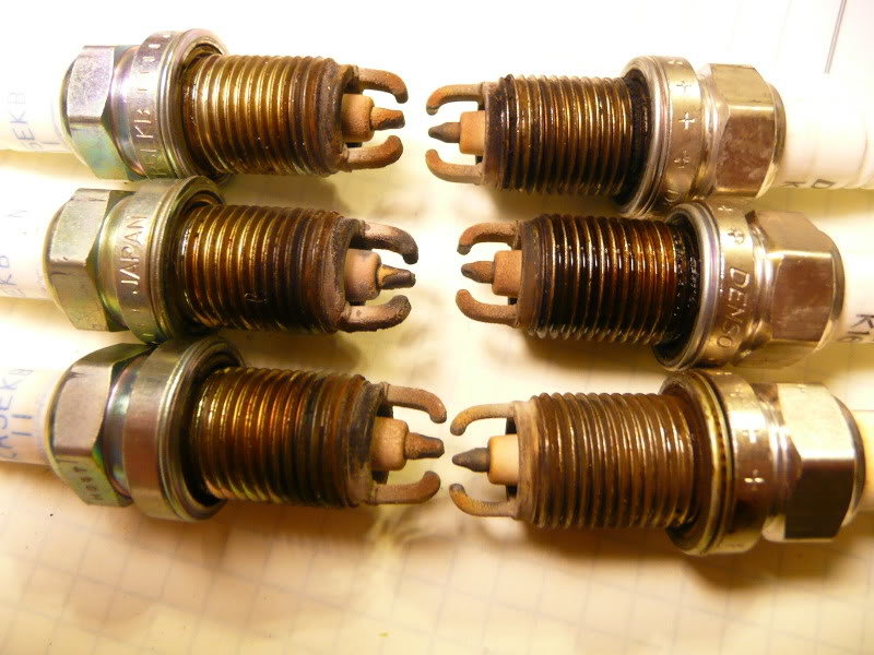

    Hey here's something interesting, I decided to change the spark plugs today and found Denso plugs on the driver side, and NGK on the other side...which I believe that these were the original plugs from the factory. Keep in mind my truck has 161,xxx miles on it. This is what they looked like...
    Pretty bad huh. The Denso's look especially bad. I measured the gap between the electrode and the ground to be about .05 inches on each. Just put in the new factory plugs and it made a dramatic difference in power! Moral of the story: don't do drugs and check your plugs if you haven't already.
