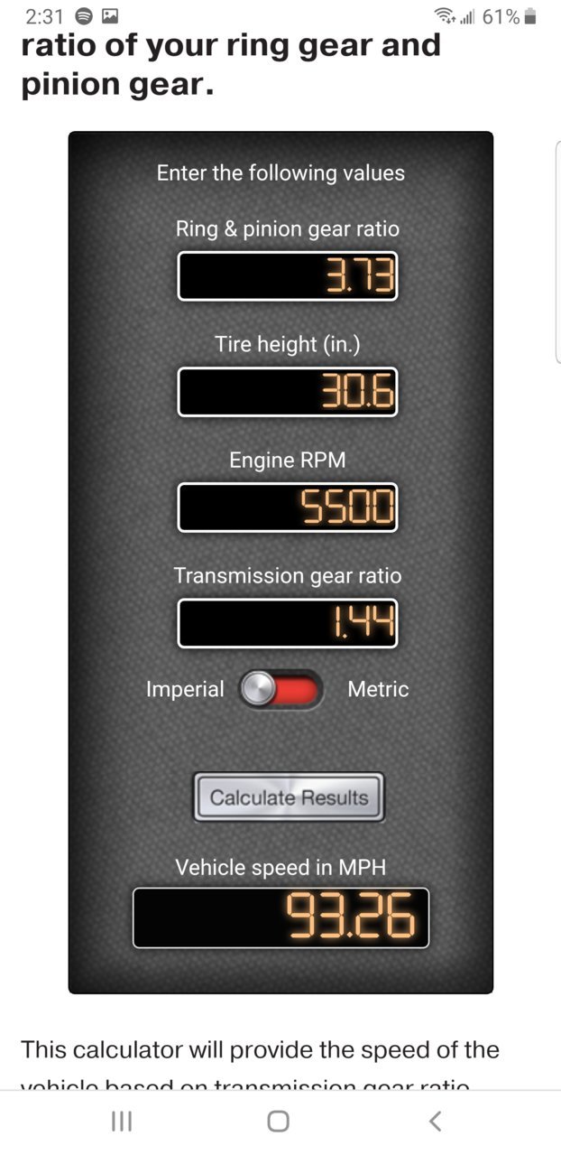

    Could y'all double check this to make all the info is correct? From my knowledge it should be right but I just want to make sure.
    I punched it into a calculator and it looks like 3rd maxes out 93 mph. So you should be fine as long as he did the speeds you said.

    From the looks of it and from my head I think Fosters right and it won't have redlined your truck. If you maintain everything properly, should be no harm. If something does show up, money says it was already a problem. But you're probably just fine, keep doing your maintenance as usual.
